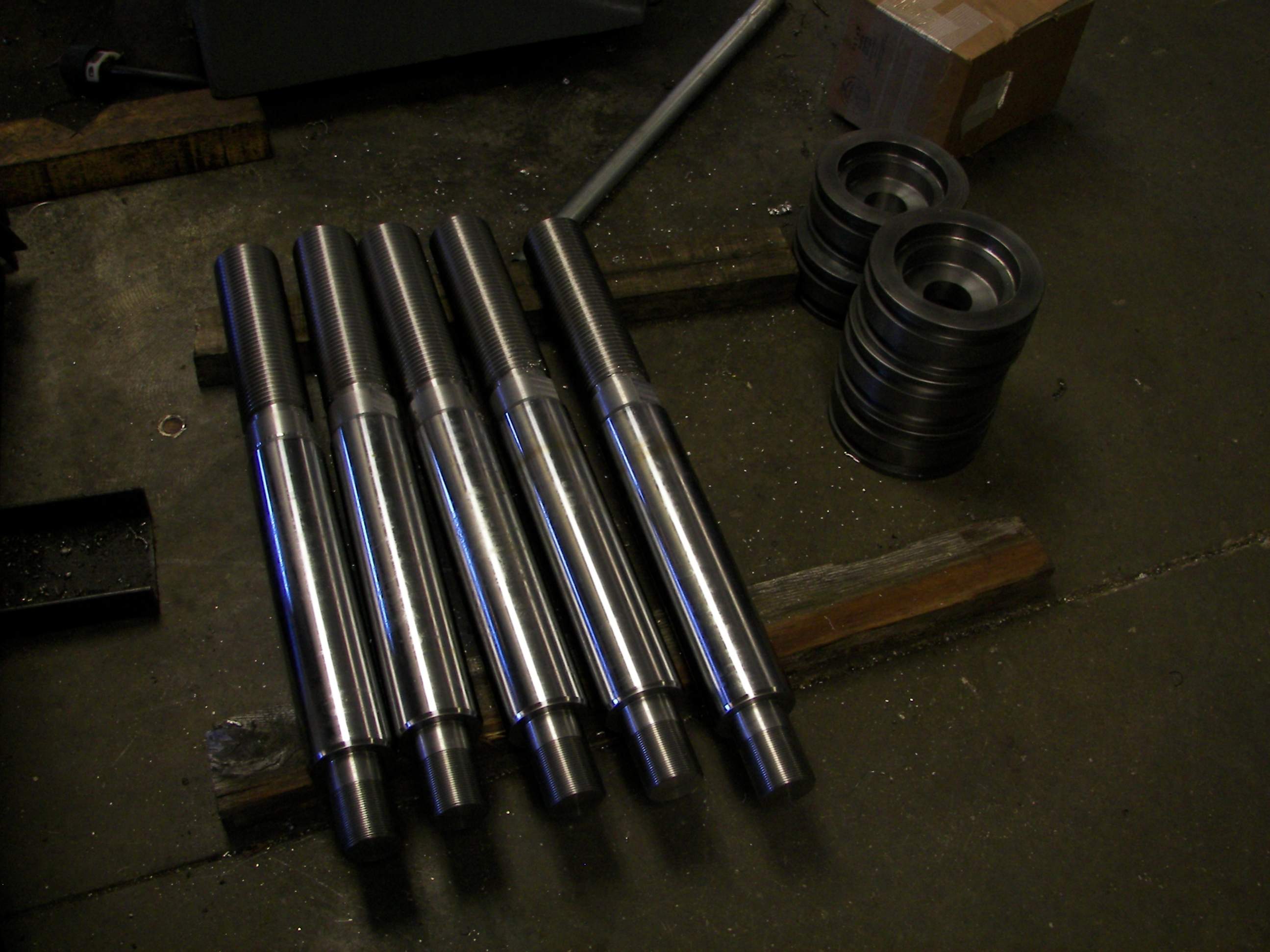

/ Hydraulic Cylinder Problem #34
When they make a new rod, do they chrome it, or how do they keep it from rusting?
The rod material from a hyd shop is purchased prechrome plated in 24 ft lengths, then cut to size and machined/welded and VIOLA..!!!....New Rod.......Kinda Like these.......the lead time to have one piece chromed can be significant, but not this way.....
/ Hydraulic Cylinder Problem #35
Just had to show me up huh?:laughing::laughing::laughing:
