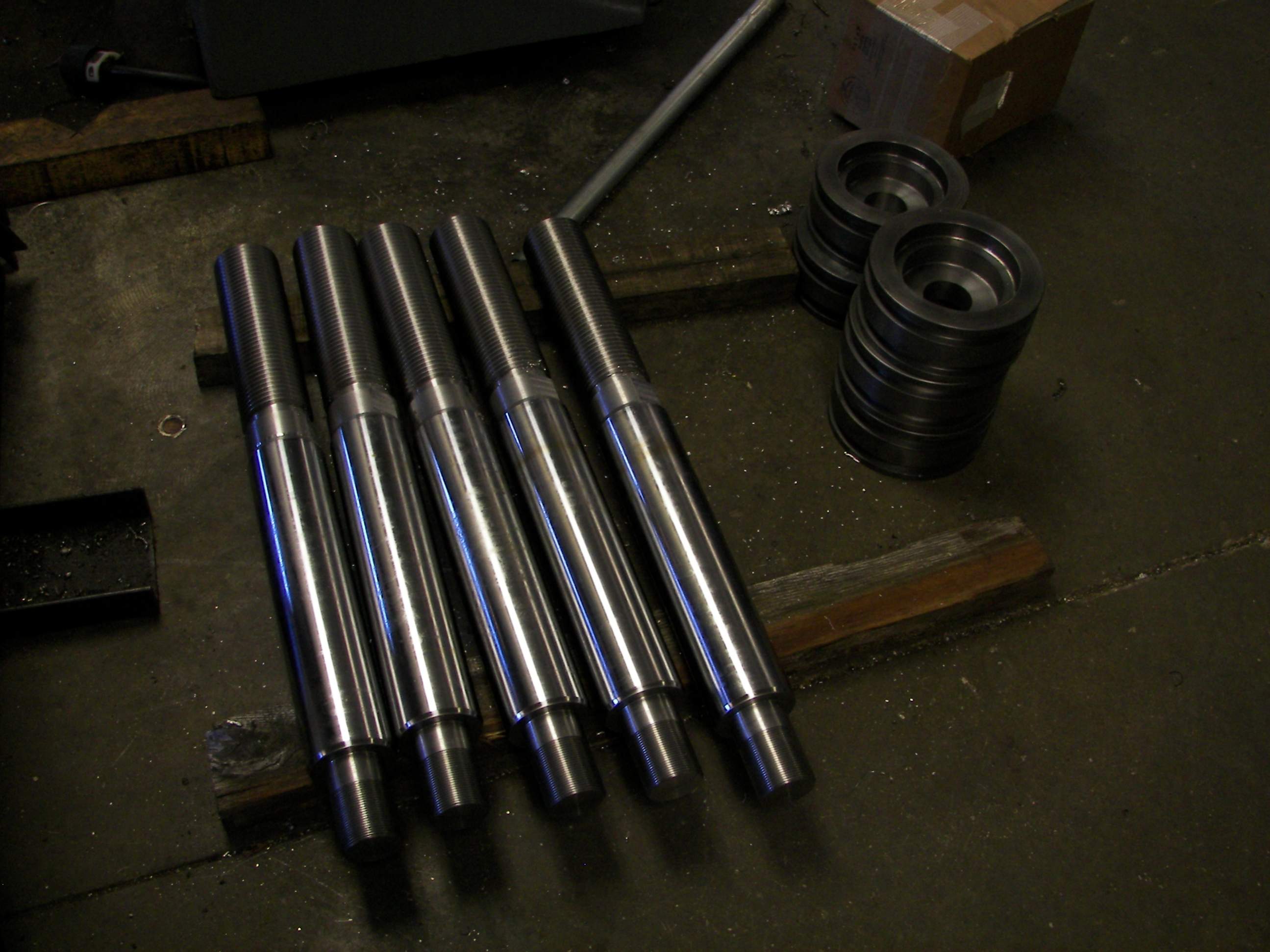

You can definitely get a new rod made up for less than $200. Generally we pay about $90 for a 1" diameter, 16" long piston rod, something a little larger isn't a whole lot more labour just materials.

When they make a new rod, do they chrome it, or how do they keep it from rusting?
   / Hydraulic Cylinder Problem #34
The rod material from a hyd shop is purchased prechrome plated in 24 ft lengths, then cut to size and machined/welded and VIOLA..!!!....New Rod.......Kinda Like these.......the lead time to have one piece chromed can be significant, but not this way.....
Just had to show me up huh?:laughing::laughing::laughing:
