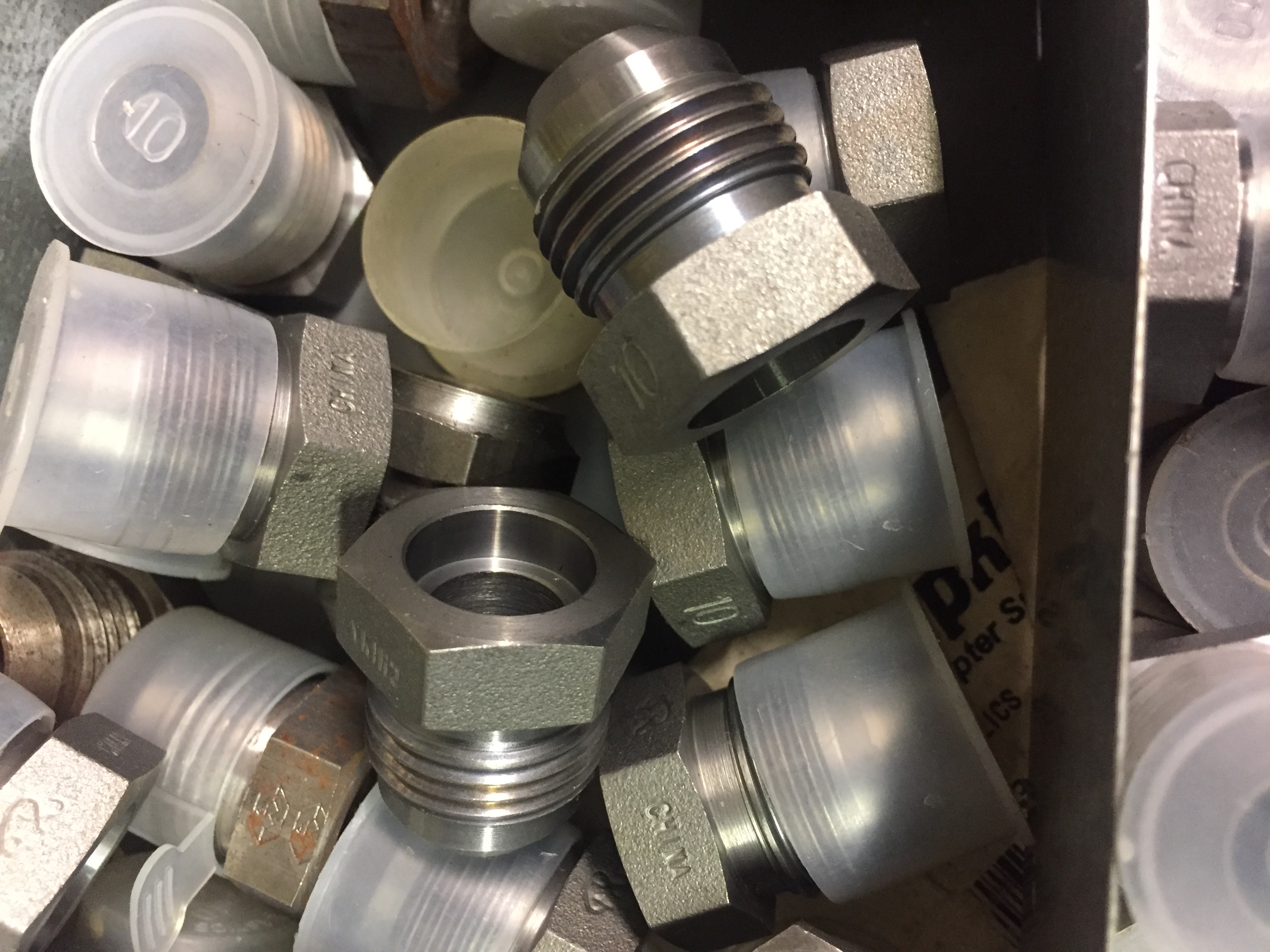

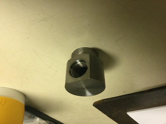

Or take cyl apart, cut off elbow and weld one of these on.
   / Hydraulic Cylinder Repair #22
Ooops, pic upside down......but you get the picture
If I can get by with the hose and compression fittings for now I will go that route. If you were in my town I would drop it off at your shop!
Will let everyone know how it goes.
Thank you everyone for the help
Don
   / Hydraulic Cylinder Repair #24
Another option is to braze on a male JIC tube end and make a new hose to fit.

Its alive.. the feeder tube had a crack on the underside. I cut 1/4" pieces until it seemed solid. No leaks from the repair. I do however have a good leak (drip every 2 seconds) on one of the swing cylinders. I am hoping for now it would be something that could be tightened.
Thank you everyone for your input. Pictures attachedIMG_1532.jpgIMG_1533.jpgIMG_1534.jpg.
