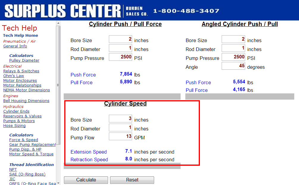

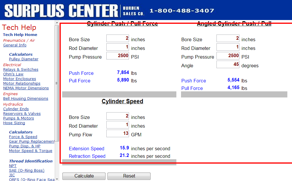

A 2 in cyl with a 16 in stroke will be very fast with a 13 GPM pump.
Like bam. it throws the log at you.
A 3 in cyl will be half as fast.
