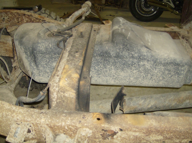

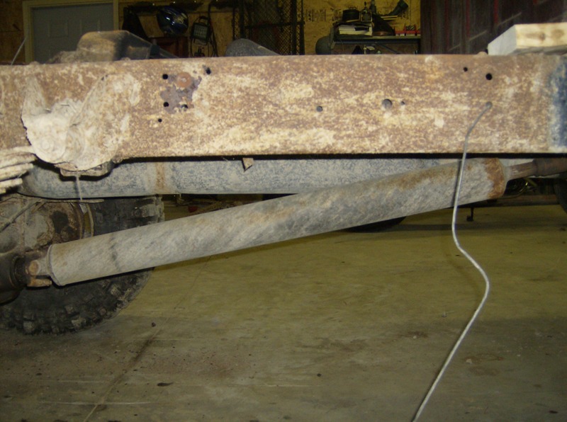

Well I am going to have to change the design a little bit. I got the bed off and there is just no room for a cylinder and crossmember beefy enough between the frame rails. Its got a huge gas tank that would be in the way. So I plan on using two 2.5" x 30 inch cylinders mounted on the outsides of the frame rails.
With the cyl mounted 54" ahead of the rear pivot, 14.5" drop (22.5*) will give me 10,500lbs dump and a 56.8* dump angle.
I have attached some pics. first is the plan. last three are to show the lack of room between framerails

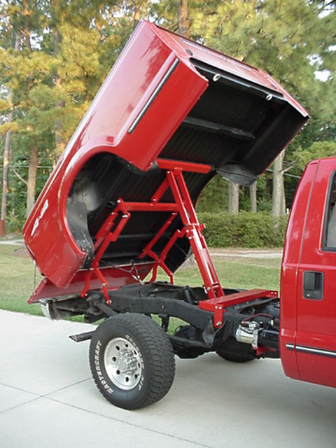

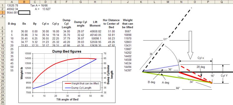

I think in the end the conclusion is correct.
With a pivoting design, moments determine whether the bed will lift or not. Typically, the maximum load on the hydraulic cylinder occurs right at the point when the bed starts to lift off the frame rails. From there it gets easier and easier since the center of gravity moves closer to the pivot (horizontally) and the load will start being reduced (dumped) before too long.
Since the horizontal component of the thrust acts through the hinge of the bed, it contributes nothing to lift. The vertical component causes an anti clockwise moment. The load (not shown in your sketch), causes a clockwise moment.
The magnitude of the lift moment is 28800*sin(28)*3ft = 40 562 ftlb
The weight that can be lifted with the bed horizontal @ 51" from the pivot is 40 562/(51/12) = 9544lb That includes the weight of the bed of course, so the payload will clearly be less.
I did a spreadsheet to calculate the numbers and it looks like the max bed tilt is about 55 degrees and the maximum lift (in the bed) is 14.5k @ 45 degrees. Not that it matters, since you can only lift 9k from level.
