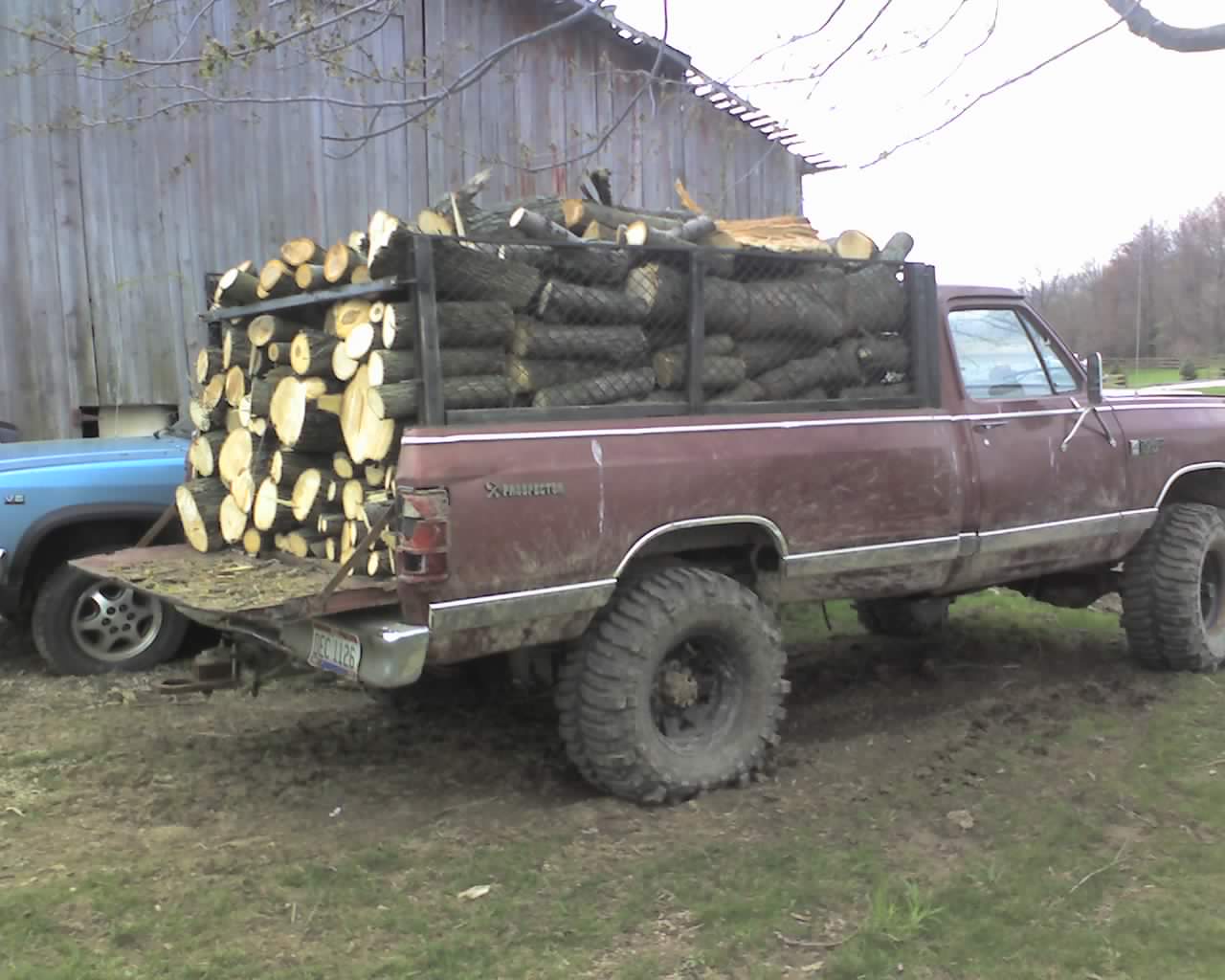

Also the reason fo needing 13xxxlbs vertical force is because I want to be able to dump 8000lbs. Yes I can build everything to handle it no problem. But the cylinder pivot will be 36" forward from the rear pivot on an 8.5' bed. to find the lift @ the midpoint of 51" is lift x 36/51.
13,500 x .705 = 9517lbs @ 3000psi
If I were to drop one size to a 3" cyl I could only dump 7000lbs
The larger cylinder also gives me the opportunity to drop to a 2500psi system and still be able to dump right at 8000lbs.
So it really isnt overkill. This is just a field truck that doesnt see the road and has hauled over 7000lbs many times in the past.
