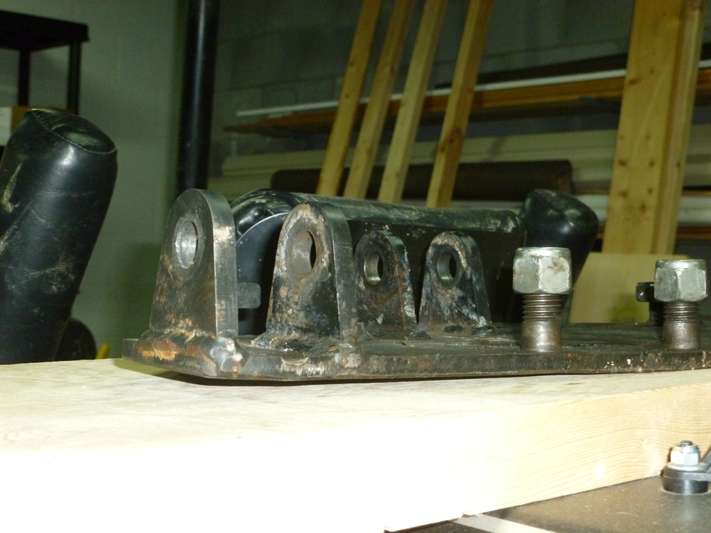

You never did tell me if the QA cyl went into relief, and therefore was exerting the full force on the cyl rod.
The reason I ask is that if your cyl is a 1 in cyl, and 1/2 in rod, at 3000 psi, that cyl should exert a pressure of 2300 lbs in the extend mode, and 1700 lbs in the retract mode.
Does your three spool valve work well in other functions?
It puzzles me that the cyl could not pull or push past the lugs.
The only way I can see that the hyd would not work is that if the mechanical force, as in a bent plate might put enough force of steel on steel to overcome the pull or push of the cyl.
Hi JJ,
I'm still not entirely sure if the QA cyl went into relief. By the time I read your post about how to check this, I had already unbolted the cylinder and was able to see that I then got full travel. Although this might not have been the brightest thing to do, I also whacked on the stuck pegs awfully hard and they just would not budge past a certain point. I'll try to get a good picture of the bent plate, but there sure was a lot of menchanical binding. I have a new plate on the way at which point I'll get everything re-assembled and see if I can hear the relief valve.
Anyway, I haven't had a chance to get the hyd gauge and fittings to check the pressure, but I would like to do that at some point. I assume the three spool valve has something to do with the three degrees of motion? As far as using implements like the grapple and mini-hoe, I have NOT had any issues or problems. Of course, it's possible that the hyd pressure isn't what it should be and I just can't tell.
All in all, I'd be surprised if this was anything other than a case of simple mechanical binding. I really hit those pegs harder than I probably should have without a hint of movement. As soon as I put the clamp on and straightened the plate, they moved quite easily.
Thanks again for all the help. This will probably sound odd, but having the PT break down can be pretty fun...I'm enjoying the learning!

Here are some pictures of the bent plate next to the new one and the QA pins. You can see on the pins where they were bound up. I think you can see from the pics how bent the QA plate is.
Thanks for posting he pics. Did Power-Trac replace free under warranty?
I notice that mine is slightly bent on one side. The two plates can actually move slightly when joined. There is no indication of binding. So I guess I will just wait and see. I now have 70 hours on my PT-425.
   / Hydraulic disconnect is stuck..help! #36
I bent mine while pushing the plate against a tree. I was able to straighten it. Heat it up with a forge or torch and straighten it on an anvil. You can clean up those locking pins and use them again.

I bought my PT in 2008. I didn't even ask about warranty...assumed it was out. The plate was $180 plus about $13 shipping. I forget what they wanted for the pins, but it was in the neighborhood of $25 or $30 each, so I decided I would grind the burrs off the old ones.

So what do you think caused it to bend?
You know, I'm still not entirely sure. I think it may be related to the box blade I bought.
I bought a nice heavy-duty 3pt hitch box blade. Not sure how heavy it is, but it takes all my strength to slide it, let alone pick it up. I had a 3 pt hitch adapter made. The blade has been used very little, but maybe the pulling action caused the bend. The PT seems to have little trouble lifting it, but given the adapter and then the box blade, there sure is quite a bit of weight hanging way out there. If the box got torqued such that the PT arms sort of twisted a little, I could see the plate getting bent this way.
The other possibility is that I did lend the machine and minihoe to a friend. I'm relatively certain that I've never not gotten the pins seated correctly before use, but perhaps my friend didn't. Someone earlier in this thread mentioned this caused a bend.
I do seem to remember having a little trouble getting the pins to drop when I switched to the mower deck, but nothing too bad. I find it hard to believe I could have bent it with the mower on.
