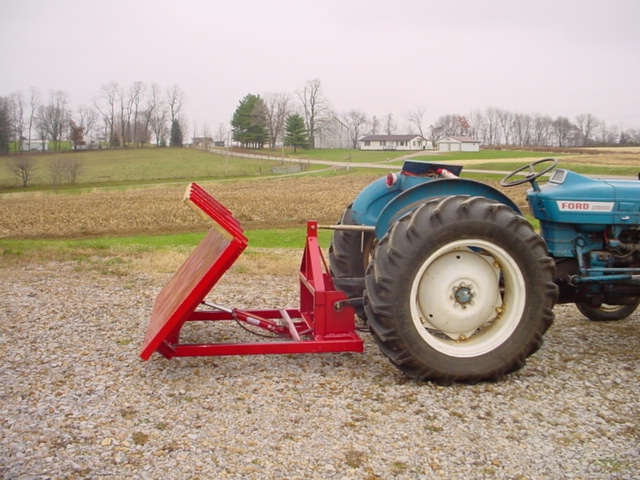

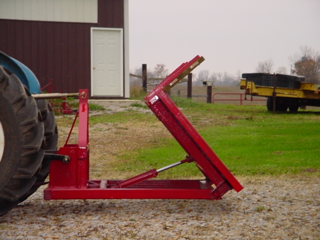

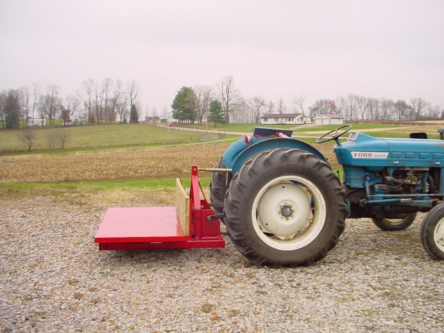

Here are a few pics of my dump carry all I built back in '02. Seems there is always some thing that needs cleaned up, hauled, etc. Don't mind loading stuff but sure hate to unload it..., LOL...
Nice for rocks that go in a wash, or brush to be carried to a place ot burn.
Guess I coipied the main frame from a HD bale carrier I bought. Then just doubled it, and used 3" channel for hinges, bored with a 1" hole, and 1" hinge rod.
I used a 2" cylinder, but a 3" would be better. I can pile enough dirt on there, that is about all the "Henry" wants :).., and all I care to shovel on at one time, without taking a break...
The hydraulic top link helps give a little more height, when lifting to dump.
I'm thinking back then I had around $150.00 in it. We have a scrap yard that took in cut off items, and you could buy for a few peinines over scrap cost. Wish they still did..!!

Very nice, looks like a factory built,
I was gonna say you need sides but like you say you can only lift so much before the front end will stand up.
What about a set of wheels underneath for the heavy loads, so the weight would be on the wheels not all on the tractor?

Yep, reckon you could, but Henry will carry al I want to shovel at one time... Then it's time to take a ride, and dump.... LOL...

The deck is 3' X 6'. Wanted it big enough to carry square bales if needed.. Sure was handy when tearing out old fence..., at least carrying the old posts to the burn pile.. Loaded them with the fork bucket on the Bobcat, tipped it forward a bit, so as not to loose them.. Back up to the pile and dump, and go get another load.
Sides and a small detachable tailgate would be sweet, if you did lots of bulk mulch work I guess... The applications for it are probably endless, and if a person built their own, could modify to suit their needs. I know I use it a lot..!!

I'm thinking put a solid headboard, and stake pockets for the sides. That way you could remove the sides to haul long items like your fence posts, and set them back on to haul bulk items.
The tailgate could swing from the top of the sides, with a trip lever operated from the seat, for dumping.

As I mentioned in the beginning..., a 3" cylinder would lift it much easier... After building it, and watchng it dump, I questioned whether it would lift easier reversing the cylinder, and pushing up from the front..., and anchoring to the bottom rear. Just seems there would be more leverage that way. As it is, like my dumptruck, you're lifting 3/4 of the way back under the load, and multiplying the force needed to lift... Although you may need a longer cylinder to acquire the amount of lift you desire...It has dumped everything I've ever piled on it, although a couple times I've had to throttle "Henry" up to do that. But that was wet/muddy dirt, and it was loaded to the gills... A little R&D to see if it would take the load, and test my welds, and weak points..., LOL... No breakage as of yet...
