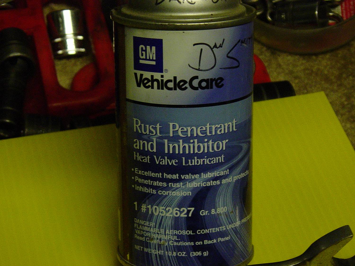

The penetrant RPK was thinking about is PB Blaster. It's ok stuff. The BEST stuff is sold at GM dealerships. I forget the exact name, but it's something like "heat pipe lubricant". Mechanics that are on the clock for pay, use it as they don't have to wait around for it to work. It's like 8-9 bucks a spray bottle, but worth it.
{ok, I HATE giving incomplete information. follow the link for the stuff.
]Merchant Automotive :: Your Duramax Diesel and Allison Transmission Experts!

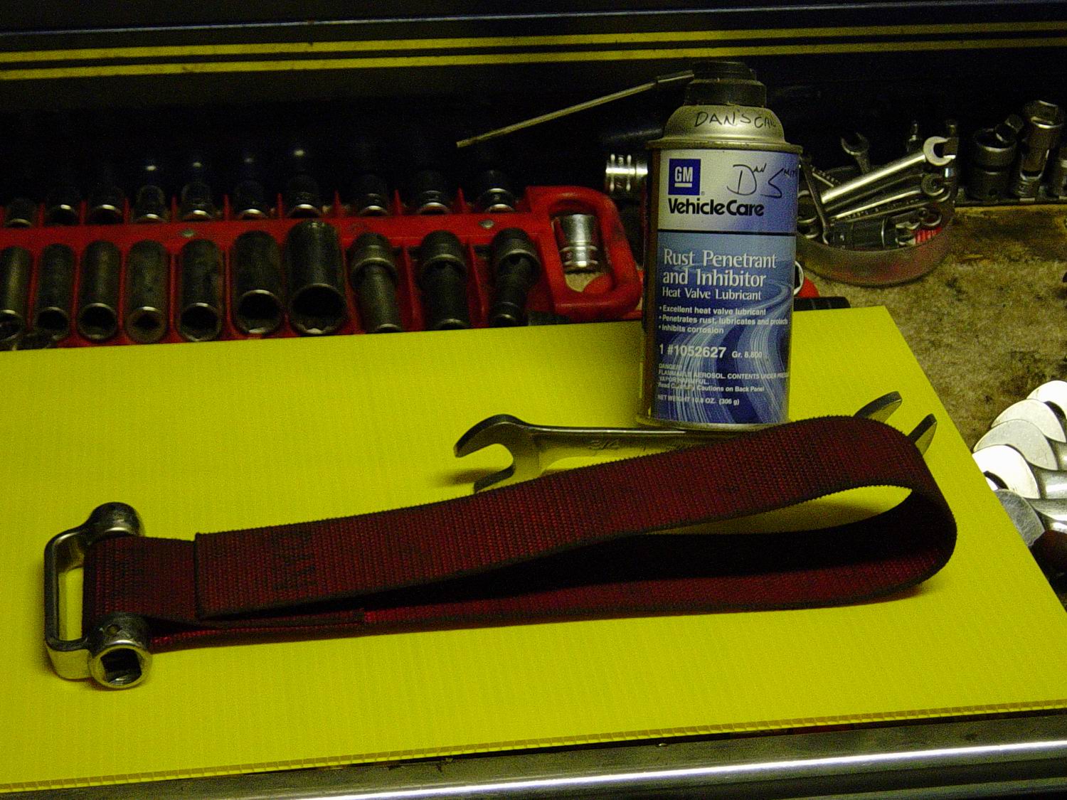

as a mechanic myself i always buy new to, i see what people due to used stuff everyday but i also take very perticular care of my own stuff !!
i have seen what happens when people overtighten a fuel filter on a d-max engine, cracked filter base a mere 650.00 and its fixed plus labor of corse. this is also a alum. filter base. so you need to get as close to the base as possible to remove this filter, i start with filter plyers and then go to the strap wrench then to the air hammer,lol
here is a couple pics one of the penitrate that john bud is talking about and the other of a strap wrench
