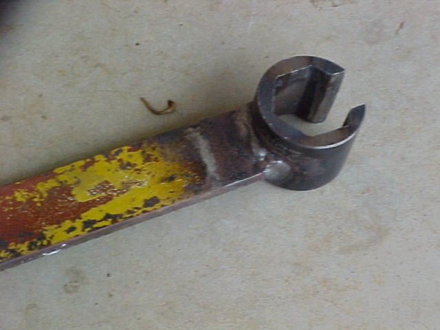

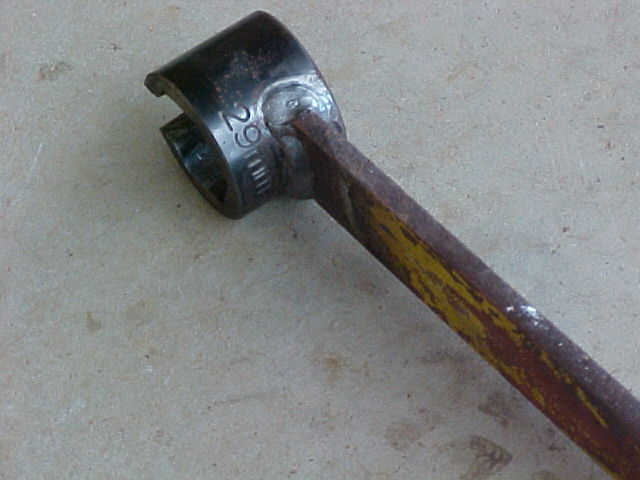

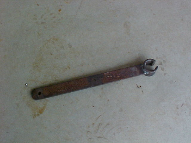

   / Hydraulic Fitting Wrenches - Need Suggestions #14
Heres a crowsfoot wrench I made recently when replacing a hose on the valvebank of my backhoe.
Couldn't find any crowsfoot that big (29mm) so I ruined an impact socket to make one - worked beautifully.
   / Hydraulic Fitting Wrenches - Need Suggestions #15
Allenr, that's awesome. Looks like something I'd find in my box. :)
