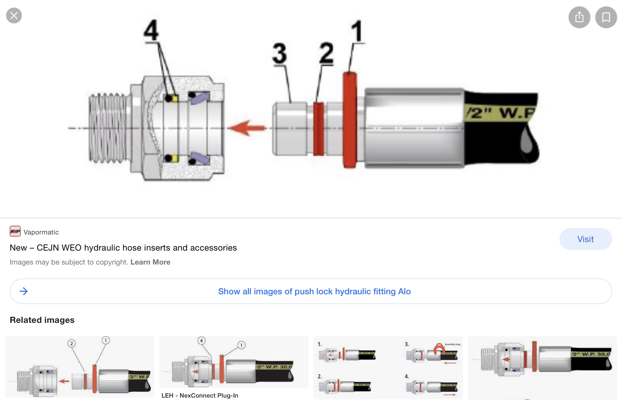

anyone here ever seen a push fit (almost like a shark bite) hydraulic fitting ?

No, it's not a compression fitting. It's a male fitting on the hydraulic hose, and it pushes into the hydraulic diverter valve and locks in place.
There are little metal clips inside the female connection on the valve, that actually grab, or lock onto the male fitting (on the hose) to keep it connected inside the hydraulic diverter valve.
You just push the male fitting on the hyd hose into the hyd valve and it locks into place

If you talking about a regular air line fitting where you must pull the outer part back on the female coupling to disconnect the male fitting ? That's not the case with this type hydraulic fitting.
The male just pushes into the female and fingers grab it and holds it in place. Much like a shark bite fitting for plumbing.
To disconnect it. You must remove the safety ring, push the male into the female, then pull the male end (which is attached to the hyd hose) out.
That's how you remove a damaged hose from the valve.
The other end of the hyd hose is connected in the normal way using a JIC type fitting

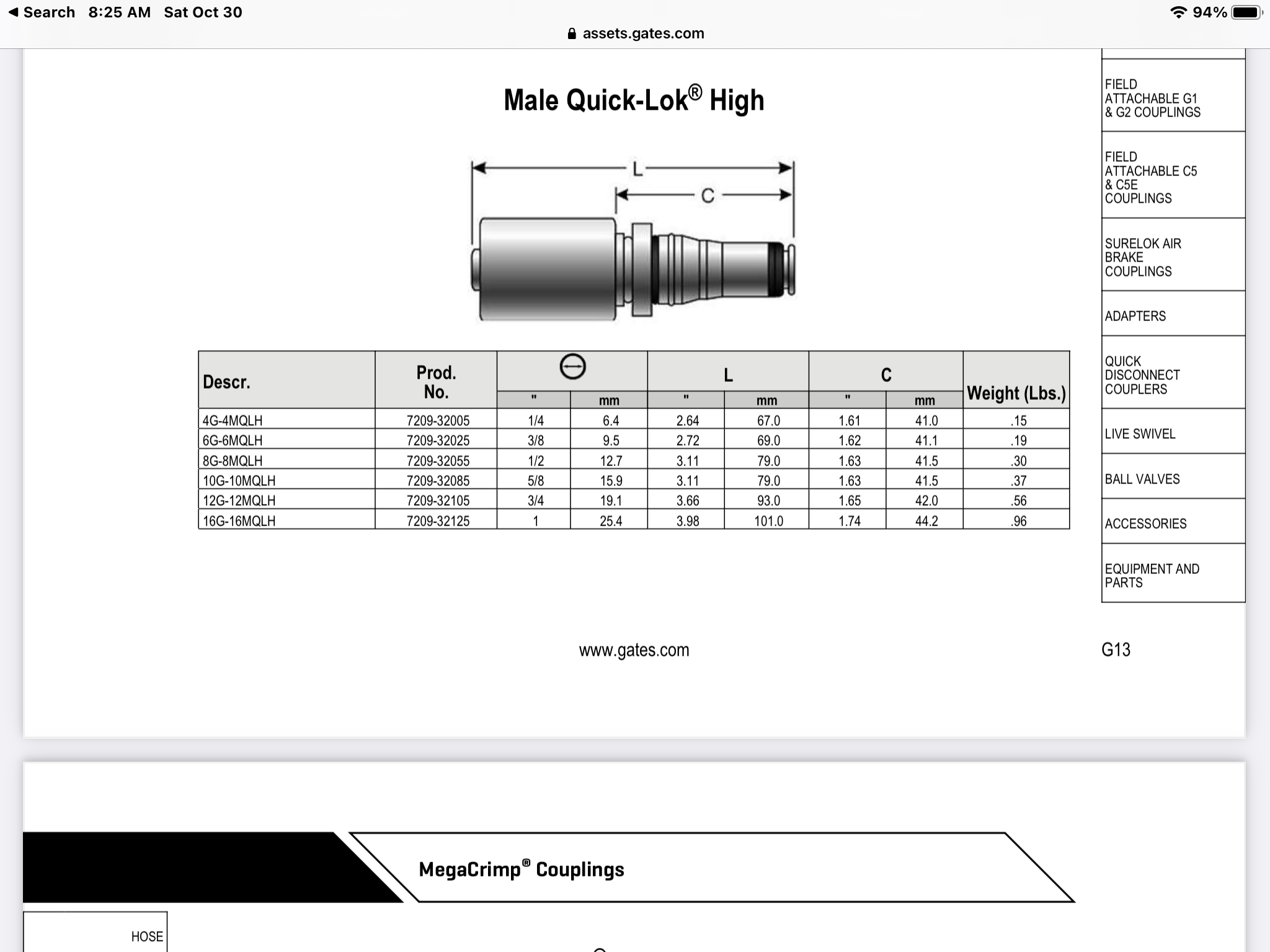

Maybe your talking about a Gates Quick-Lok?

New Holland and Quicke sell adapters with a male WEO fitting on one end and male JIC on the other. I used to stock them so we could make up replacement hoses with JIC fittings and use the adapters. Far better than ordering complete OEM hoses and being down until they arrive. Note there are at least two sizes of WEO fittings that ALO uses.
A search turned up this example.

thank you for that info.
This pic shows two with red rings and one with a black ring. Do you know if the two with red rings different sizes ?
I'm thinking mine is the smaller one with the red ring around it. Looks more like 1/4 but it could be 1/2''.
I did find a number for ALO and called. The person I spoke with said nothing about having, or being able to install an adapter like this, but did say they had the push in type connectors they could sell me. but I needed my loader mod number to to look at a diagram know what size fitting I need.
I was lucky enough to have a shop to splice the bad hose to get me going but I need to keep some adapters like these

When I was a parts manager in NY at a New Holland / Quicke dealer I was able to order the adapters from NH and through Bush Hog who distributes Quicke parts in the US. If need be I can reach out to the guy I used to work with and get part numbers. I don't recall if the ring colors are an indication of size. I've been here in NC over 4 years now.
Edit: dimensional info and another link with more info.
