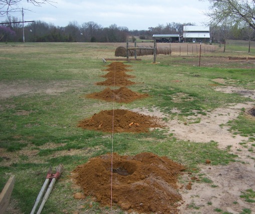

Also ... we have some bad clay here. At times we cant drive a t-post. But here are some pictures of 10" holes I just dug a couple days ago ... and its been dry.
