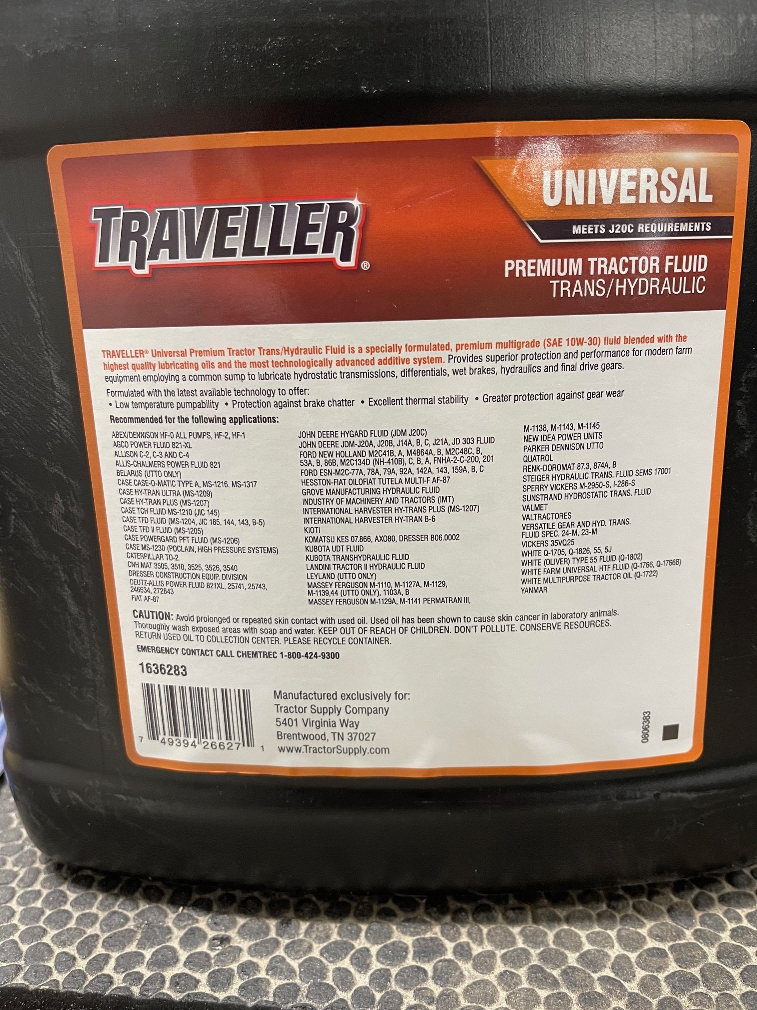

Here is the back label of the above linked TSC fluid. I keep some on hand for topping things off. Don't have enough hours to change yet.
Anywho--since Mobilfluid 424 is in the Kioti manual, I would recommend folks do a spec comparison between Delvac fluid and 424. It's listed in different orders on the Mobil page, but
Notice it says “recommended for” not “meets or exceeds the following specifications”
/ Hydraulic fluid #37
Actually, it does. Read a little higher up on the label.
It says it meets jd20c. It doesn’t say anything about meeting all the other specs in the list.
