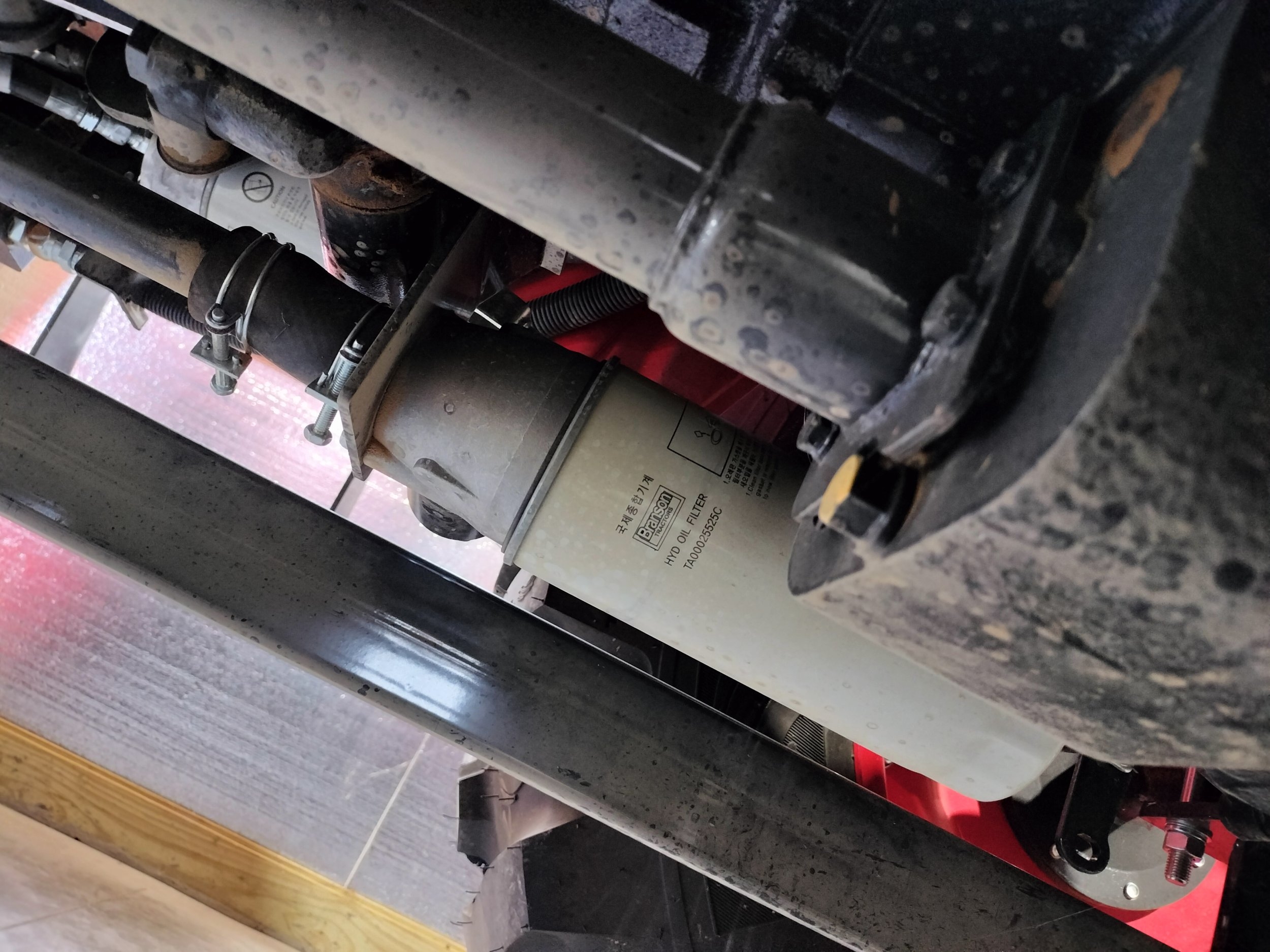

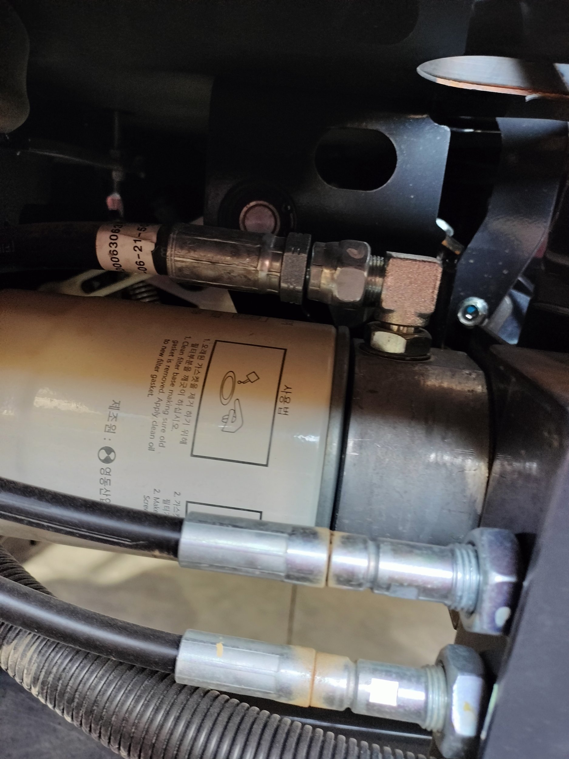

Branson took a different approach, so the filters are not painted over.
   / Hydraulic fluid #64
Here ya go, took me a bit to find it. Post #4 shows the complete video; Yes, they do paint over the Hyd filter (at least with that particular model shown)... Skip to 4:23 and 5:10 of the vid for the primer/painting portions.
Wow.
