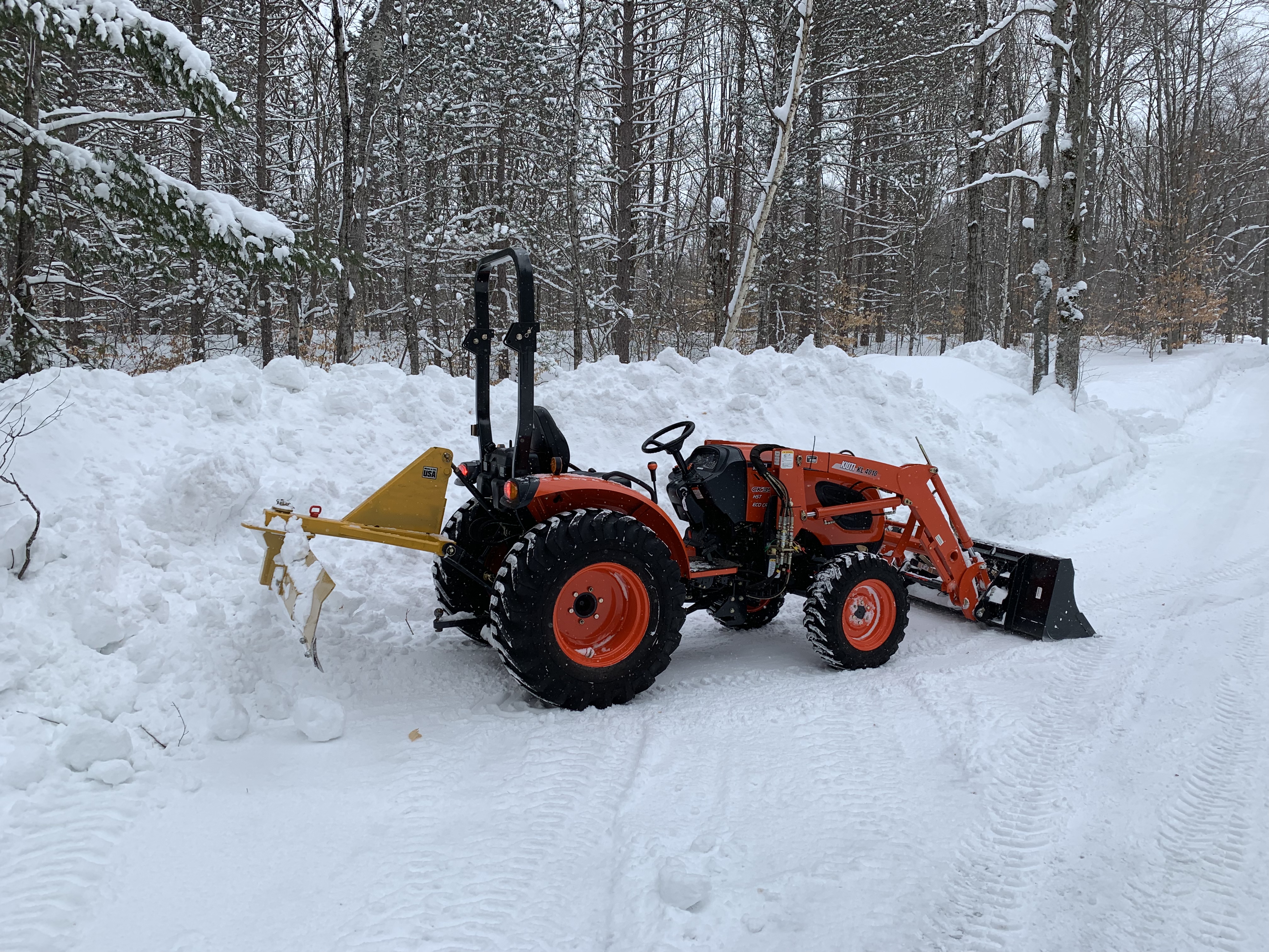

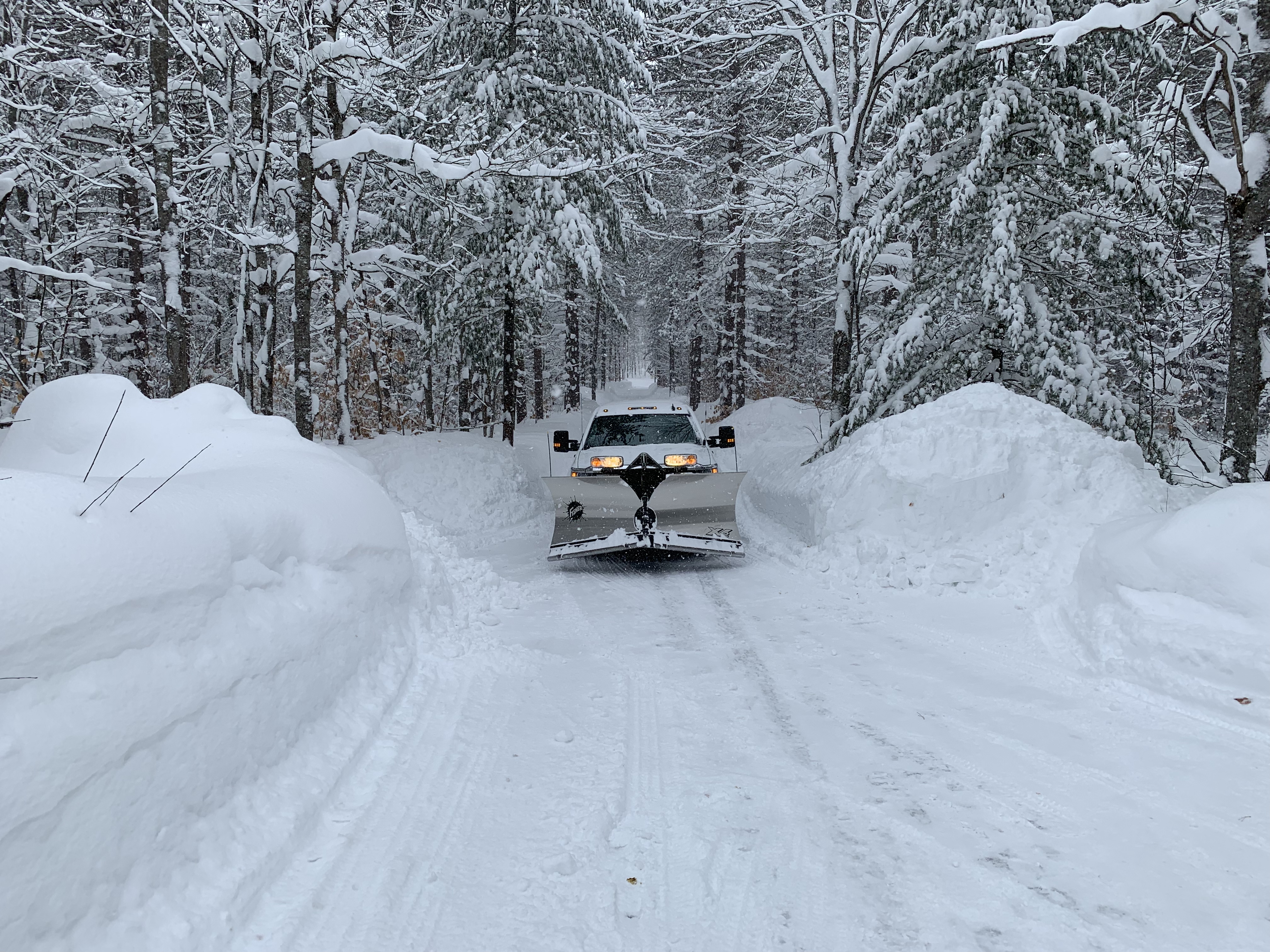

I have 3/10 mile driveway through the woods that I’ve been plowing and there are times I run out of room. So I get out my Kioti CK-3510Hst with FEL and move piles.
So I thought I would get a rear PTO snowblower but after reading other threads with neck issues so I’ve ruled the rear PTO snowblower out.
So I decided to go the front snowblower route but the Kioti front has to be dealer installed and they have to remove my backhoe mounts to install snowblower subframe mounts.
A friend told me about his setup from the 90’s which was a 80 hp Belarus with a front hydraulic snowblower.
My Kioti is 35 hp. Has anyone used a skid steer tool mount hydraulic snowblower with a compact tractor?
Pros or cons to using a hydraulic snowblower mounted to the loader tool mount?
If so what location did you mount the pump? Mid PTO or rear PTO?

A compact tractor just doesn't have the GPM hydraulic flow necessary to run something like a hydraulic front snow blower. Even larger tractors would struggle. That's why most hydraulic front blowers use a Power Pack mounted on the 3PH. The Power Pack is basically a big high flow hydraulic pump that runs off the PTO and has its own oil reservoir and cooling system. They work well but they are VERY expensive... $8-10K for starters.
I echo the previous poster. Reconsider a rear snow blower. I do the majority of my plowing going in reverse with a rear blade. It's not that big of a deal. Turn yourself around in the seat a bit so you don't have to turn your neck all the way around. If looking over your right shoulder it also helps to rest your right arm behind the seat. It's not that bad really.
