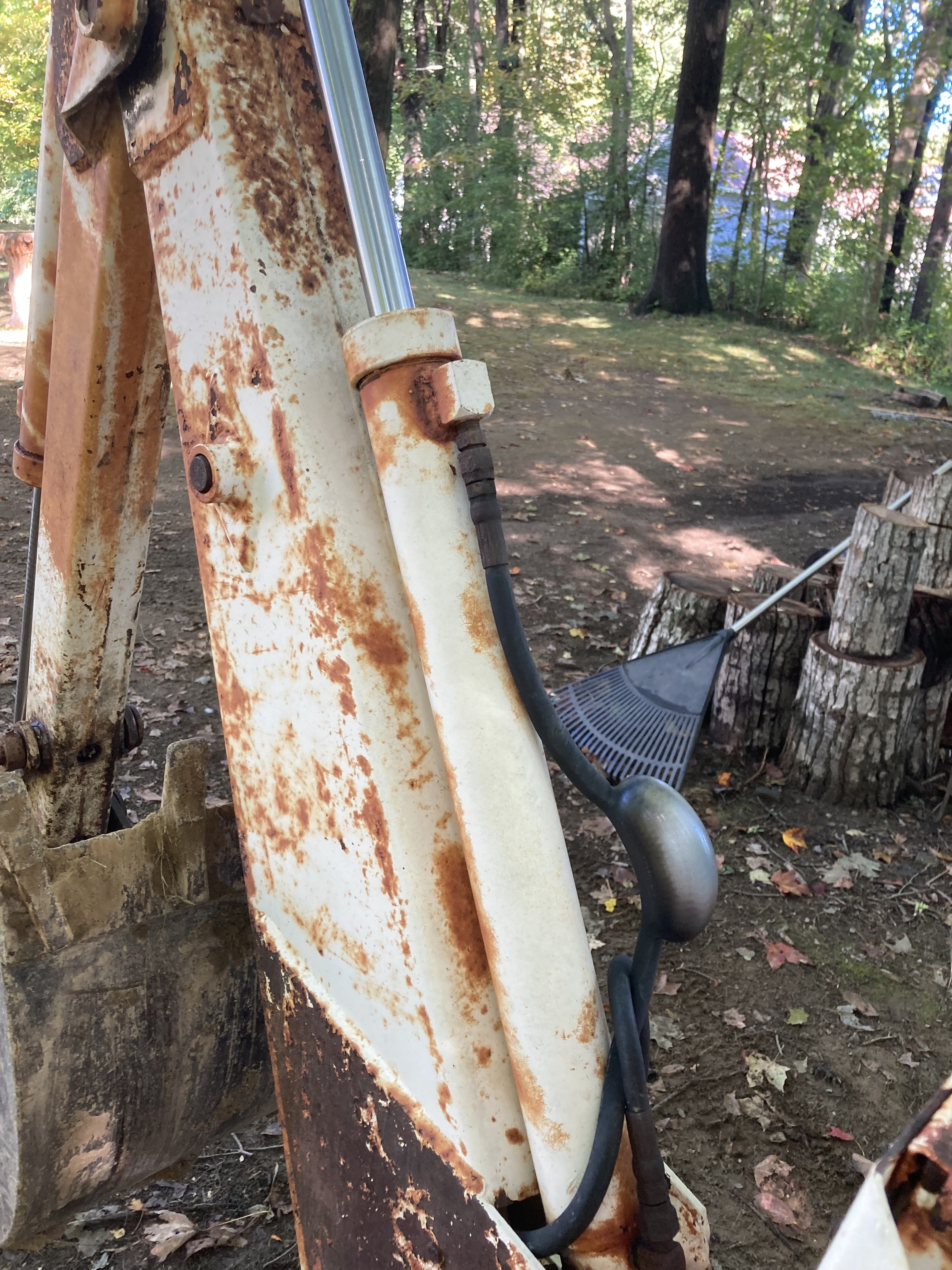

How long should I expect to get out of a new hose?
   / Hydraulic hose bulge #14
A quality 4 wire hose can last 30-40 years. A made in China 2 wire hose lifespan is considerably less.
   / Hydraulic hose bulge #15
If you're not in a hurry, there are many online options available that make up custom hoses at a good price, usually quite a bit cheaper than locally. Just learn to know your fittings [most have good reference pages] so that you order the right thing. And yes, I would look into changing the other exposed hoses out that look just as bad that haven't let loose yet.
   / Hydraulic hose bulge #16
I've never replaced a hydraulic hose on my 1972 IH354 (it has a loader) but I've replaced two hoses on the backhoe that came with my 2006 John Deere 5205. Both tractors are parked in a shed out of the sun.
   / Hydraulic hose bulge #17
Some auto parts stores make hydraulic hoses. I use a midwest chain called Parts City. Take the old one in after you have drained all hydraulic oil out of it. One place i sometimes use even has a sign on the door to leave hyd hoses in your vehicle. They come out and get a measurement.
   / Hydraulic hose bulge #18
Wrap it with duct tape. If you can’t fix it with duct tape… it can’t be fixed.
   / Hydraulic hose bulge #19
I have a 24 yr old JD with FEL and drag box, my habit is to change all hoses in a set when 1 goes bad. All the hoses except 1 were original when I bought it. When 1 fel hose went bad I replaced all 8, when 1 steering hose went bad both got done, soon it will probably be the 4 main transfer hoses. I agree, no China hoses.

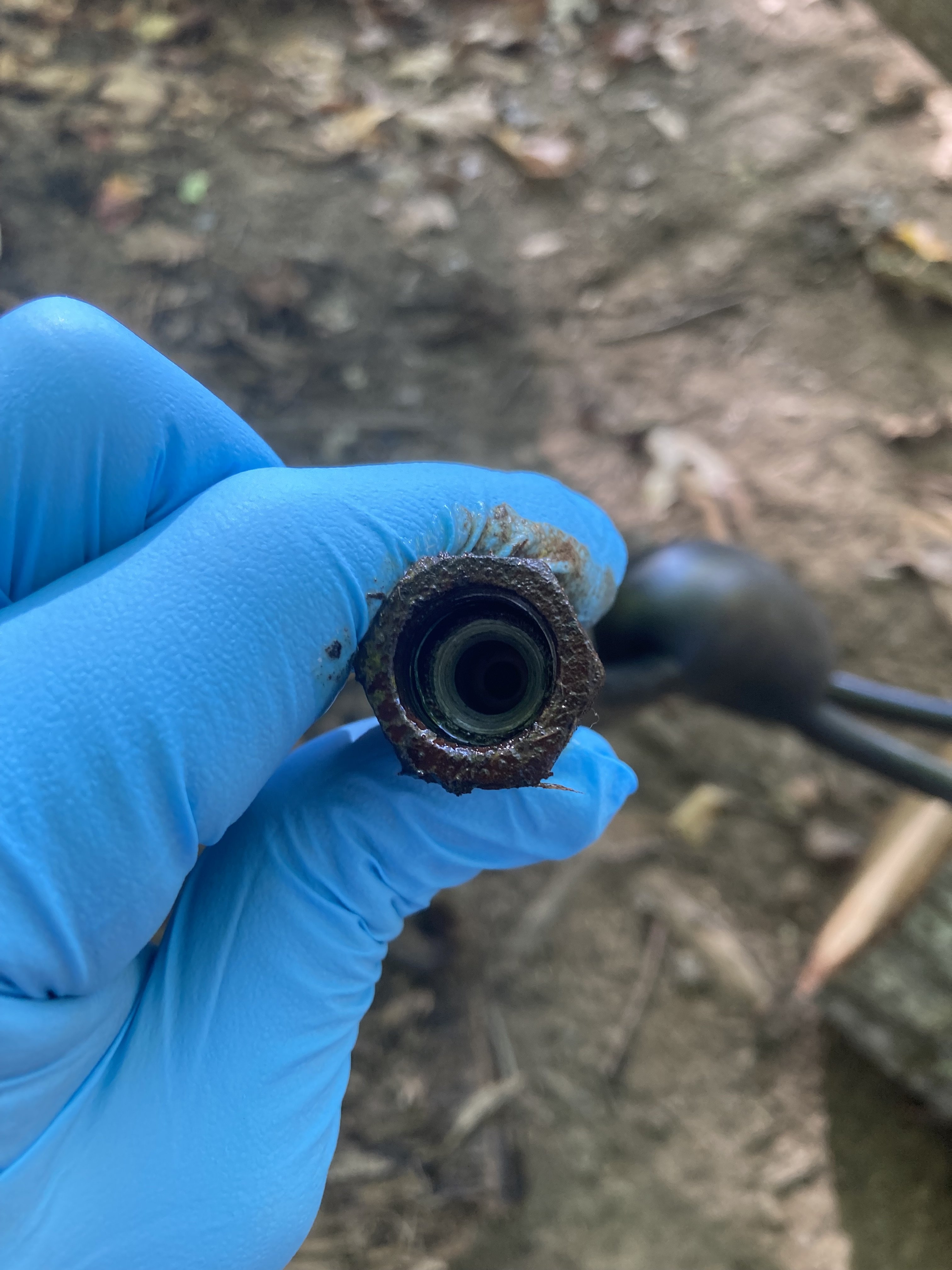

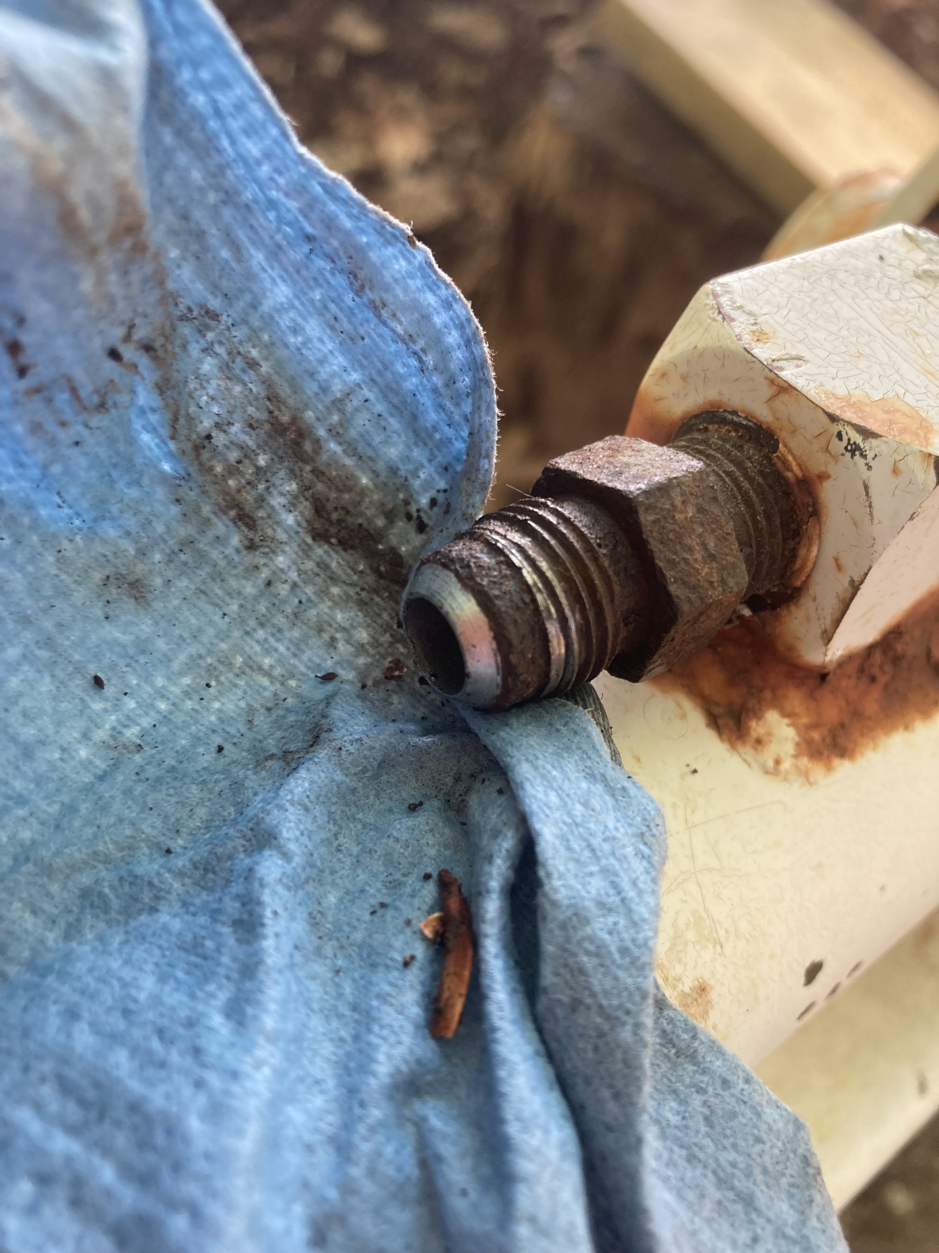

#20
Couldn’t find one at TS. Seems they have mostly 1/2” and I need 1/4” so I’ll order one online tonight. What are these fittings called? Both ends of the hose are female and have a flared in shoulder.
