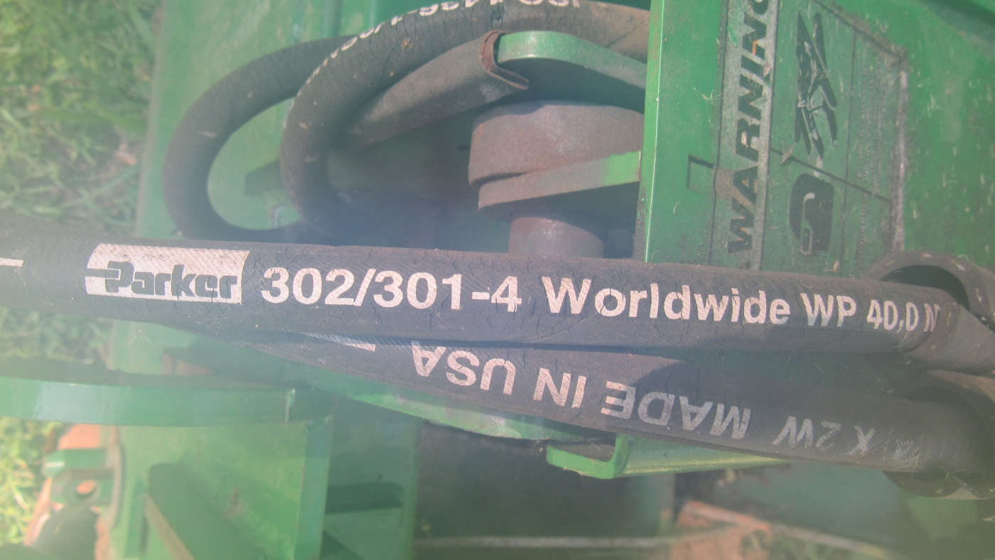

My grapple came equipped with Parker brand made in the USA hose. It is 2-1/2 years old and the hoses show hairline cracks all over the covers.

All I use is Parker and hairline cracks in the outer sheath means nothing. If the hose meets ASAE specs and is stamped as such, it's good to go far as working and burst pressure.
/ Hydraulic hose quality #7
Hairline cracks are the beginning of the outside cover failing.
I much prefer my hydraulic hoses to show no cracking.
That said I have some in use on my Backhoe that were missing pieces of the outer cover before I got the machine. So yes, a hose may continue to function long after the outer cover shows signs of deterioration. But, cracking doesn't mean "nothing".
Given a choice of a new hose assembly I will choose a brand that doesn't start to crack in two years over one that does.
