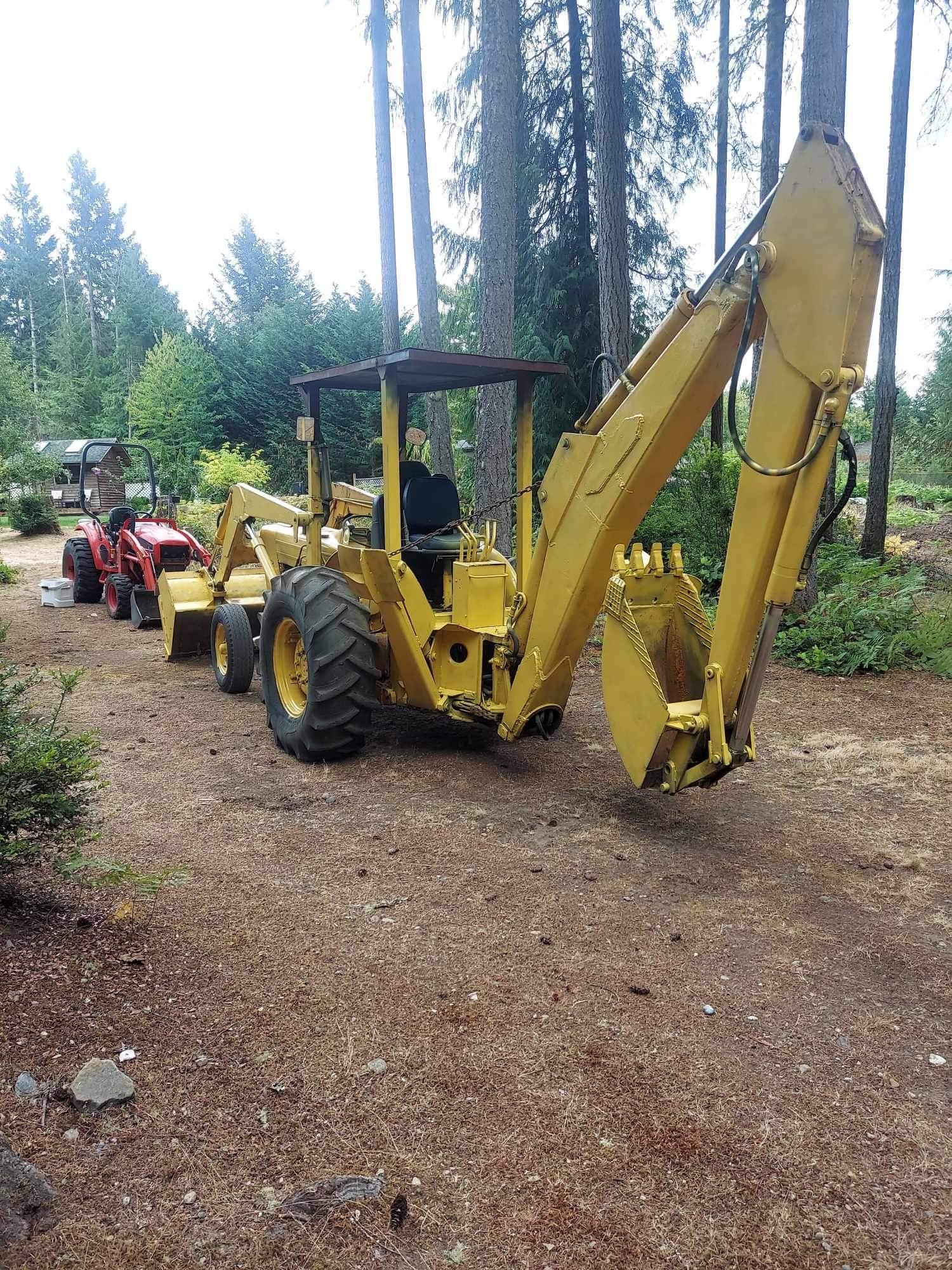

been a long time. My tractor has been sitting for way too long. I was hoping I could find somebody reasonable to replace my hydraulic hoses for my backhoe. I couldn’t. I have to do it myself. I have a 4500 Ford industrial with 755 backhoe The hoses that go under and up to the manifold seem very difficult to get to any suggestions ideas tools needed any help would be greatly appreciated.

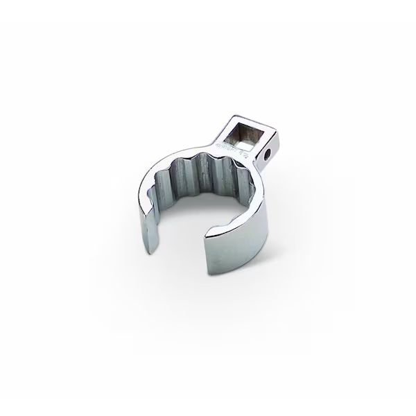

A crowfoot line wrench of proper size like pictured below can save a lot of frustration with the lines so close together. You'll want it thin walled like this to get between lines. A breaker bar/flex handle or even a 1/2" ratchet will work with it. Usually a 1/2 turn and you can probably loosen it the rest of the way with your fingers. May have to wiggle it a bit while turning. They are a bit pricey, but worth it for the frustration they save.

But to the OP question - tips and tricks to change BH hoses in the boom:
- Lift the BH rear tires as high as possible with outriggers to make the boom and bucket as straight as possible so the bend at the bottom of the boom is open as much as possible. This makes it easier to get around that bend.
- If you are going to replace all the hoses then take pics and mark them all then pull in some good rope to put the new hoses back in.
- If selective replacement I found its easiest to pull the new hose in when you are pulling the old hose out using a coupler - but you need to have the new hose lenght correct - you may be able to get those lengths on line if you search.

Thanks so much. I have regular crows feet.I can see how that would be better will the opening get around hose?

Regular crow feet may be a bit wide to get in between fitting, but there's always that chance they will.

I’m trying to find the crows feet that you pictured and some 30/60 wrenches. it looks like I need a 7/8 a 1 inch and a one and a quarter. Everybody was very encouraging and it doesn’t look as bad as I thought. Thanks again. Wish me luck. I will keep everyone posted.

Although a 3/8" drive here's an SK 1" on ebay that won't break the bank SK Hand Tools 42232 1" ,,, 3/8" Drive Fractional Flare Nut Crowfoot Wrench | eBay And a 3/8" drive 7/8" Armstrong Armstrong 11-846 7/8" 3/8" Drive Flare Nut Crowfoot Wrench USA | eBay
And a 1/2" drive two-fer 1-1/4 & 1-1/2 older Utica brand made in USA Older Utica Loc-Rite 1-1/2" Head & 1 1/4 Head 1/2" Drive Crowfoot Wrench | eBay All on ebay if you deal there.
Looks like you can nearly buy all of them for the price of one Wright brand I pictured earlier new.
Even though the first 2 are 3/8" drive a breaker bar should easily break the hose connections. Most swivel ends I've dealt with aren't torqued all that tight, just the initial breaking it loose, which isn't all that hard to do, you're home free.

You can loosen all the hoses on one end and then go to the other end and do the same BUT only remove one hose and then replace it so you don't mix up the connectiions

I have a 1998 New Holland 555E Loader Backhoe. I have no idea how many hoses it has, but it's safe to say there are a lot of them!!!!
In my case, I've been running this backhoe for over 20 years, and I've replaced a lot of hoses. But I haven't replaced all of them. A few are still original!!!
don’t forget to block up the rear end after lifting and before loosening hoses.

DD—I forgot to mention that! When I did some hoses last fall, I raised the BH with stabilizers as high as it would go and then put jack stands under the frame. Once you get the hoses off, I didn't want to run it until it's fixed, then for safety.

I got all these for 80 bucks. They are Bonnie and Armstrong. Looks like all the sizes I need plus some and I’m getting a couple 3060 wrenches I think I have everything else gonna try next week thanks.

I see that Amazon has some Ratcheting Crowfeet wrenches now. I was about to pull the trigger then read the reviews. Apparently, they still need some refinement. I held off. It's not even spring yet anyway.
