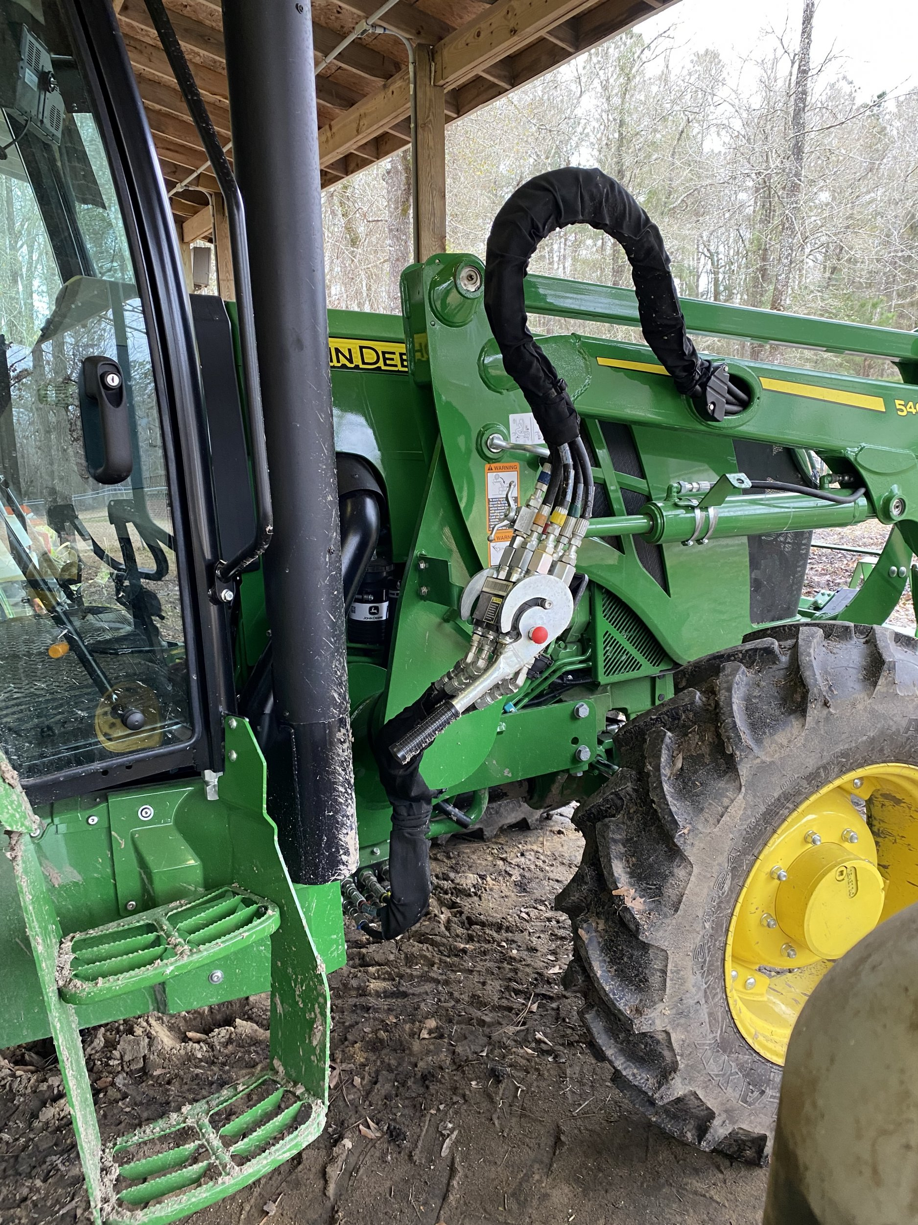

Sep 22, 2021 / Hydraulic Hoses, Couplers & Brackets for JD 5115M Loader Frame Bracket Mounts Thread Starter #11 OP Brown Dog Veteran Member Joined Jun 5, 2014 Messages 1,454 Location North GA Tractor John Deere 5115M 5101E H260 5115M 540M all MFD this is my setup on my 2018 5115M & what I’m wanting to put on this used 2020 that I’m buying.

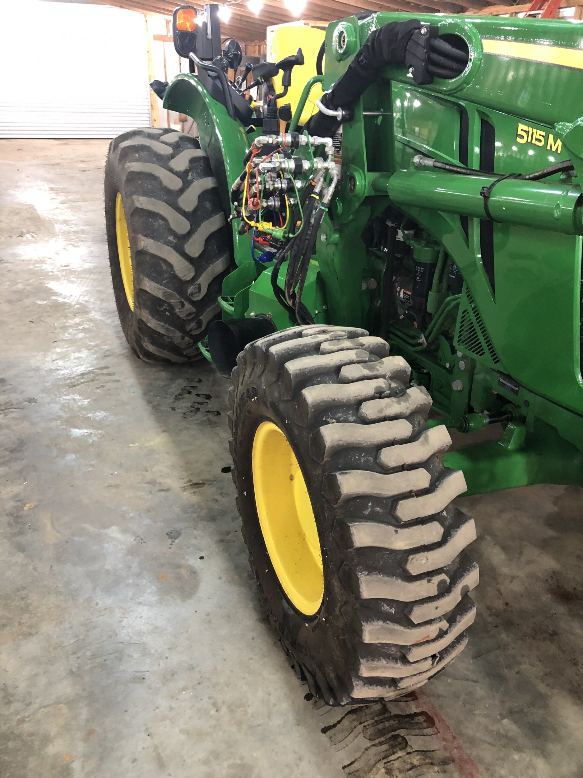

Sep 22, 2021 / Hydraulic Hoses, Couplers & Brackets for JD 5115M Loader Frame Bracket Mounts Thread Starter #12 OP Brown Dog Veteran Member Joined Jun 5, 2014 Messages 1,454 Location North GA Tractor John Deere 5115M 5101E H260 5115M 540M all MFD these two brackets & couplers is what I’m going to order from my JD dealer. edit: JD dealer give me part # BXX10085 on these 6 hydraulic couplers & 2 brackets $713 Last edited: Sep 24, 2021

Sep 22, 2021 / Hydraulic Hoses, Couplers & Brackets for JD 5115M Loader Frame Bracket Mounts Thread Starter #13 OP Brown Dog Veteran Member Joined Jun 5, 2014 Messages 1,454 Location North GA Tractor John Deere 5115M 5101E H260 5115M 540M all MFD workinonit said: BD, I have that loader in the configuration you are looking for if you need to see some pics. Click to expand... Is your setup like my pix ?

Sep 22, 2021 / Hydraulic Hoses, Couplers & Brackets for JD 5115M Loader Frame Bracket Mounts Thread Starter #15 OP Brown Dog Veteran Member Joined Jun 5, 2014 Messages 1,454 Location North GA Tractor John Deere 5115M 5101E H260 5115M 540M all MFD workinonit said: No. I have the single point connector. Click to expand... Is your main bracket that bolts to tractor loader frame with 2 bolts like my pic or different ?

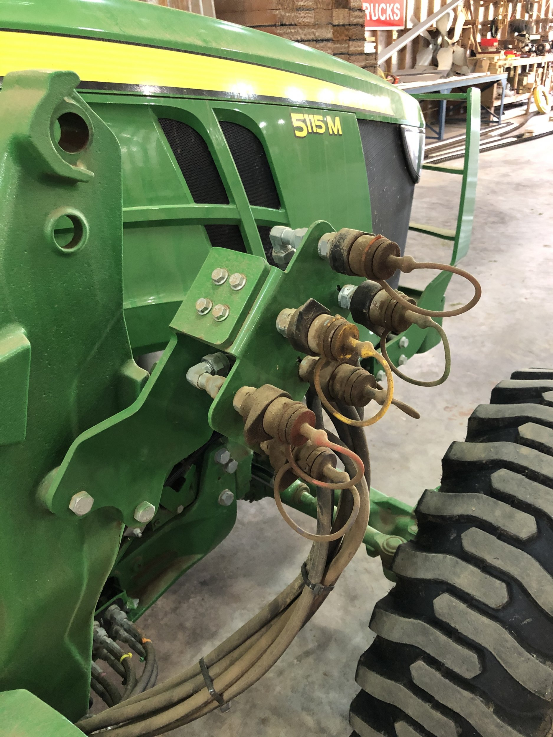

Sep 22, 2021 / Hydraulic Hoses, Couplers & Brackets for JD 5115M Loader Frame Bracket Mounts #16 workinonit Elite Member Joined Sep 13, 2020 Messages 3,135 Location Scranton, SC Tractor JD 5090E The SP connector is a bit different. I will take a couple of pics and post them. Give me a few.
Sep 22, 2021 / Hydraulic Hoses, Couplers & Brackets for JD 5115M Loader Frame Bracket Mounts #17 workinonit Elite Member Joined Sep 13, 2020 Messages 3,135 Location Scranton, SC Tractor JD 5090E BD, look at this pic and see if it's any help. If not I can get some more. Attachments IMG_1013[1].JPG 3.6 MB · Views: 139

Sep 24, 2021 / Hydraulic Hoses, Couplers & Brackets for JD 5115M Loader Frame Bracket Mounts #19 workinonit Elite Member Joined Sep 13, 2020 Messages 3,135 Location Scranton, SC Tractor JD 5090E 5090E

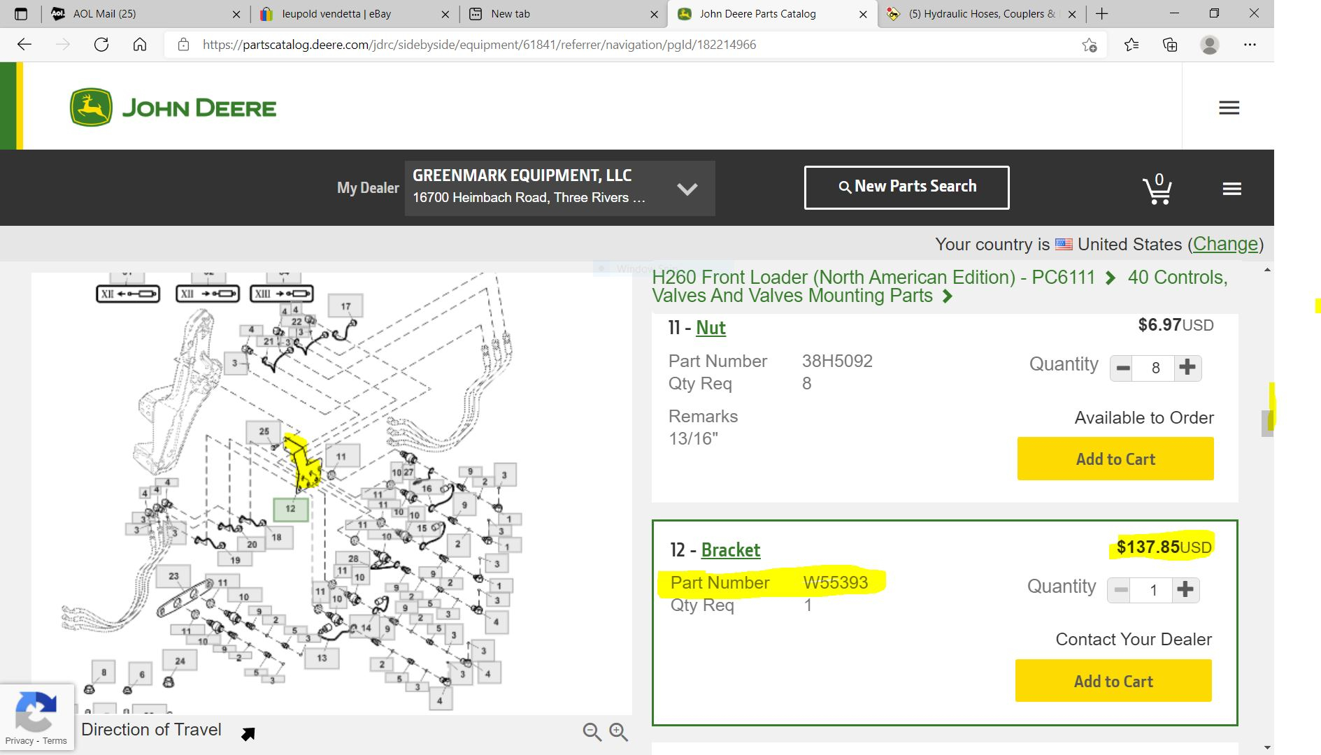

Sep 26, 2021 / Hydraulic Hoses, Couplers & Brackets for JD 5115M Loader Frame Bracket Mounts #20 Zebrafive Super Member Joined Aug 5, 2010 Messages 5,635 Location South West MI Tractor John Deere 2030, John Deere 6415 Here's the bracket used on the H260 loader, if that helps $138 The quick couplers are $56 and the nuts for them $7, so $378 for 6pc.
