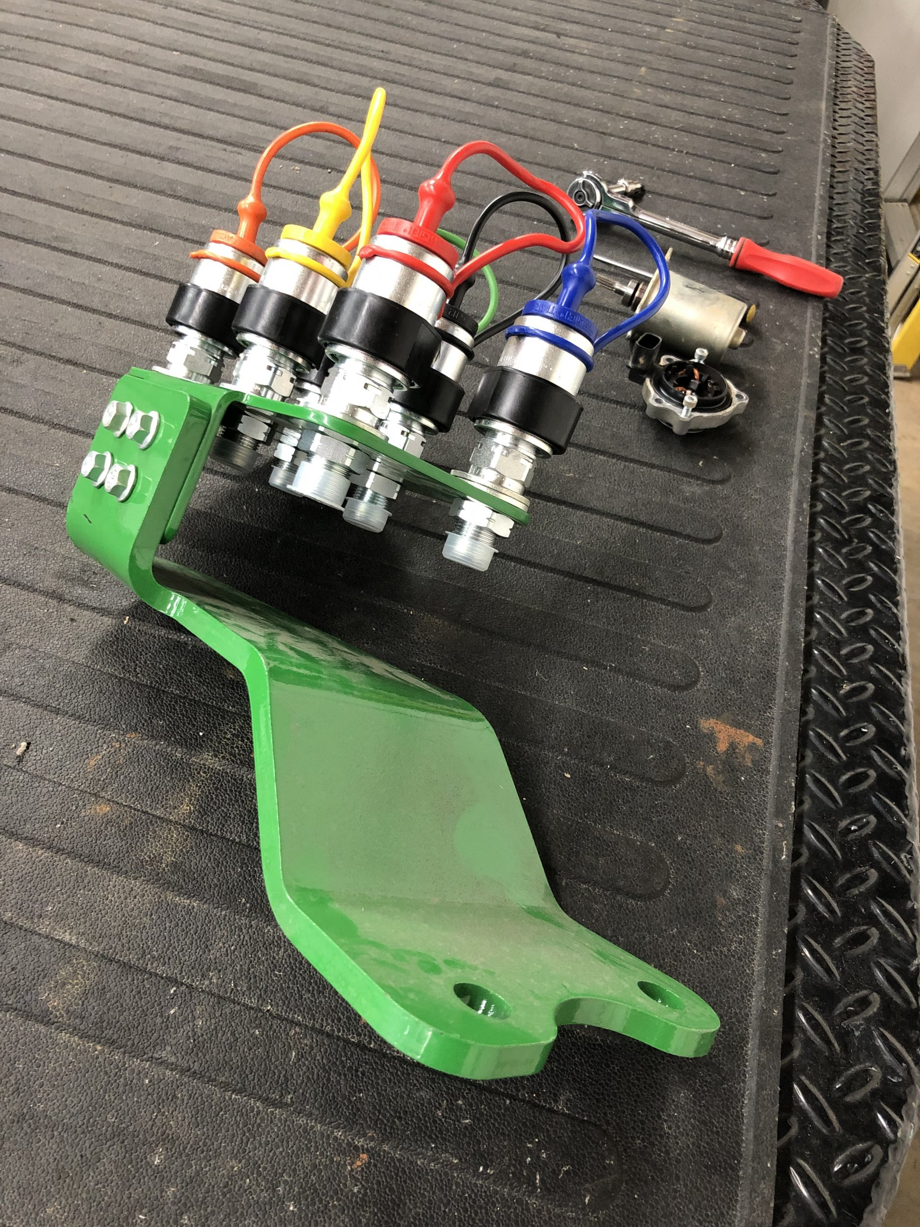

Yes I ordered the $713 BXX10085 assy like in my pix to match my 2018 tractor exactly. No hoses included at that price tho :cry:
JD hoses was over $100ea
got my kit today & pre-assembled it finger tight.
it came with all the needed fittings on tractor & loader including the 3rd function but no hoses

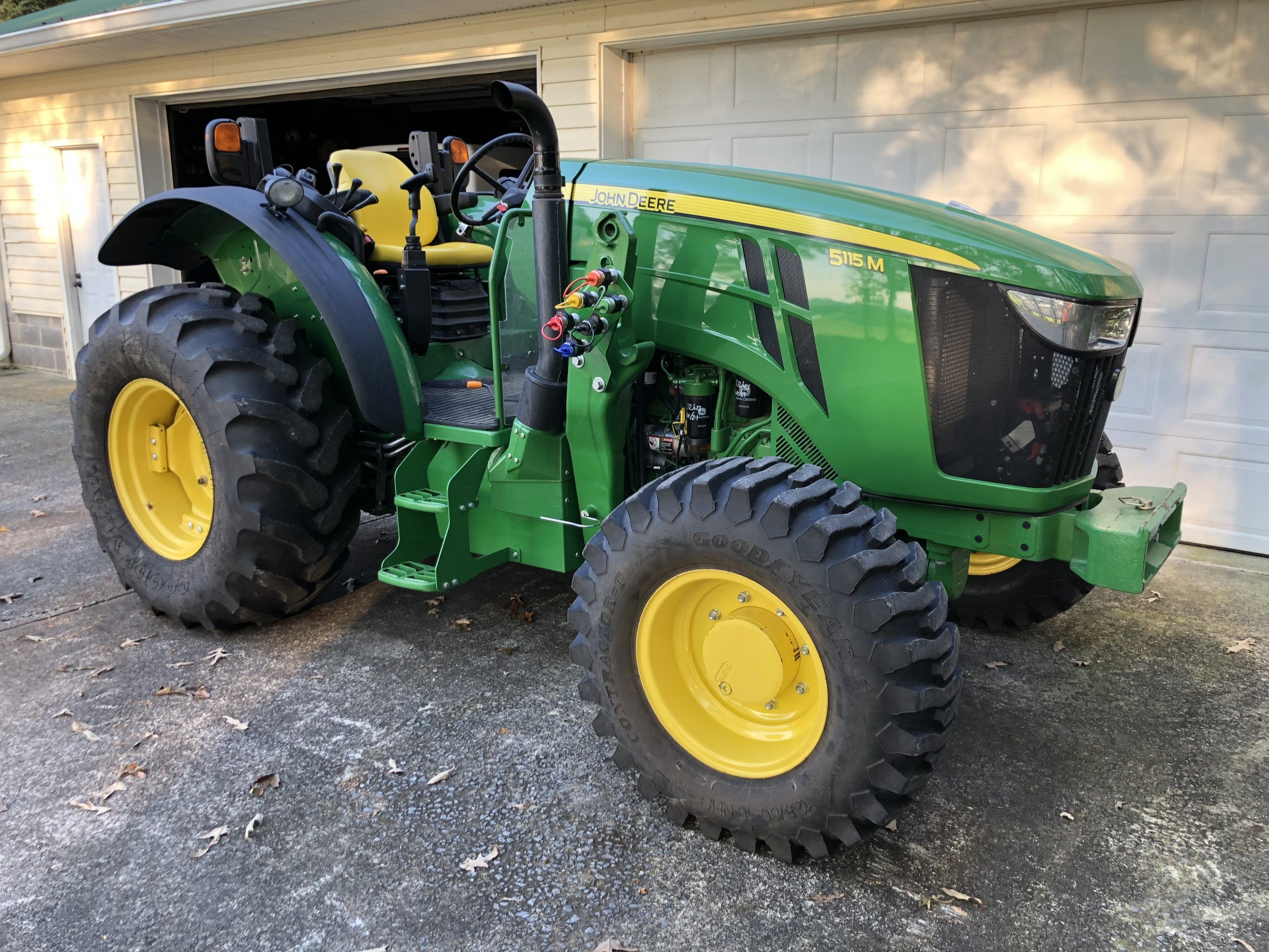

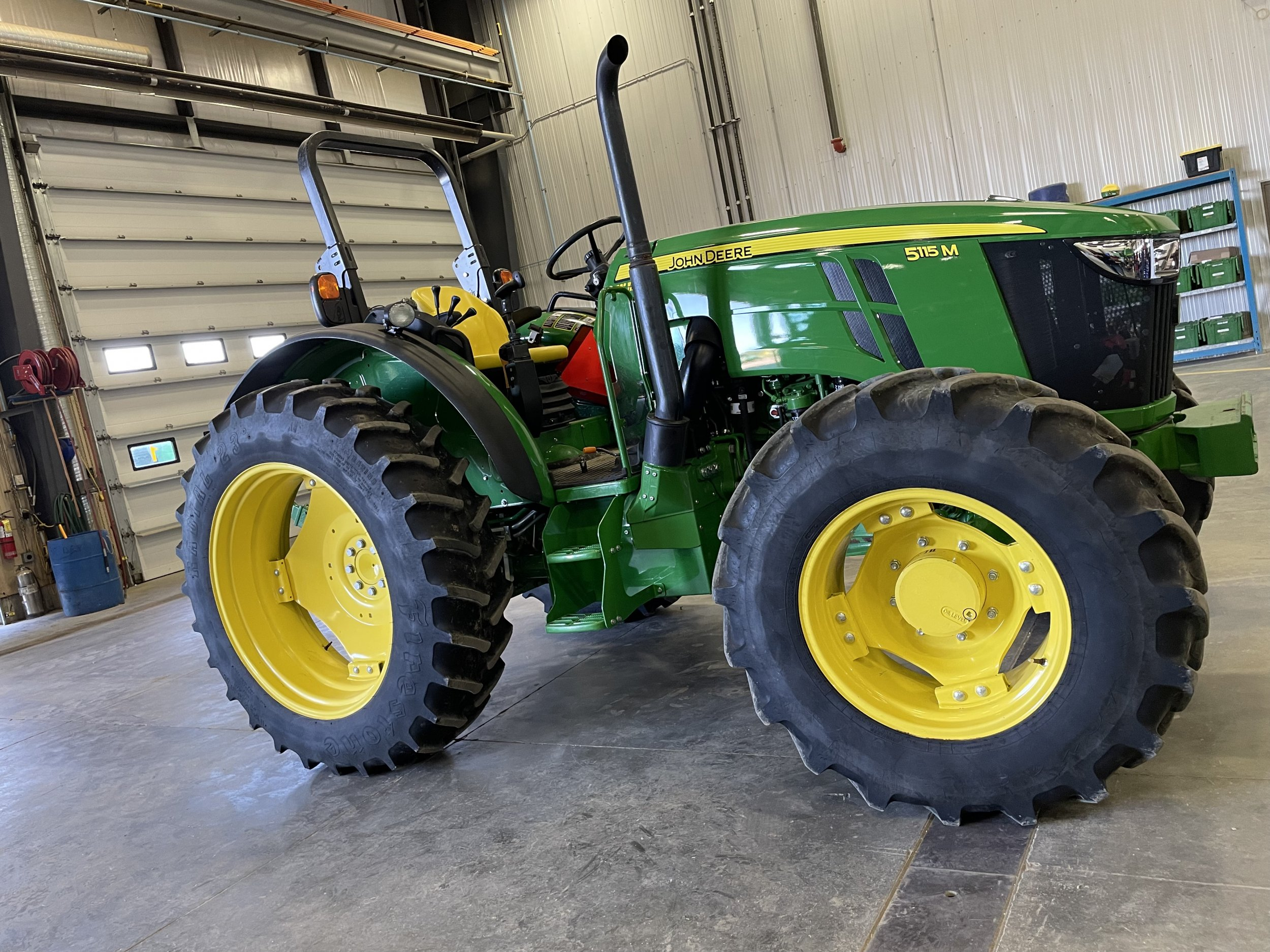

the used 5115M came in last night after dark.
We got it transformed with the R4’s after removing the tall R1 radials & hydraulic couplings installed before bedtime
Also cut 15” out of the upright exhaust pipe. 👍
Now waiting on hydraulic hoses from local hydraulic shop.

Most JD 5k Series Open station tractors don’t come with :
32spd trans
Creeper Gear trans option 16 additional speeds below 1mph
Air seat
Horn
Turn signals
Brk lights
3rd function mid & rear hydraulics
Hammer Strap draw bar Hitch
Radial Tires
It’s loaded up with all available options by the build sheet I have on it.
I Love it

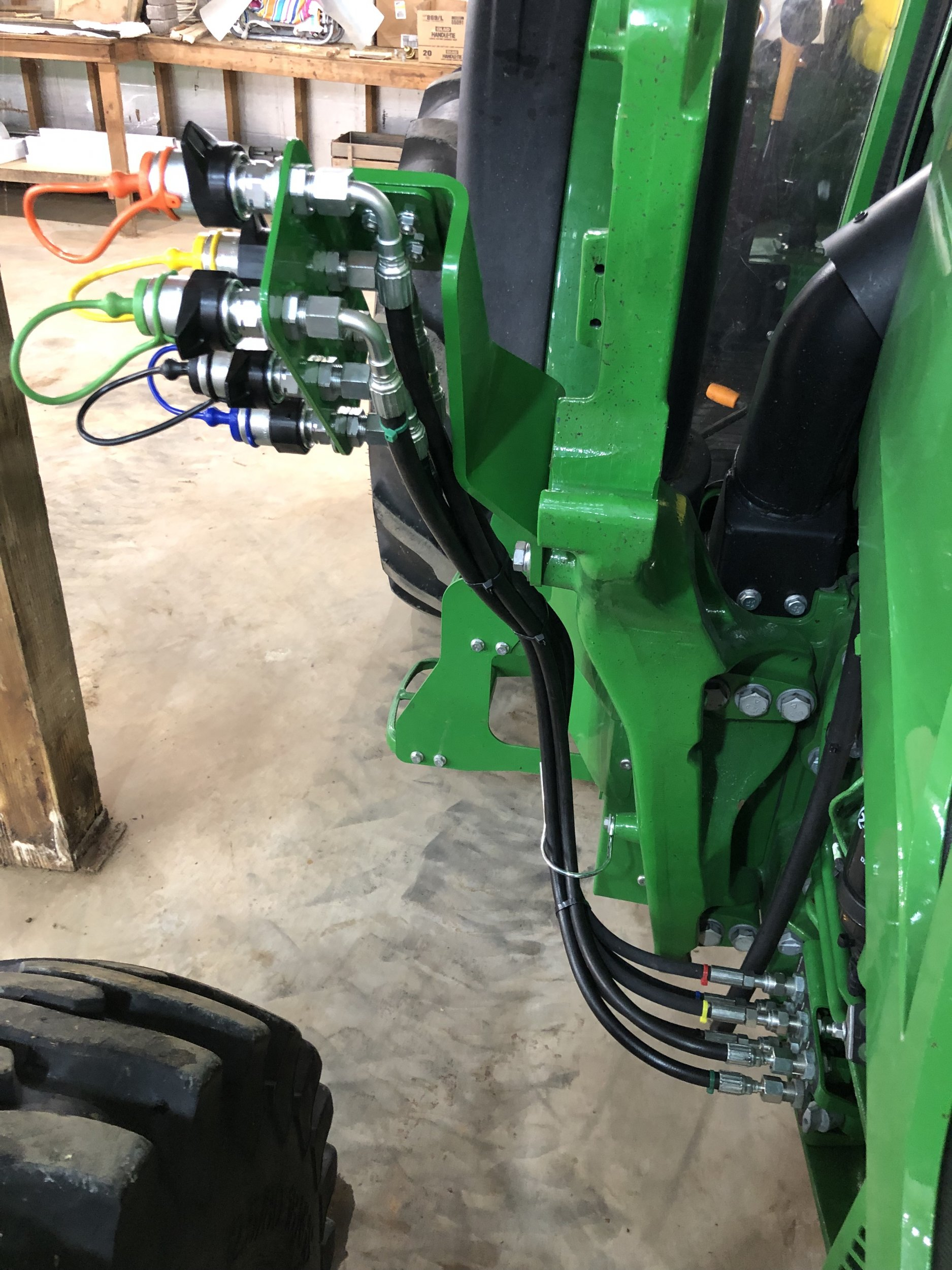

I had hoses made with 90* flat face o ring fittings on upper ends to eliminate the 90* double ended fittings like came from JD on my other tractor.
this is a cleaner less cluttered look imo
