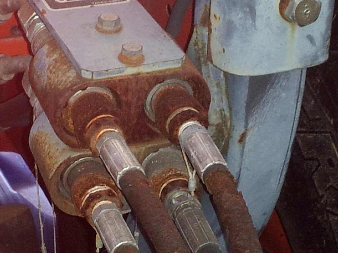

I need to replace some hose on this L-3130 Kubota. Can someone tell me how this coupling comes apart? Rear Hyd.jpeg.jpg
   / hydraulic hoses #60
On my M series Kubota, the connection you show is 3/8 inch, right hand, national pipe thread (3/8 inch NPT). I believe the hose end in your picture is a solid connection, so you will need to remove the other end of the hose first. I found a replacement at a farm supply store.
