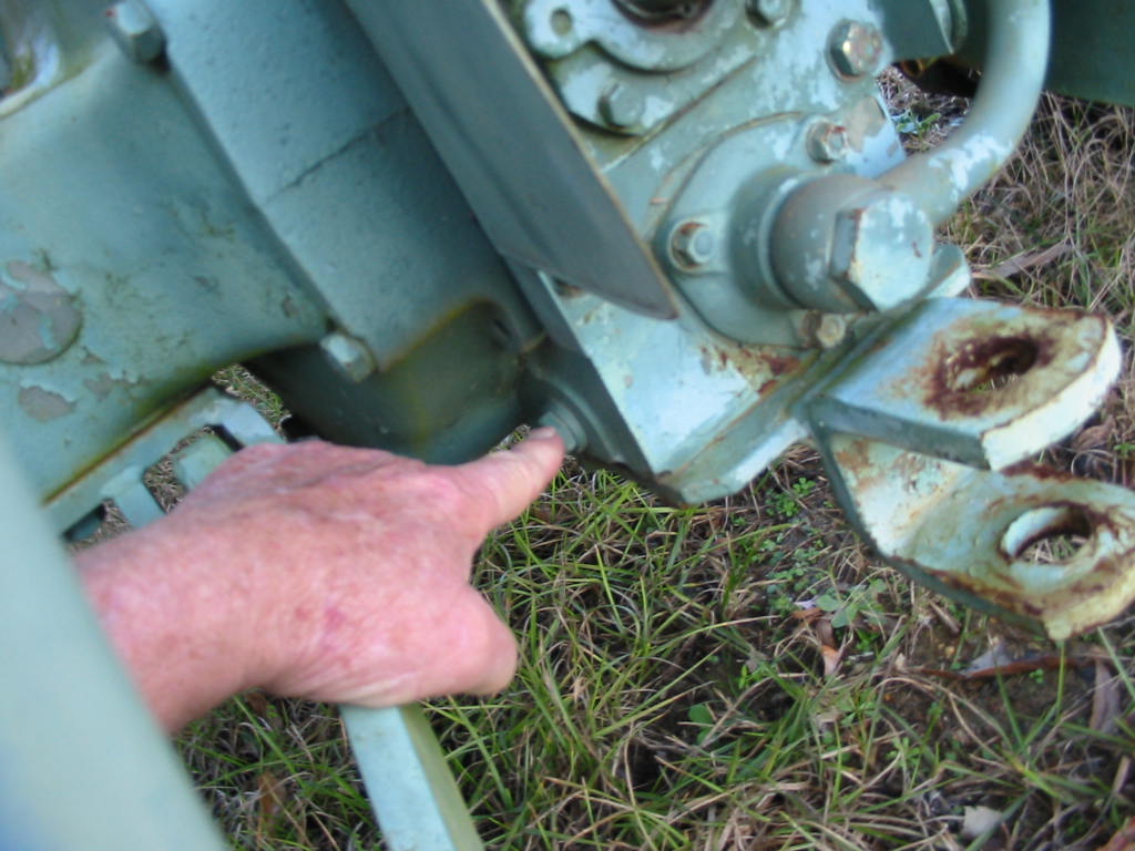

We have recently purchased a very low-hour, 'gray market' YM2200 that's having an issue with the front bucket not being able to hold a setting. When you tip it up, it only holds that position for 30 seconds or so. It did have a loose return hose (repaired) and a mildly leaking hose to the bucket (replaced). The oil level was topped off and all the leaks seem to be fixed. It has at least an hour of run time since the repairs and it's still not behaving. The service book we got is not, shall we say, the best...so I came here for advice! :D
Is it possible that it still has air in the system? Is there a check-valve that may need attention? Perhaps the filter needs cleaning? That said, where is the silly thing? :confused2:
Thanks!
If your YM2200 has a hydraulic reservoir under the seat, the screen will be behind the cover with 4 bolts.
Danny

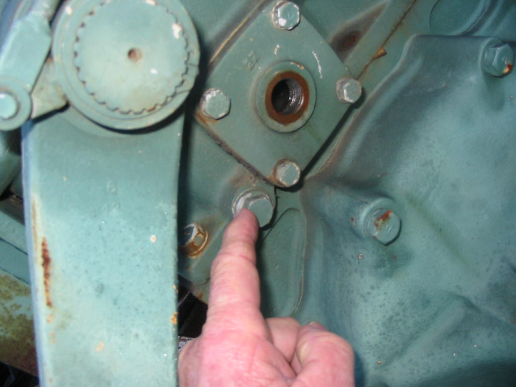

Thanks!
If there is no reservoir under the seat, the screen will be behind the cover with 3 bolts in a triangle, under the PTO shaft.
Danny
