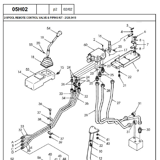

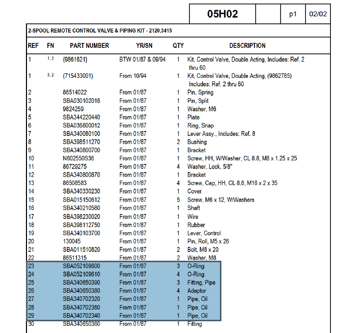

I have the parts catalog for the tractor but unfortunately, the description is next to useless. Parts 27,28,and 29 are the tubes in question. Description is "Pipe-Oil" NH website offers no additional information. Same for Messicks

Actually, that picture might be useful. Items 23 and 24 appear to be o-rings, yet it appears the fittings on your unit have pipe dope on those threads. Pipe dope should never be used on an ORFS fitting, perhaps indicating a prior owner re-assembled with bad or missing o-rings, and tried to incorrectly repair the resulting leak with dope?

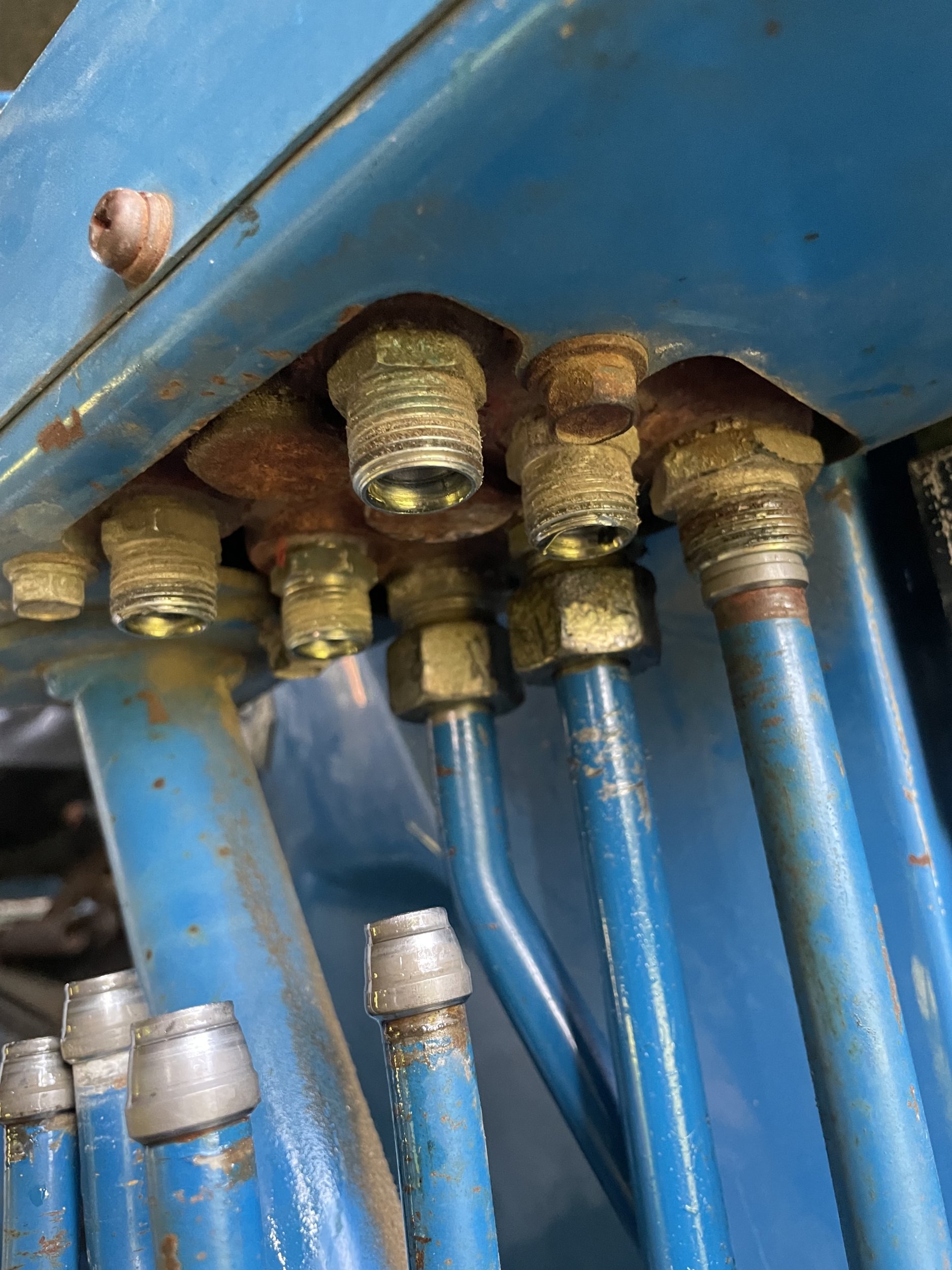

Thanks for the input everyone. Tube does appear to be metric. Measured OD at .5925" (15mm).

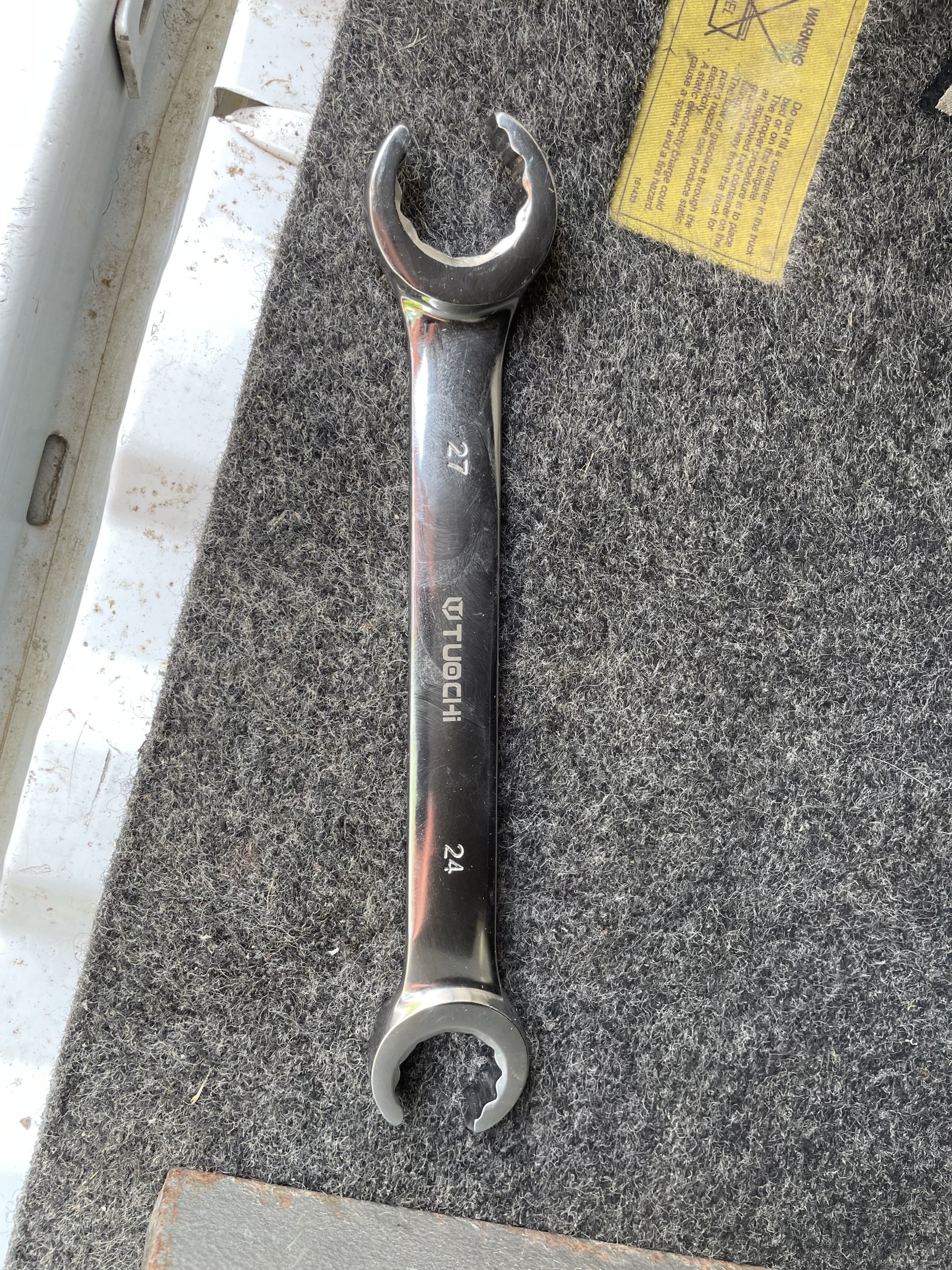

27mm line wrench is on order. Will try to tighten and let you know what I find out.
What type of line wrench have you got coming? I’ve been looking at a set of Milton Shockit line wrench sets you use with a air impact hammer or a hammer and punch in a pinch. They look like they’d be the ticket in that exact situation

Well, I got the line to stop leaking (at least for now). Had to pull all four of the 12mm front lines and one of the 15mm lines to get to the one leaking. Confirmed that they are DIN fittings. The 27mm line wrench (sometimes called a flare nut wrench) was essential to tighten the leaking fitting. I put about a 1/8th turn on it and then tested it before wrenching any harder. It worked. There could have been work done by a previous owner. Hoping I don't have to do a repeat performance soon but thanks to the input from everyone on this thread, I feel much more confident in tackling it next time. Picture attached for wrench reference. Amazon purchase ($17).
