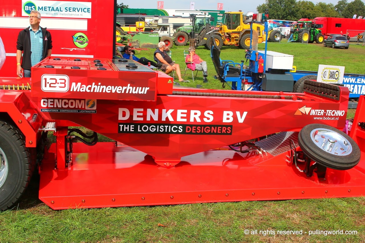

What if you put each wheel on an A-arm and had them fold up like the front wheels on a pulling sled?
If you mounted the A-arms behind the rear of the coop, you could get away with one cylinder in the center that would push them apart and down at the same time.
Alternatively, you could just put both wheels on a solid swing axle behind the coop and pivot the entire axle assembly down with one or more cylinders.

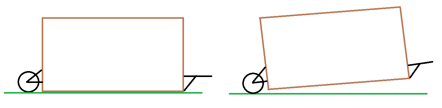

Simplest idea (other than skids)...
Permanently mount the wheels behind the coop and firmly touching the ground (but not enough to lift the coop). Then, when you lift the front with the 3pt, it will tilt back and be riding on the wheels.
