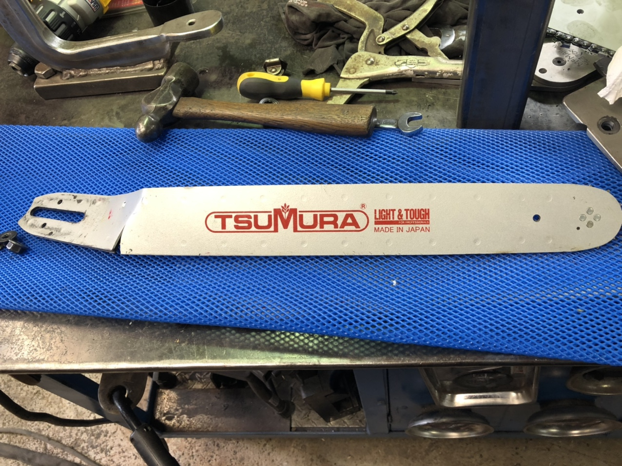

Spoke too soon. Totally my fault. Blindly swinging at a 1.5” maple limb up high, line of site blocked by the canopy, on a side slope. Should have set the brake, undone the seatbelt, stood up and to the side to see to position the saw? Some branches hard to get to and the manual 21’ Hayuachi polesaw the best choice.

Smokeydog, you have the skills and shop to flatten that out and tack it back for another round!! ;)

Keeping things simple has it merit. With the saw mounted on the right side of the grapple and saw blade mounted on the left side of the saw arm have a pretty good visual most of the time. Highest FEL and straight up the hardest to see. Taking time and patience the secret to success. I was on a steep side slope, with the FEL raised to the highest trying to cut a branch at the highest reach when I bent the bar. Had managed to cut about half way on a on a earlier attempt. The reason for the bent bar was operator error. Part of my education. Still learning the basics.

That bar was $42. Can get a Oregon bar and chain for $37. Like any tool with consumables the operator has a lot of influence of lifespan. This year going to focus on the many limbs I can easily do while visualizing potential improvements.
