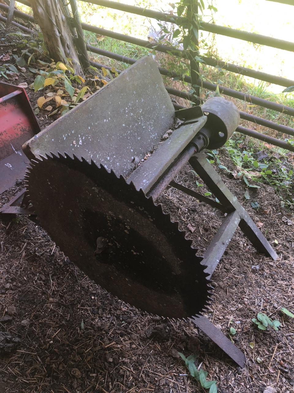

Bought an old buzz saw flat belt tractor saw.

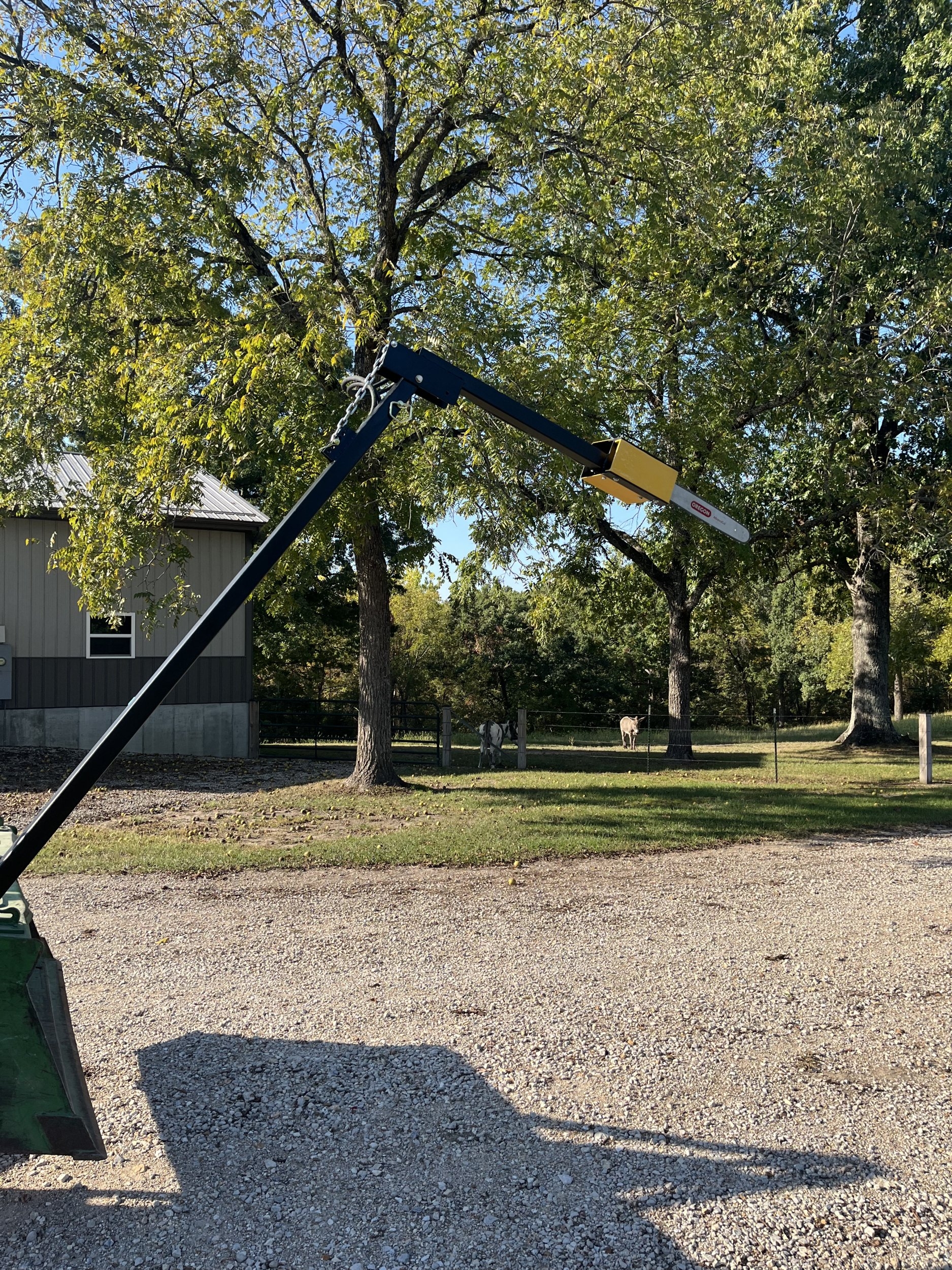

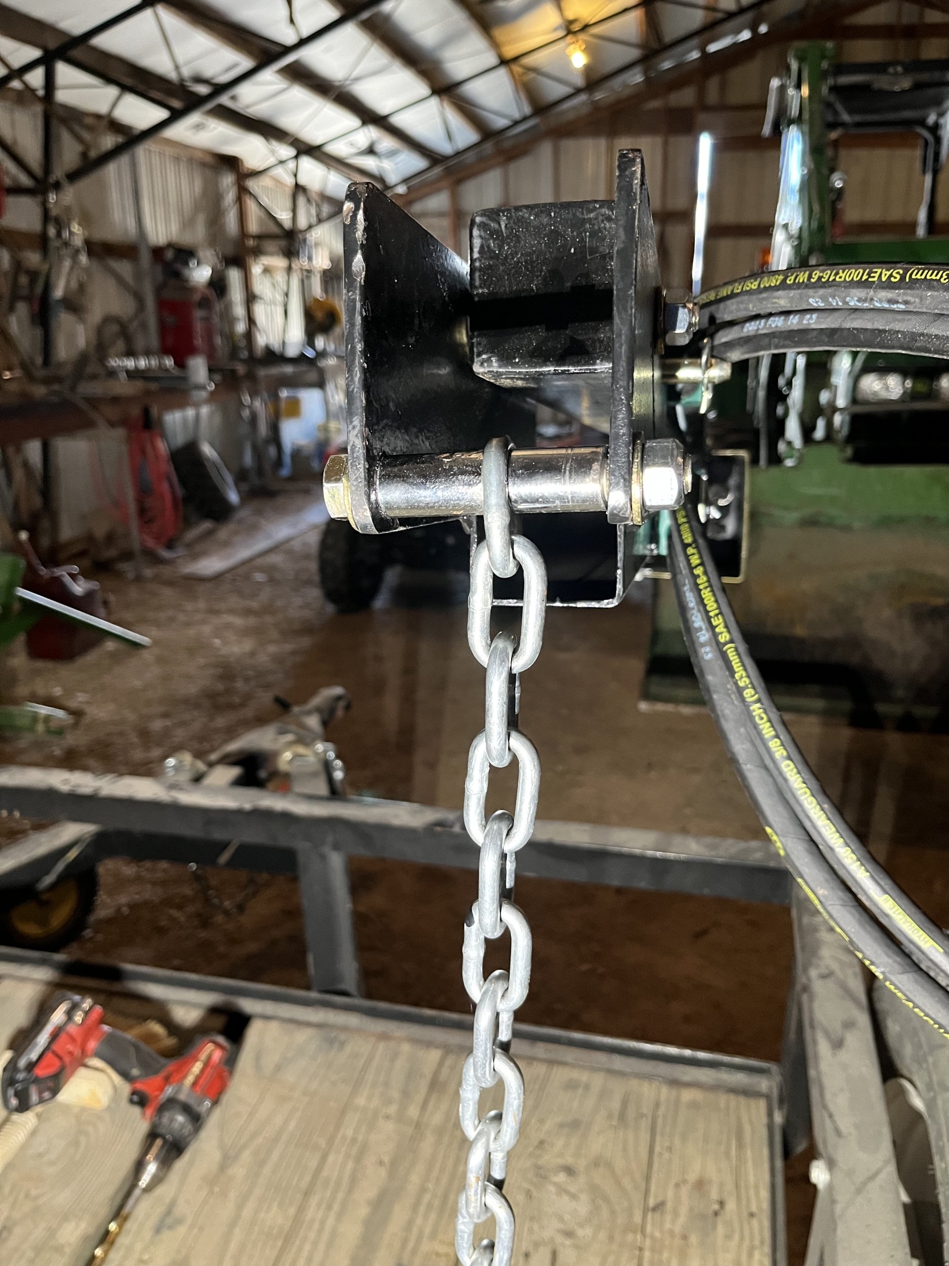

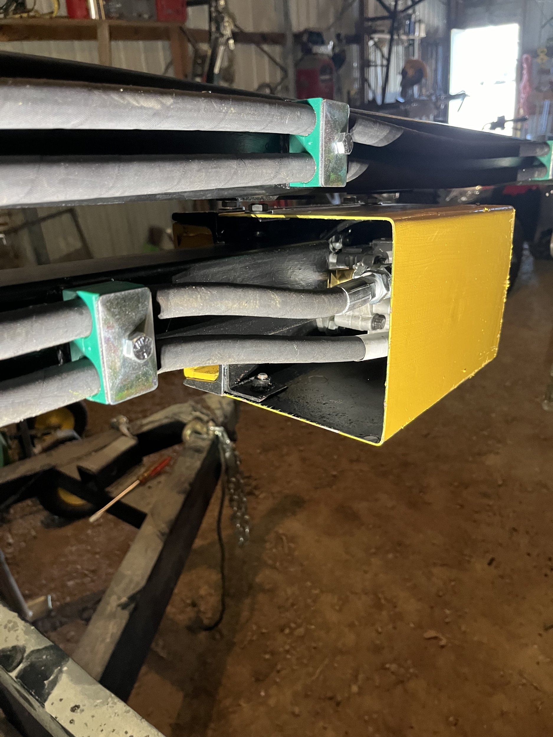

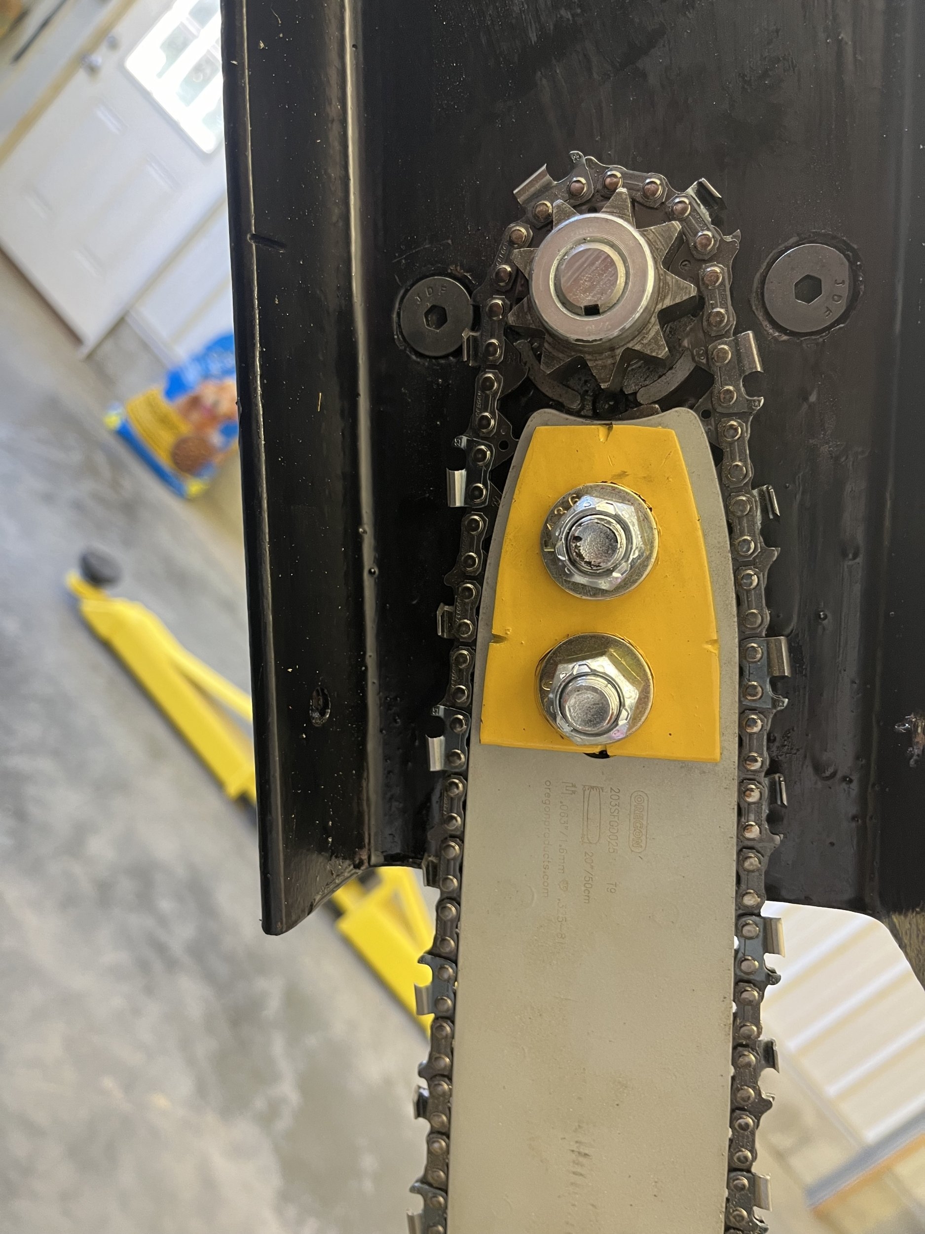

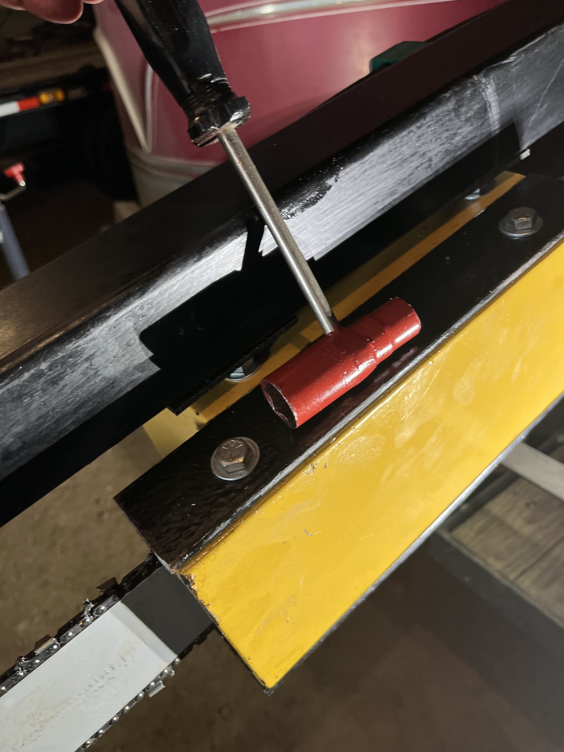

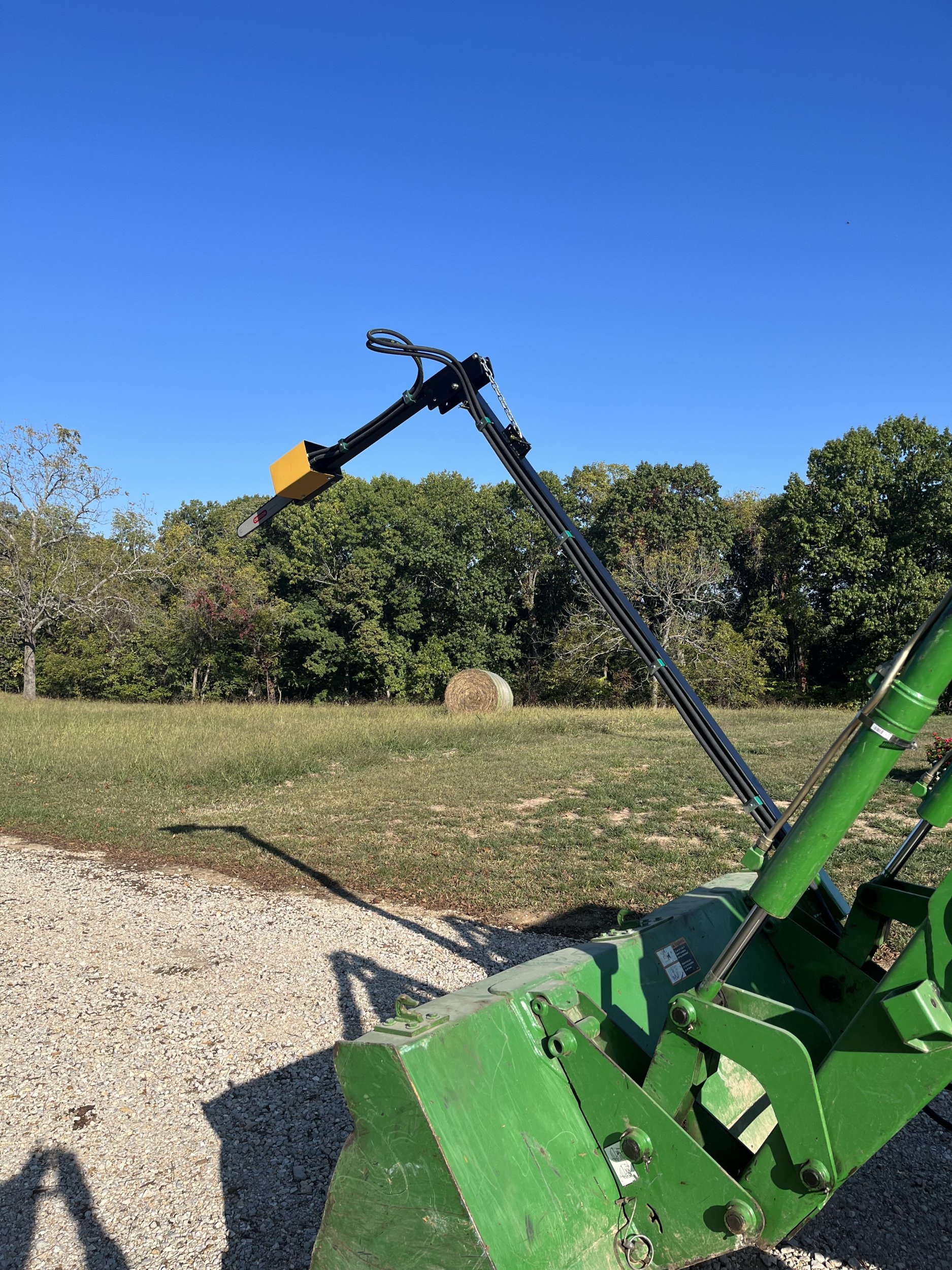

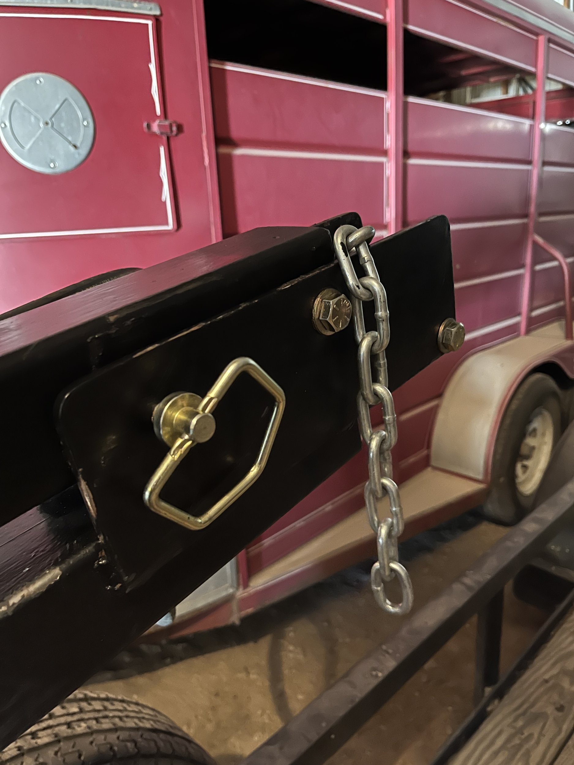

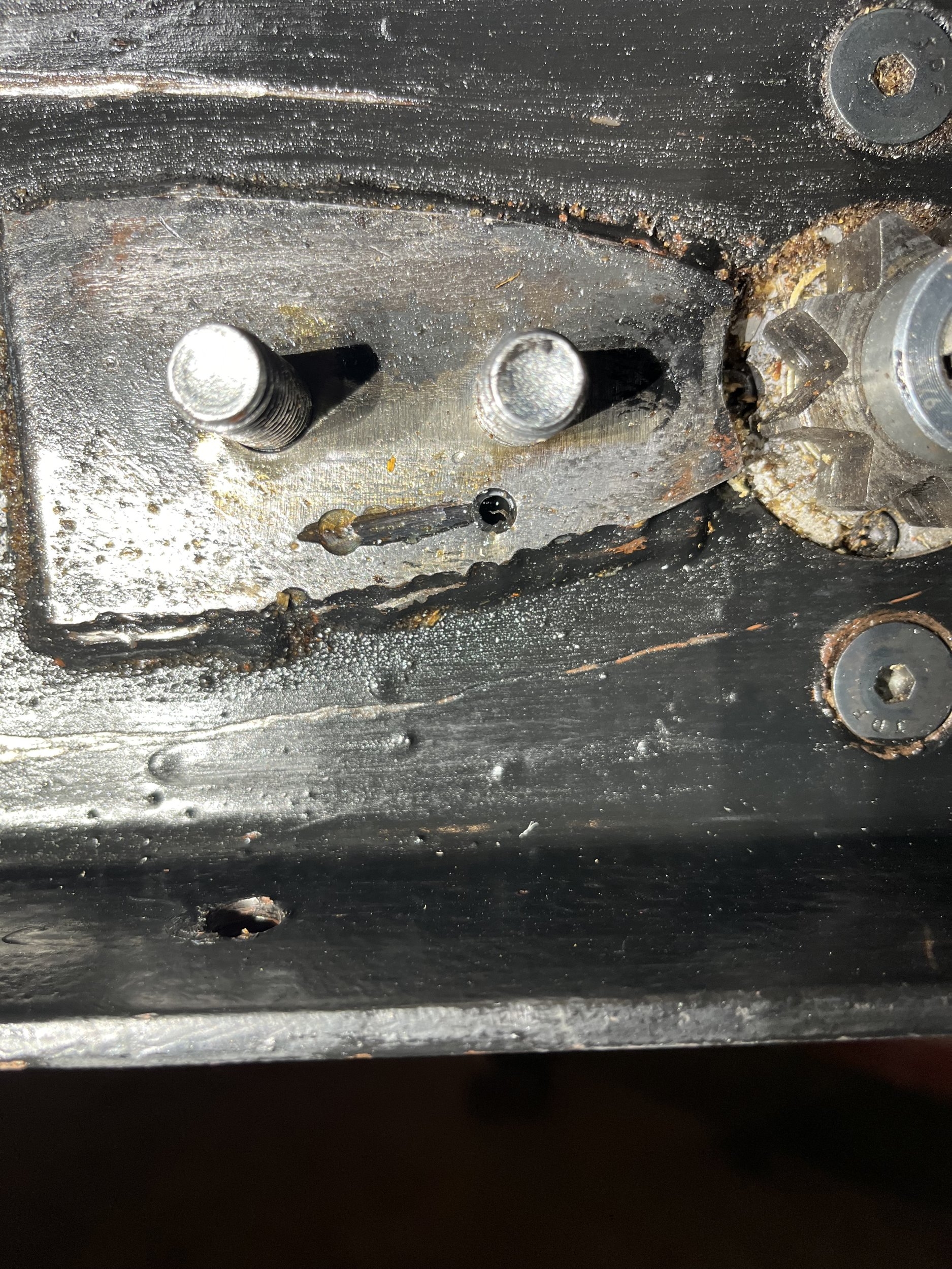

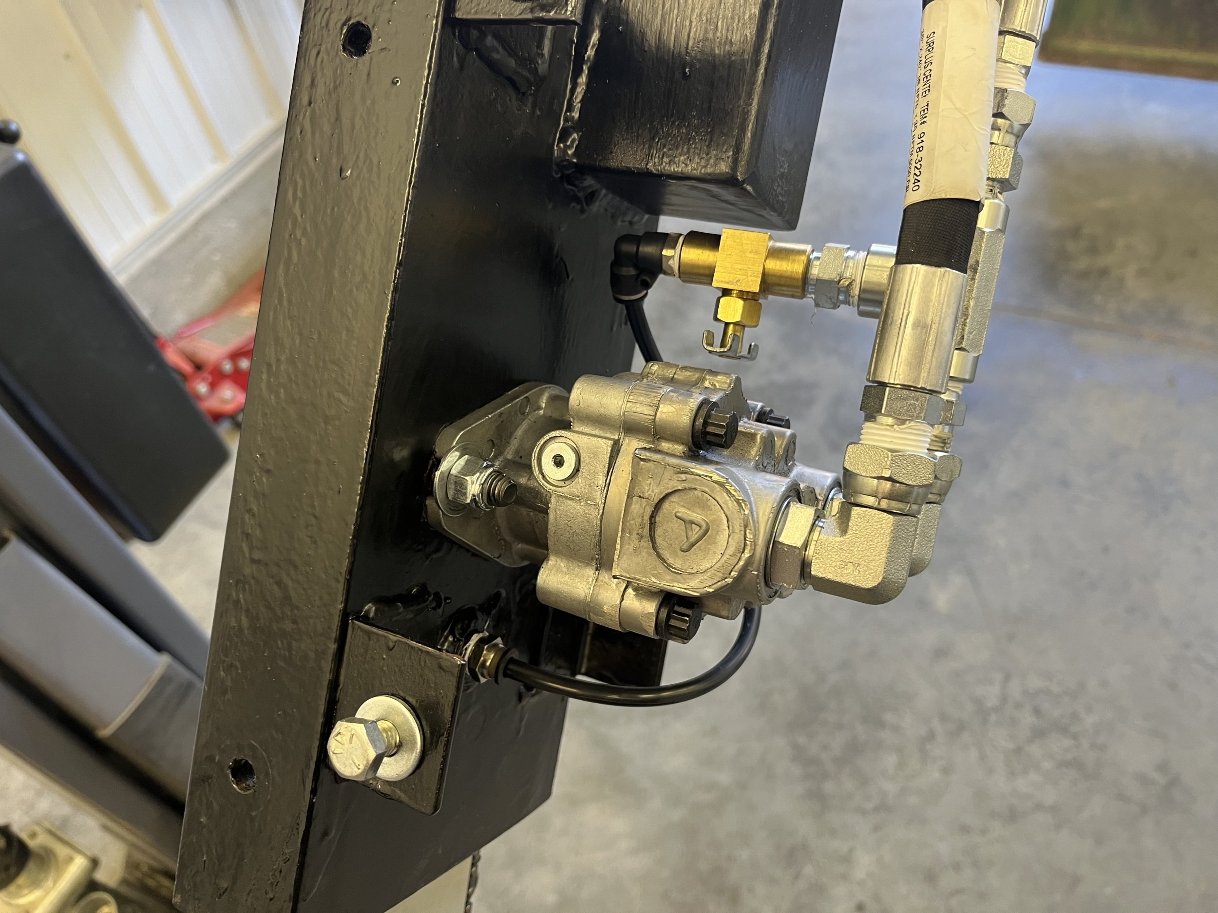

Here is my version of my homemade Limbsaw. Tho I've never seen a Limbsaw in person, I copied their design somewhat, and used suggestions from Smokeydog and jsjsteven which I truly appreciate.

That will work! Hope it works like you thought it would. Sure has been a great help and cost savings for us.
Don’t know if it is an issue or not. Surplus Center does make a locking metering valve with backflow check. Sometimes with fluid flow thru a tee, like in motor reverse, can create a vacuum Venturi. Could potentially bring debris from chain oil port into the system?
It takes so little oil to keep the blade lubricated that I haven’t noticed a much of a loss.
Enjoy and appreciate your feedback.
