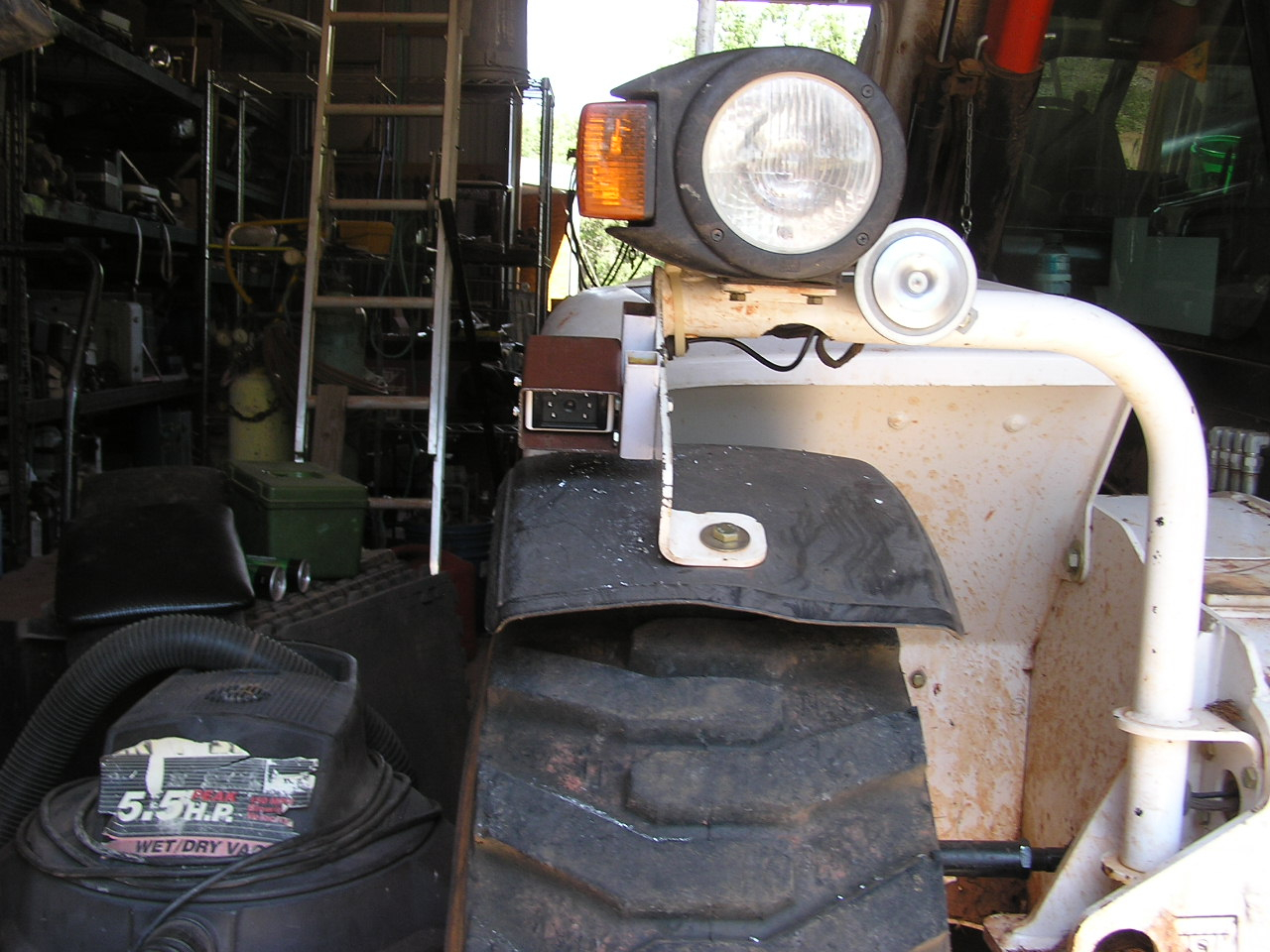

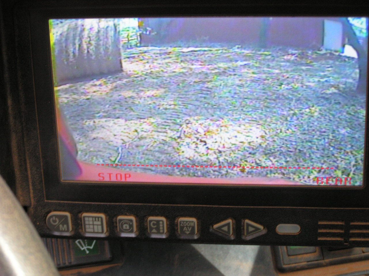

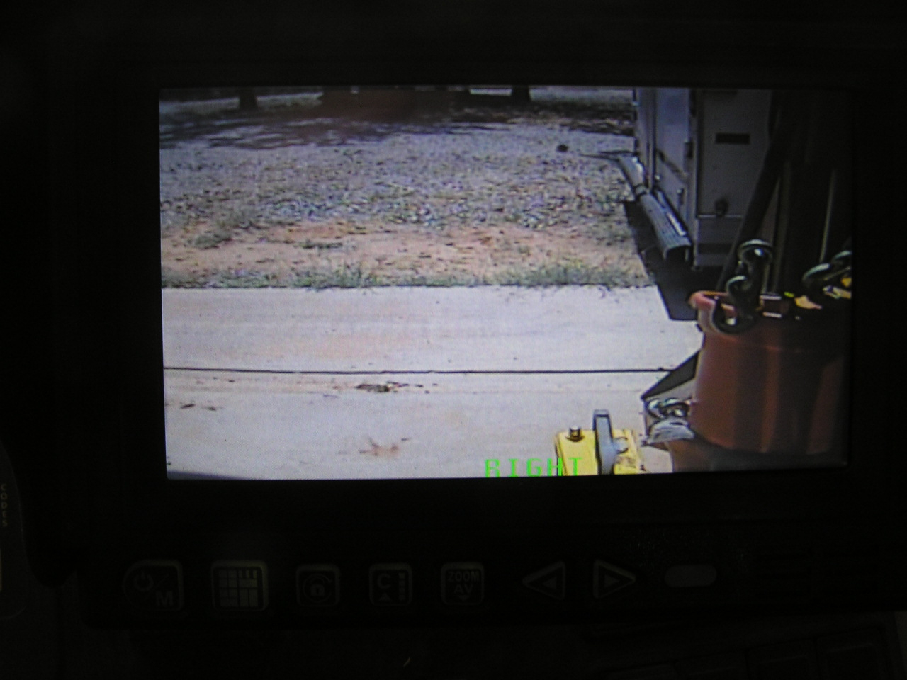

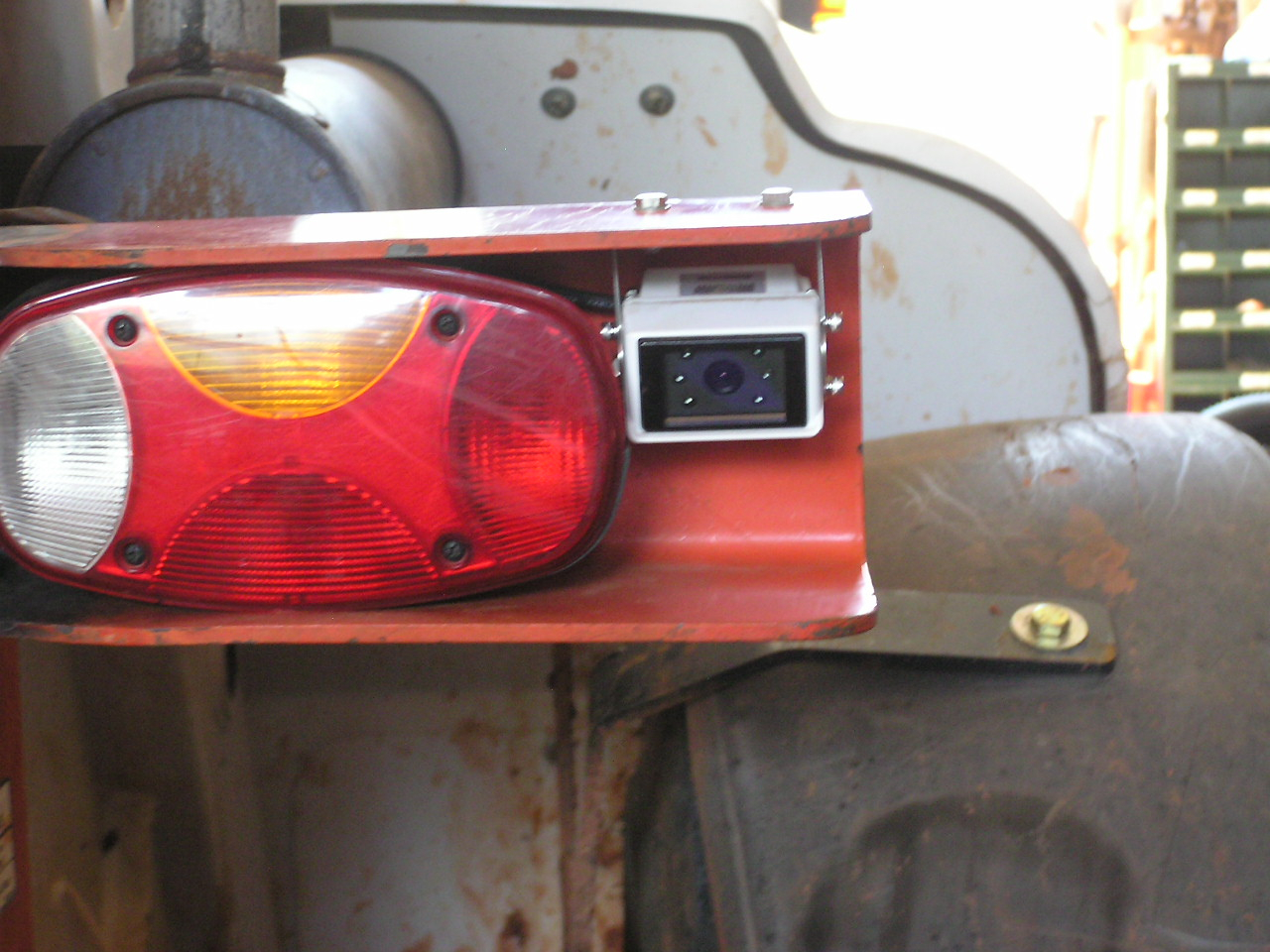

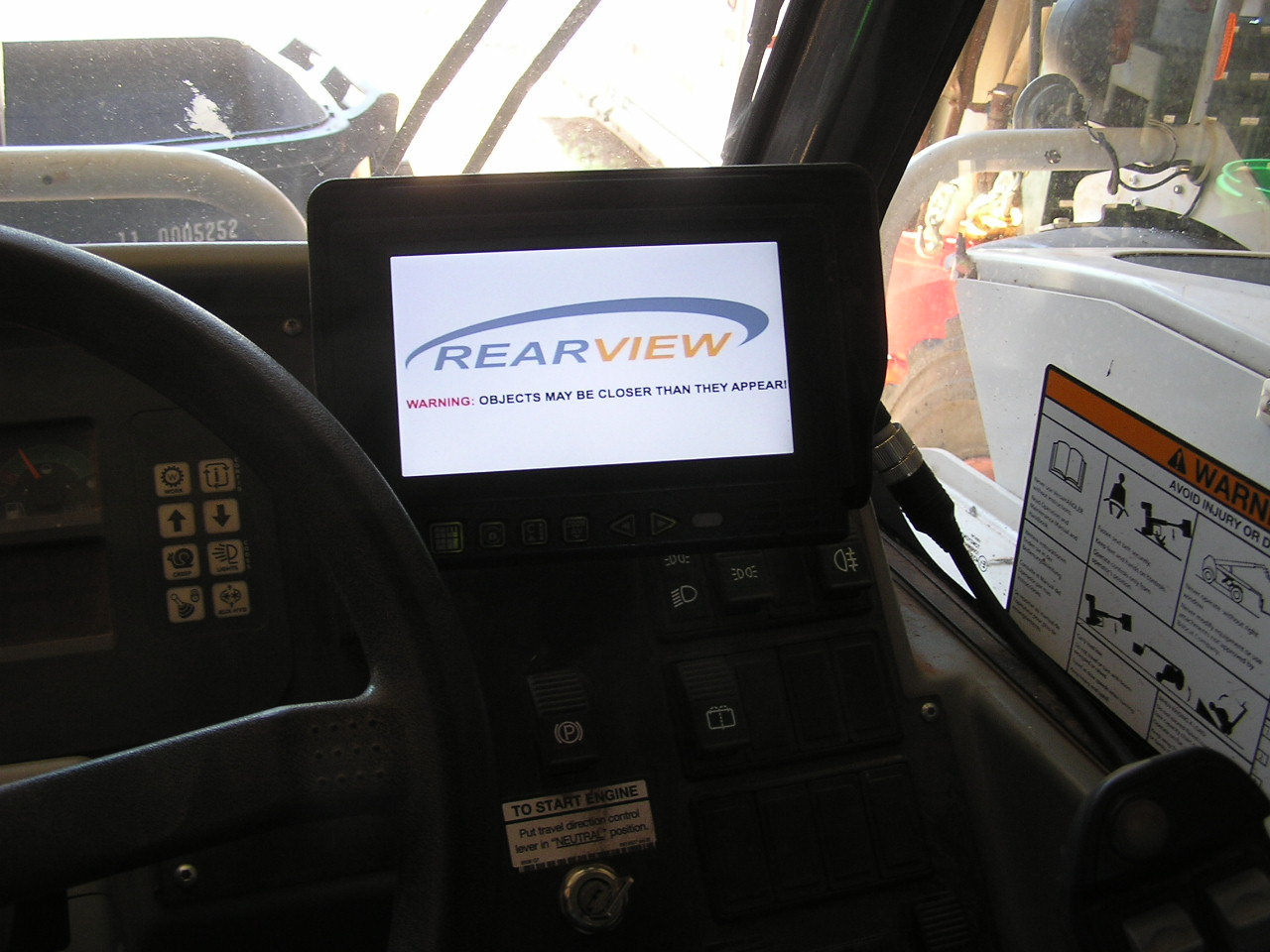

Got mine from https://www.rearviewsystems.com/ back in September of 2012:
View attachment 740266View attachment 740267
Mounted on right front fender:
The rear wide angle camera is mounted next to the right tail light:
View attachment 740277View attachment 740278
Thanks. They sure make nice, rugged industrial/agricultural camera systems. $pendy. They are only about 40 miles from our farm in Sweetwater, TN.

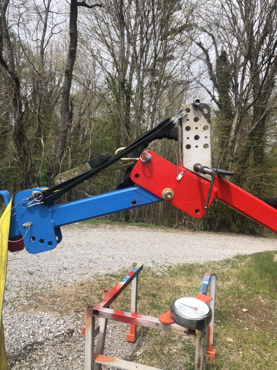

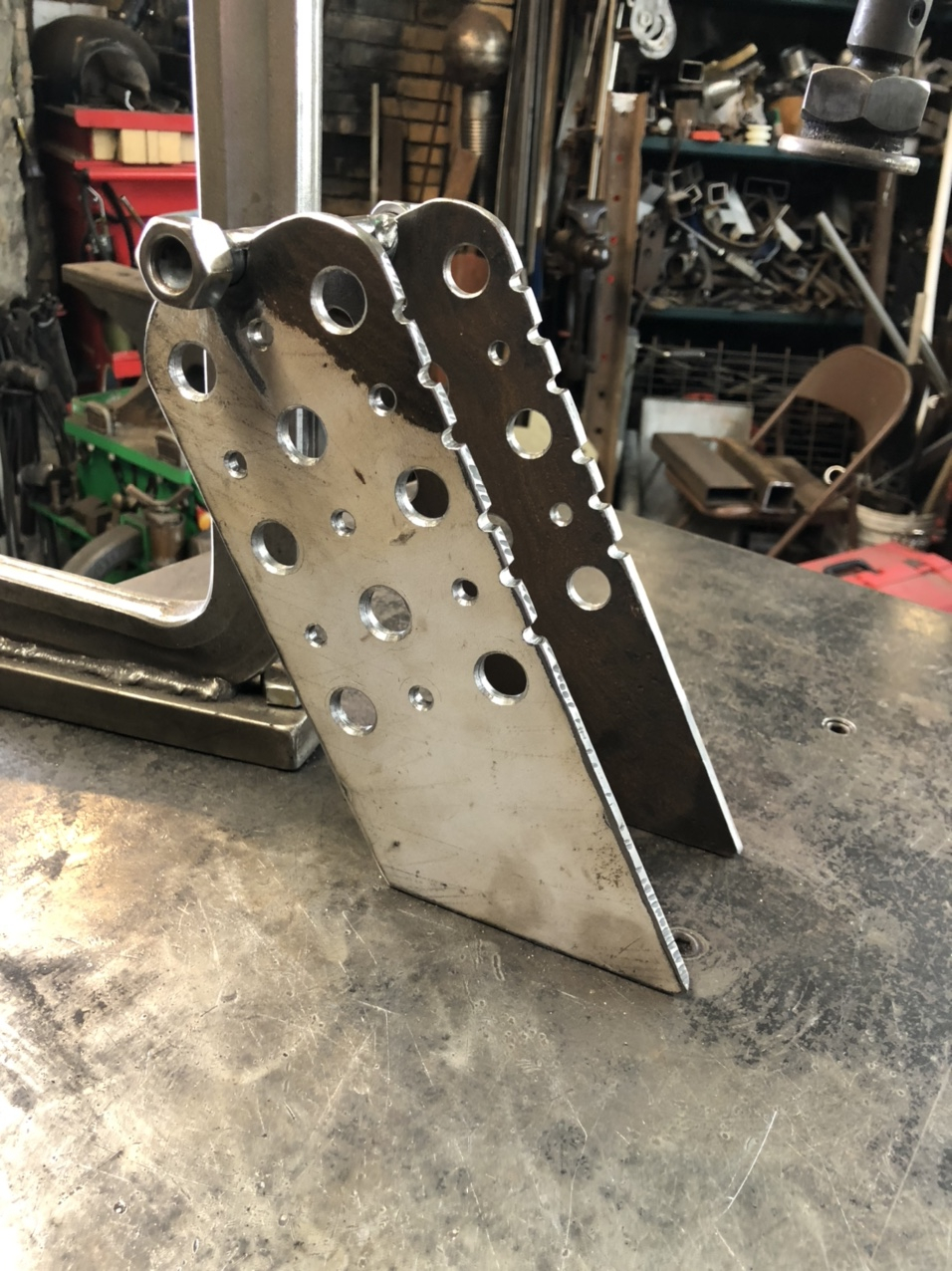

Made it a little bigger, longer and heavier structural steel.
Measured saw bar hinge weight with a produce scale. 36#.
Removed motor cover (18#) and reduced saw bar weight to 28#.
I could either skeletonize or remake the cover. 1/8” steel would be half the weight but only lose 4# on the bar. I’m a little MadMax medieval so I like my armor when fighting with tree creatures.
To use bungees to counter balance need better lever arm.
Four bungees gave 22#. About right.
Six bungees gave 17# and temporary clamp starting to slip.
Prepared and ready to weld later after one more eyeball test.
Do see where I could give some spring load to either side of bar for possible undercut.

Thanks for your reply. Not sure I fully understand the leaf spring patent for the saw application. The blue boom and red saw arm are not in the best position if parallel. 45* with some adjustability depending on the cut.
All bungees are not created equal. Ones used are 1.8X stretch, 15-27” range gives easy 15” travel to the blade. Gravity still pushes the blade thru the cut. The truck ratchet strap still holds the low position.
Reducing the bar weight should help with long term component wear. The hydraulic motor is very powerful and chips fly. That part of the build works perfect. Sharp saws require little weight to cut thru.
