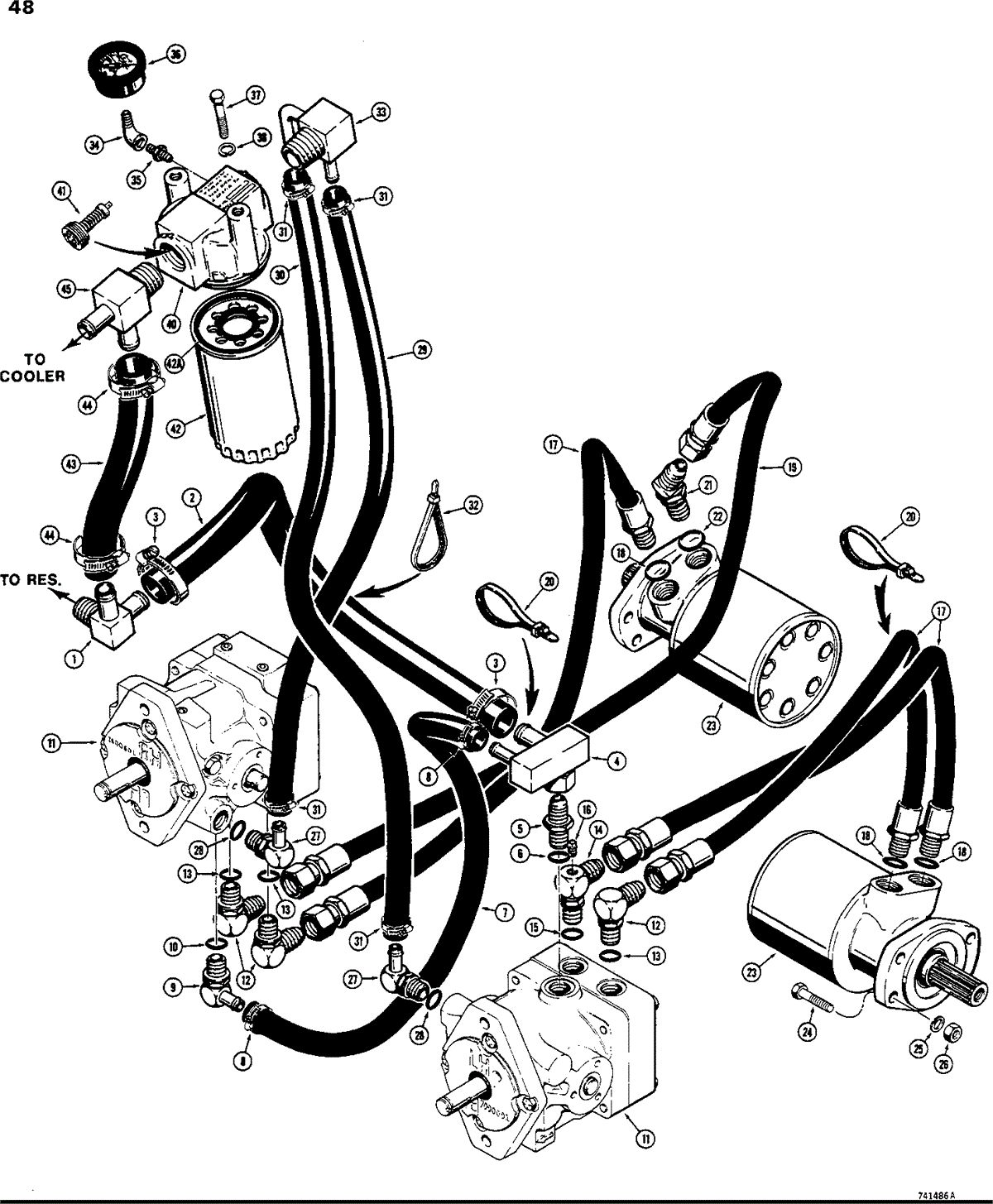

two variable pumps and two motors is exactly what a majority of skid steers have. The operator running the levers controls direction and speed by changing the variable pump displacement. Same principle as what most zero turn mowers have. Best maneuverability and performance and probably most money
Single fixed or variable pump driving a motor driving a differential with brakes to steer is also common. My guess would second best on performance and ease of operation.
Two fixed pumps trying to drive two motors could prove a challenge since feathering them would require a very good metering control valve and creates heat
One fixed pump feeding two track drive motors. On similar footing would probably track reasonably well turning or varying the speed or driving at less than full speed again requires a good control valve and creates heat.
fixed pump potentially more difficult to control and change direction depending on quality of the control valves. least cost of all.

If I could buy a used machine I would, however most want a lot more than what I'm willing to pay. My fabrication skills are good. I don't have much machining skills nor much for tooling to do that. Any parts I can't make, I'd ever find a machine shop nearby and pay for a part, or buy what I need in store or online.
Most of my fab skills is welding (went to college for it), so I have no issues there. My goals for this machine is to be able to pull a plow for gardening, tow a smallish trailer with wood or rock, dirt or whatever, move a 1000-1500lb fiberglass bass boat around in the yard when need be, and has the ability to move snow in the winter. I had thought about a simple hydraulic blade for snow removal, however a front loader would be a lot more useful.

Thanks, I did not know that. So I googled "skid steer drive circuit" and go this. Nice.
CASE-1816B-DRIVE-HYDRAULIC-CIRCUIT-HYDRAULIC-TANK-TO-MOTORS-TO-VARIABLE-DISPLACEMENT-PUMPS-0dKb-.gif
From here:
http://www.colemanequip.com/CASE/Im...TO-VARIABLE-DISPLACEMENT-PUMPS-0dKb-large.gif
