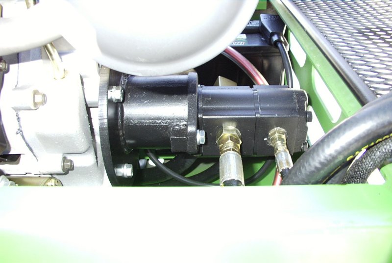

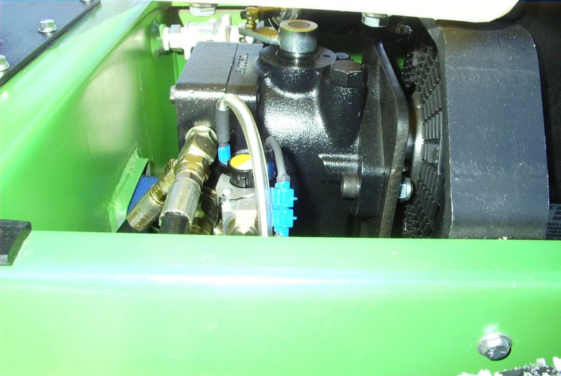

Here's a picture of my VVP on the front of the engine.
and the two PTO pumps on an adapter on the rear of my engine...
