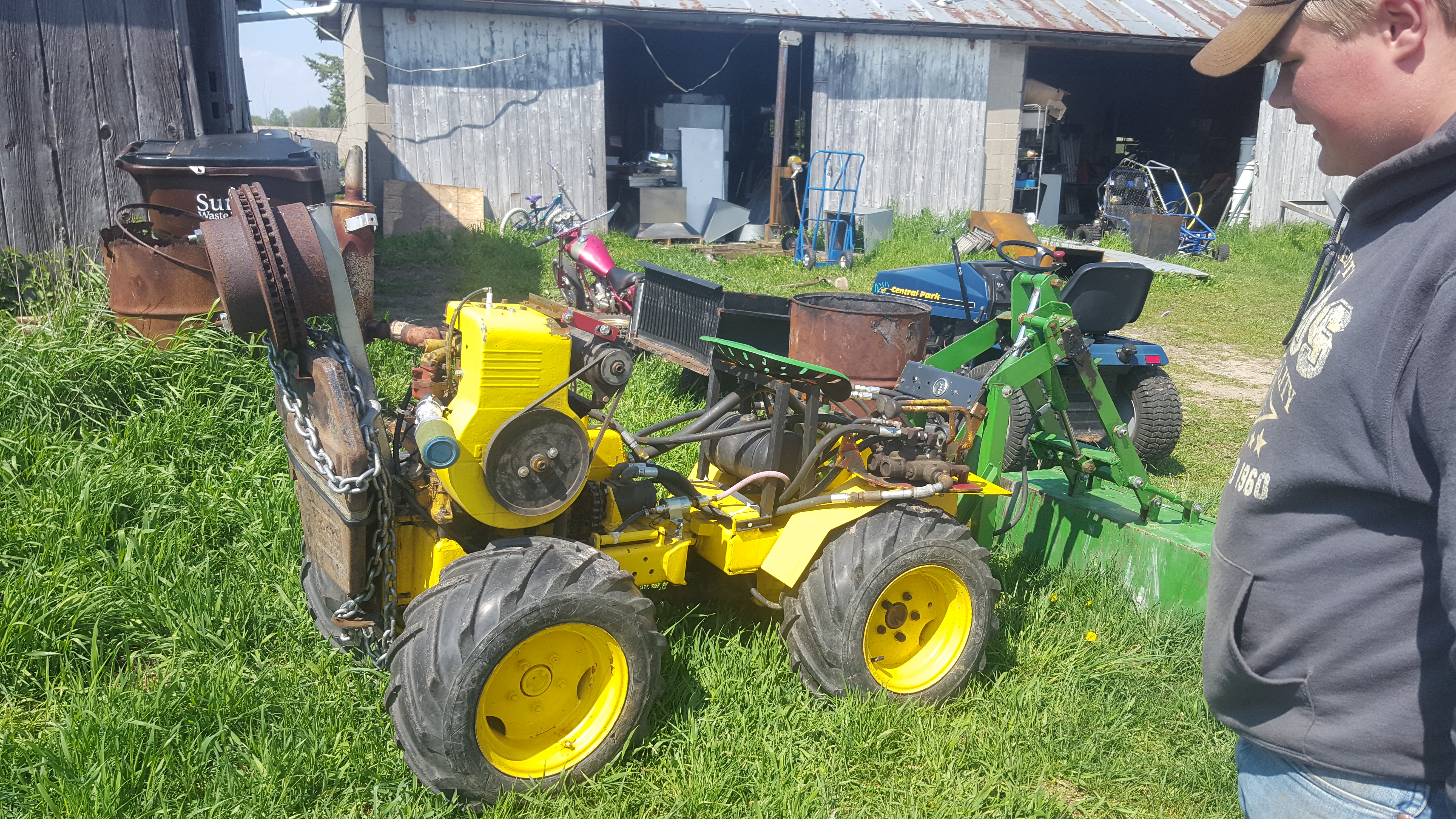

Just a thought for speed. My mini loader (custom built from a trencher) runs walking speed maybe. Complete pain in the @$$ if you have to go along a 1000ft driveway it takes along time. And you dont wanna be on it during the winter because its so slow and cold out
I would love to be able to go at teast 5mph. Another thought for you is something like it. Full time 4x4, all tires drive all time. But turning it wont rip the grass up like tracks and can find projects half dont for $500 around me here and there. The trencher already has all drive motors 1480857621742.jpg

My thing with wheels though is. They can slip when pushing heavy snow. While not a huge deal, the driveway goes down in to a ditch on either side and getting up close to the sides when even snow blowing, we have had snow blowers go in to the ditch and they are not fun to pull out.
I know 4wd would be easy to do, since I could do it with a chain and sprocket setup vs 4 wheel motors. Another thing is, up front we have very soft ground for whatever reason, and wheels do lose traction fairly easily going up the ditch, even with good tires. So I think the damage vs tracks would almost be the same. Like I've mentioned, I'll probably make rubber pads for the tracks to help minimize damage.
I could get SK500 or SK750 tracks, which would work nicely, just would have to have custom sprockets and bogies made for it.
