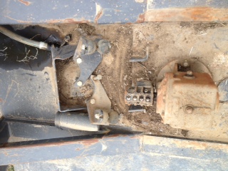

My quest for answers has led me here...I am a new member, any direction would be GREAT ;)
I bought a Bradco BC72 rotary cutter (72 shredder) for a skid steer. Got it used at an auction, missing the hydraulic motor. So, this is where things get fun...It was originally built as high-flow unit, but I need to convert it to a low/standard flow unit. Most of it痴 life will likely be spent on a New Holland L185: 3,000PSI, 19.3 GPM, 74hp.
I contacted Bradco and they weren稚 very helpful. Not too interested in helping me solve this problem. Bradco told me that it wasn稚 just the hydraulic motor that was different. I have found and downloaded the entire parts manual for both the high and low flow models. They have two different gear boxes...Omni Gear RC-61 and RC-51, the 61 on the high flow, the 51 on the low flow. Well, I assumed they were going to be different gear ratios; however, that is not the case! They both run a 1:1.93 ratio and they both have 1 3/8, smooth input shafts, with half inch roll pins. So, the only important difference is that the 61 (on the deck I have) has a higher horsepower rating then the other one. They also used different motor mounts for the two motors, presumable because one was 2 bolt and the other 4...no biggie, I知 a decent fabricator.
I have found the Bradco part number for the original high flow motor (17.9cu.i.) and the Bradco part number for the Standard flow motor (10 cu.i.). I did contact a company that sells Bradco parts and they wanted a pretty ridiculous amount of money for their low flow motor. What I cannot get are the specs for the low flow motor, other than the 10 cubic inches.
I contacted Surplus Center and tried explaining and getting assistance on this...yeah, not so much. They wanted engineering specs that I couldn稚 even begin to give them. Apparently, I foolishly thought they have sold similar motors for other rotary cutters before.
I have tried contacting other manufactures of skid steer mounted shredders, simply to get brand and part number of the motors they use and prices if they will sell their motors...only one has helped. This places uses a Parker TG0140AS030BBBC (8.6cu.i.) on their 72 cutter. This one has a smaller tapered output shaft and will not mate to the coupler that I have.

This is a photo of the Gear box and coupler I have.

The picture does not show much.
You can get different couplers to mate two devices.
You simply have to find a motor that will mate to your gear box of make an adapter.
Lovejoy is the one coupler I am thinking of.
If your gear box has a 1 in shaft, and the motor shaft is 3/4 in, then if the motor will mate to the bolt holes, you find a coupler that will join the two shafts.
The bracket that holds the motor might even be adjustable, and therefore will fit many different motors.

Thank you. Sorry about the photo, just trying to show how the gearbox has the coupler on it. The originally motor set up would have the out put shaft slide directly into the that coupler...using a 3/8” key. Coupler has allen-head screws that clamp it down on the two shafts. I will have to look into this Lovejoy coupler. I have also found a few pictures, on this site, of the chain/sprocket couplers. Do they make those large enough to hold up to 6’ shredders?
I haven’t been able to find a hydraulic motor with a 1 3/8” smooth shaft yet.
