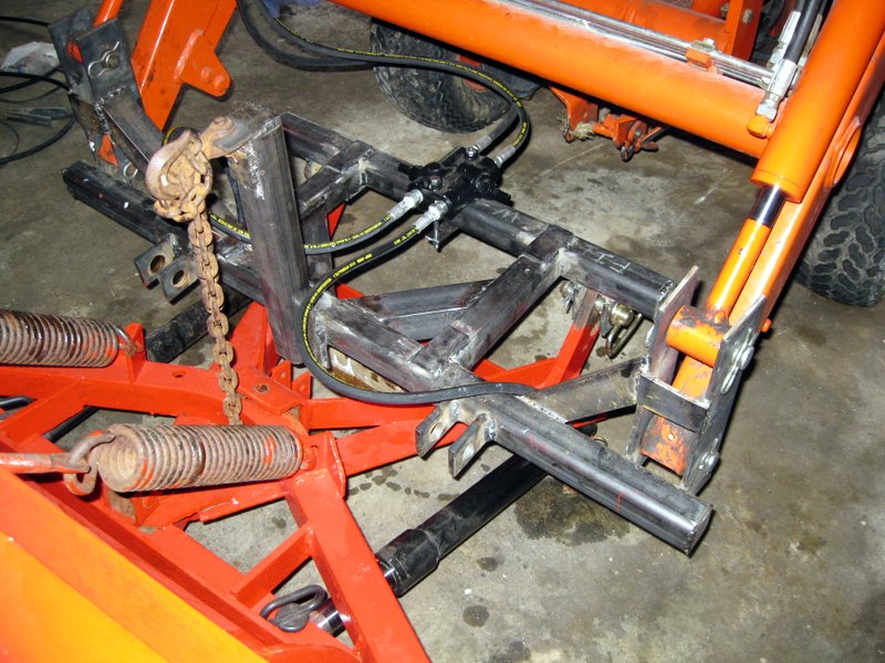

Does anyone have a photo of a fully plumbed cushion valve? Much appreciated

JJ, I spoke with a rep from Surplus City and I’m going to order the PTO Drive Motor and the cushion valve (DRV). Again, this is going to spend most it’s life on a low skid steer loader...only two hydraulic lines running to it. I have no experience with the high flow machines, but I do believe they have a third line for case-drain...but I am speaking on assumption. I have also never dealt with any cushion valves.
The photo of the DRV mounted to the winch isn’t very clear to me, as I don’t understand it. In my minds eye, there will be two short lines running to one side of this DRV and on the other side will be the two long lines with flat-faced couplers to attach to the skid loader. Does that sound right?

After tons of surfing, I found this photo (here on TBN) of one on a snowplow set up.

A cushion valve is there to bleed to the other side.
A relief valve usually sends the over pressure to tank.
Keep an eye on the hyd fluid temp when running that motor continuously.
Some hyd motors use case drains, and that goes directly to tank.
In the winch picture, the DPOC is across the hyd motor.
