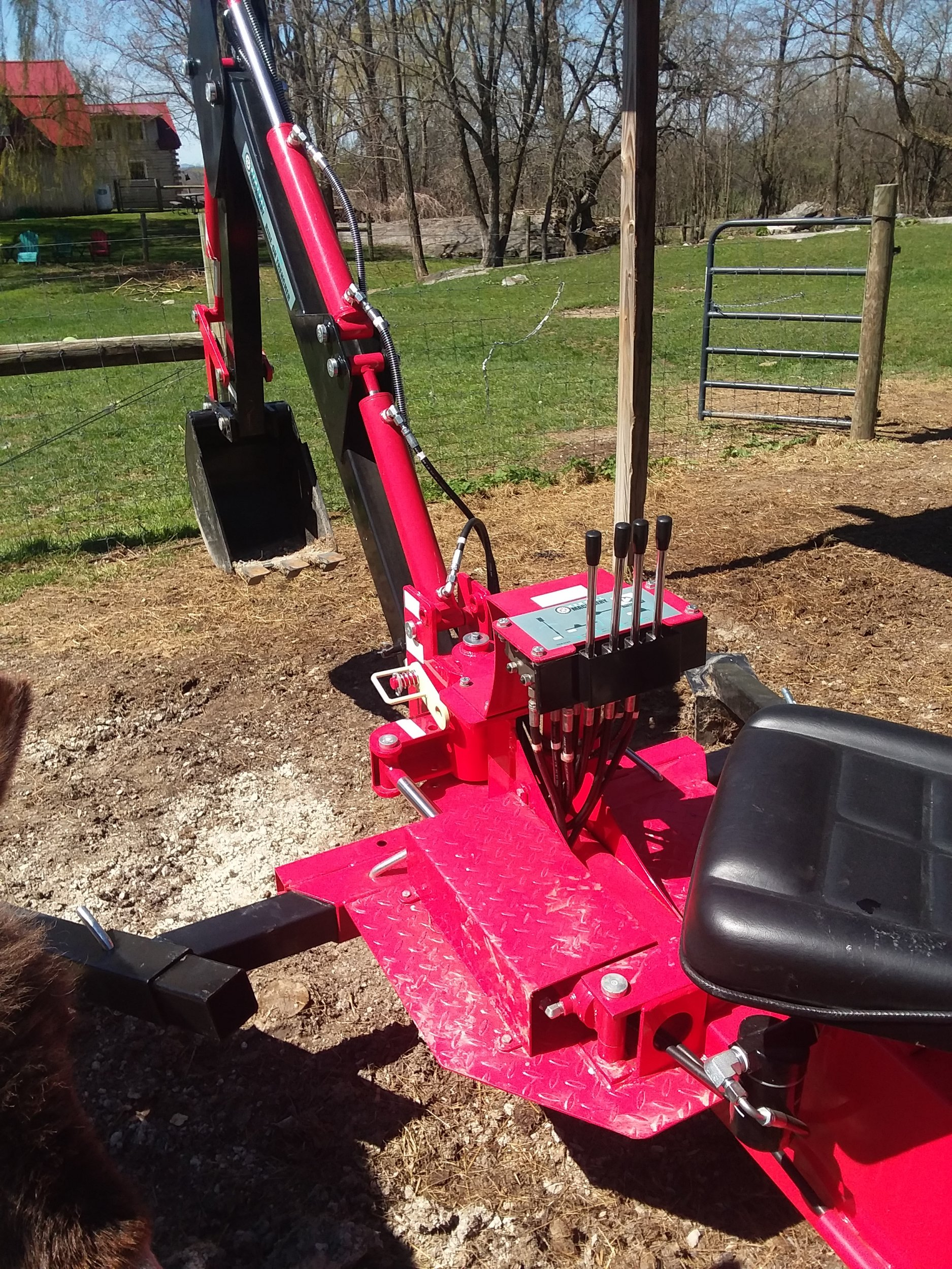

three more...

   / hydraulic operations suddenly gone. #12
Never seen a shaft coupling like that. Looks like 1/2 of something. Does the suction line have wire reinforcing to prevent collapsing? Looks like plain old heater hose but may be something else. So the engine sounds the same now as it did before when it was working? Sounds the same when attempting to operate any function? As was mentioned, plumbing a pressure gauge between the pump and valve would be useful. Are you absolutely sure the pump is turning when you are putting a load on it? Coupling slipping? If you can't watch it, make a match mark on it and try it. Shut it down and se if the marks still align.

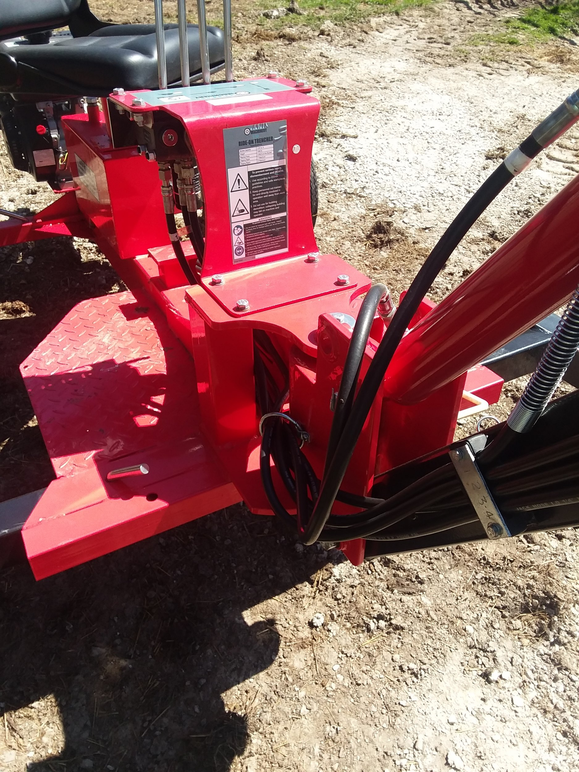

   / hydraulic operations suddenly gone. #13
three more...
Is your middle picture the drive to the pump?
If so with the engine running at an idle is the shaft rotating and the coupling rotating and the rest of the shaft to the left.
Two ways to start, that unit doesn't hold much hydraulic fluid, disconnect the outline of the pump and direct it into a bucket
start the engine and see if you get good flow under some pressure, if no flow or minimum flow check the suction line for an inlet screen.
Also if you are getting flow with the engine just off of idle operating a valve to full should stall the engine if it's pumping correctly.
