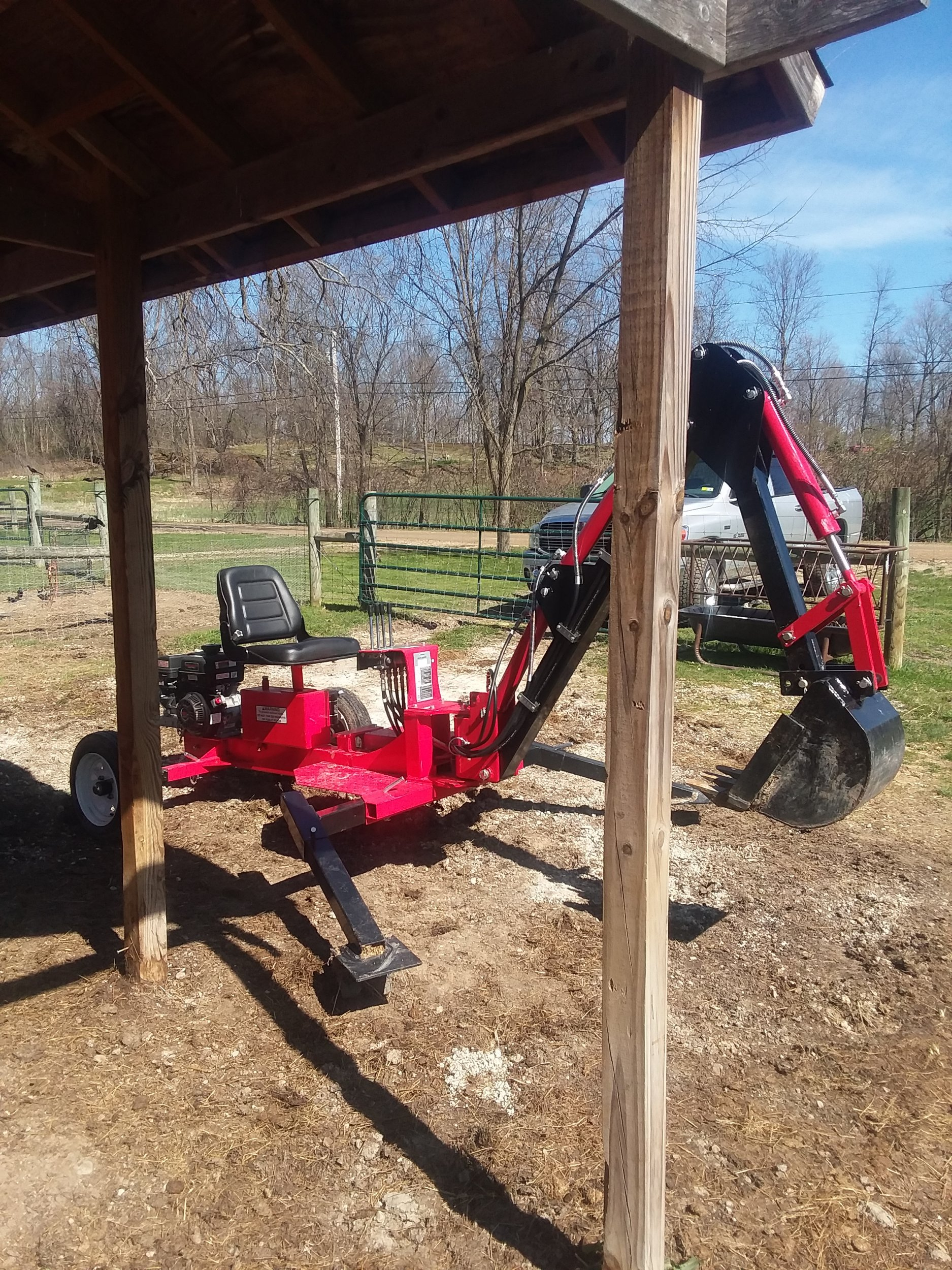

Central machinery 9hp trencher
I was operating my towable 9hp trencher/ backhoe to move manure from under the winter shelter that my livestock use and I shut it down to eat lunch. When I came back to it the unit suddenly has stopped operating. The controls are fine but no action. Well, almost no action, I can get the boom to move outwards very slowly and traverse very slowly but nothing else. The 9hp Predator motor runs like a top and the jack shaft to the pump is spinning. The hydro reservoir is at max full and there are no leaks. I have been using this equipment since new last summer. Love the machine, it does everything I need it do. No issues till now.
Possible problems I have come up with are:
A shear pin snapped?
Air in the system?
Dirty filter or screen somewhere?
Does it need to have each boom cylinder bled again.
I need this fixed, it's sitting right in the middle of the way, in front of my barn! lol.
Thanks in advance for the help!
Ghost.

It was fine when I shut it off to go eat. When I came back it wouldn't build enough hydro pressure to move the boom. After awhile it di move, slowly. once I go it back onto more level ground it picked up speed a little and I was able to move it out of the way. The tank dipstick reads max full. the drive shaft to the pump is a sold shaft right off of the engine. I'm thinking it's a blockage issue in the spin on filter maybe. The keyway shear pin is okay. It acts like it either has air, or is blocked partially. The boom and bucket is suspended in mid air and not sinking so there is that.

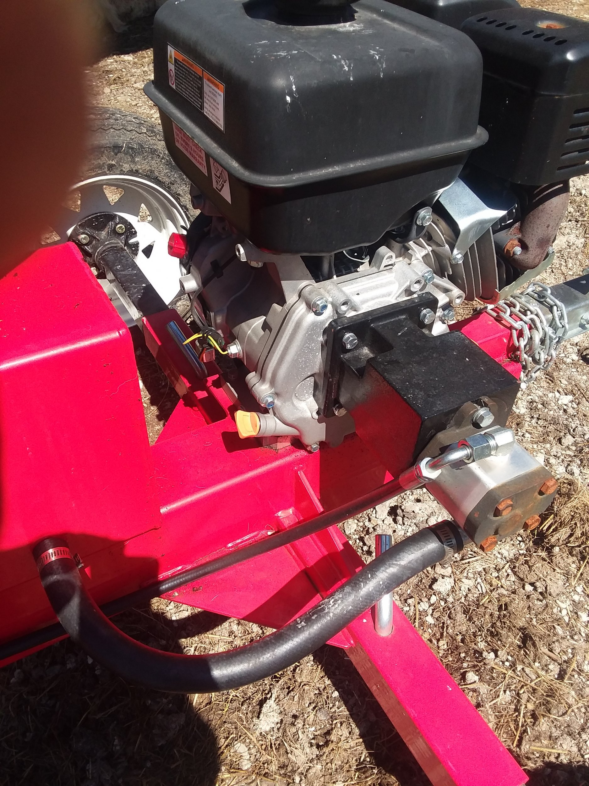

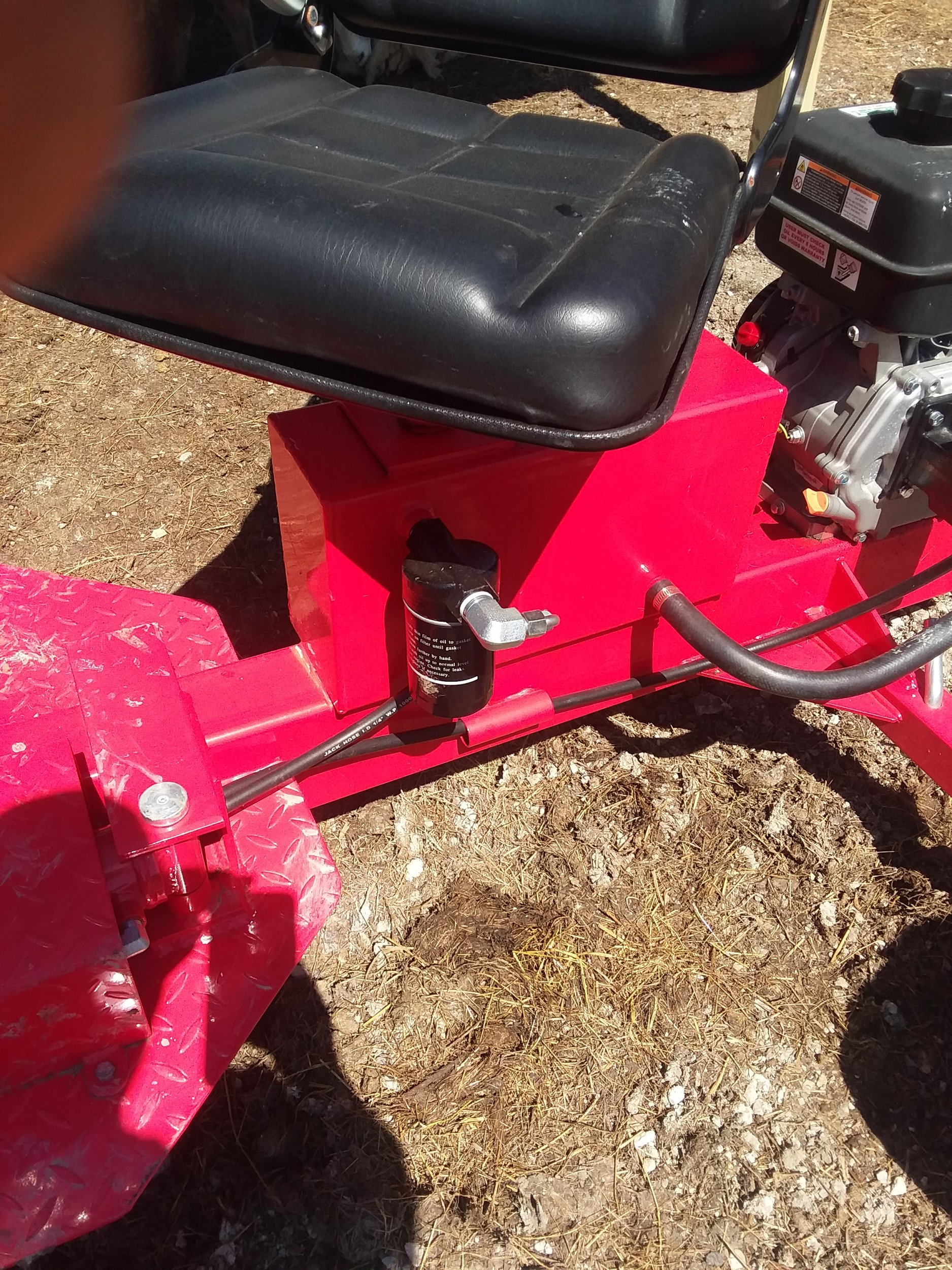

Filter should be on the return side so I don't see that being the problem. Maybe a collapsed suction line? Does the engine labor at all when trying a function? Could we get a picture showing the engine to pump connection and plumbing?

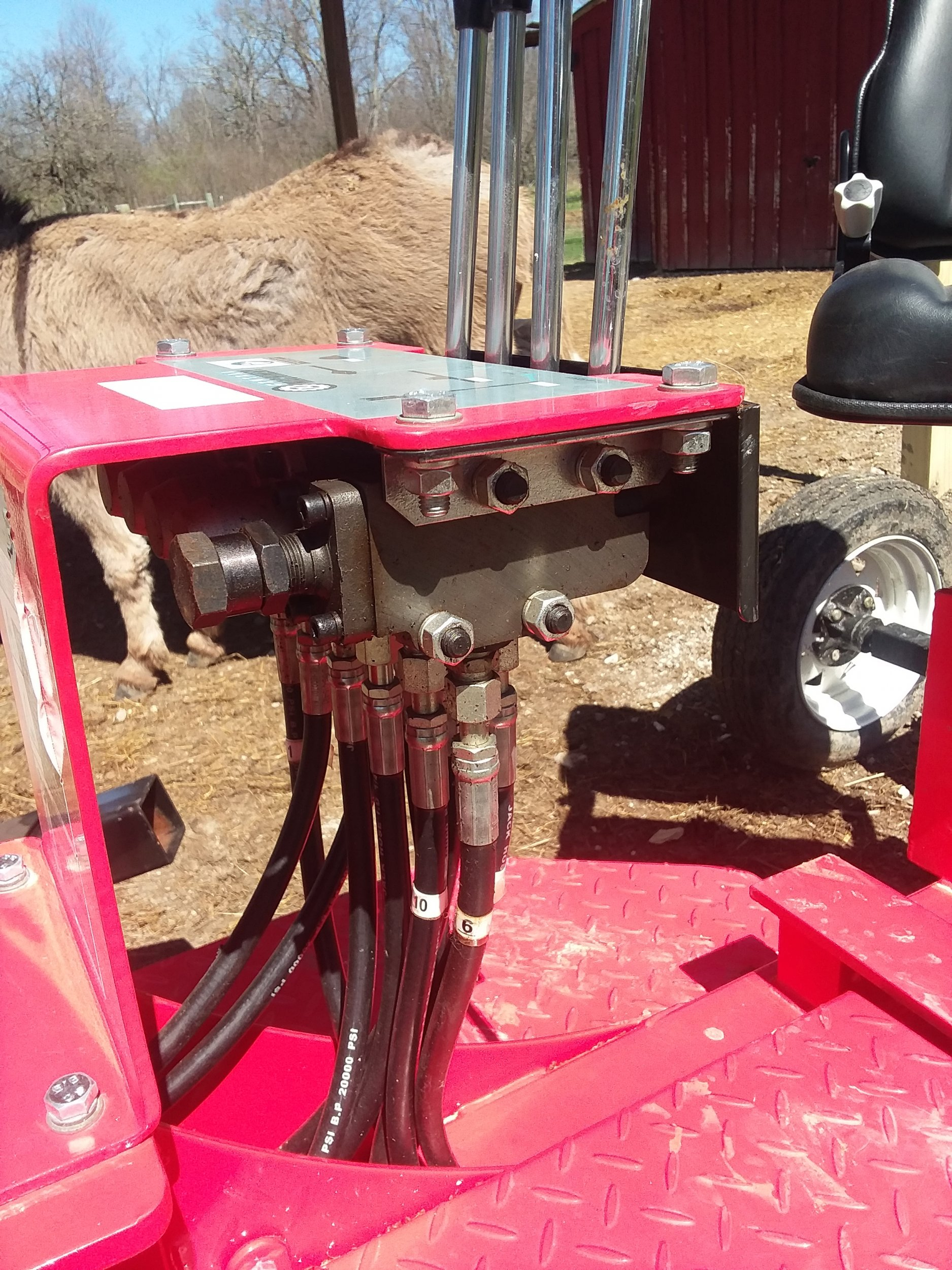

Given your description, something changed suddenly. So something like a relief valve stuck open or a quick disconnect got dislodged, or some bypass valve got opened, or a detented valve is in detent position, or whatever.
It looks like the lines are hard plumbed, I would pick the easiest line going back to tank and disconnect it, then turn the engine on and see how much return flow you get. I would wild guess for that size thing you should be in the range 5-15 GPM. If it just trickles out, then you know there's a problem with flow. If you have good flow the next step would be to measure the pressure. You'd need a gauge to check that.

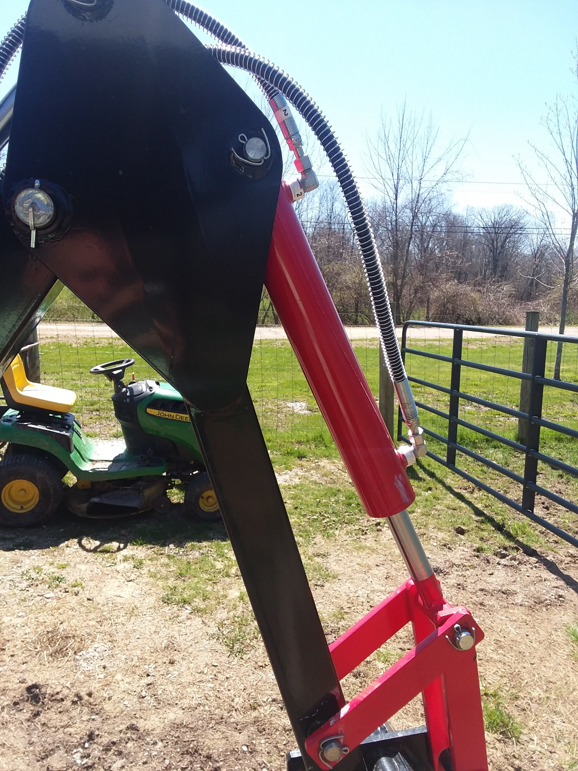

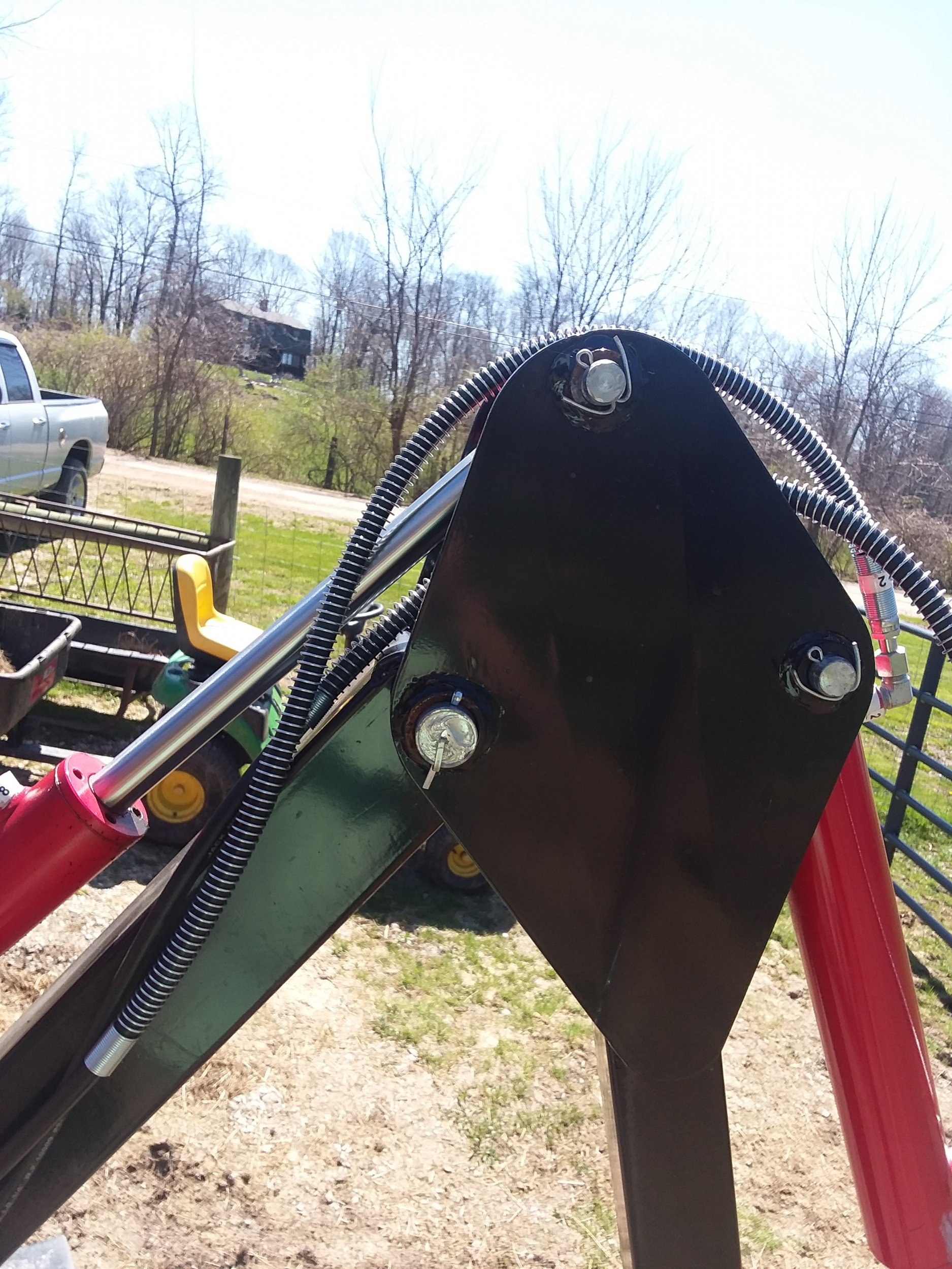

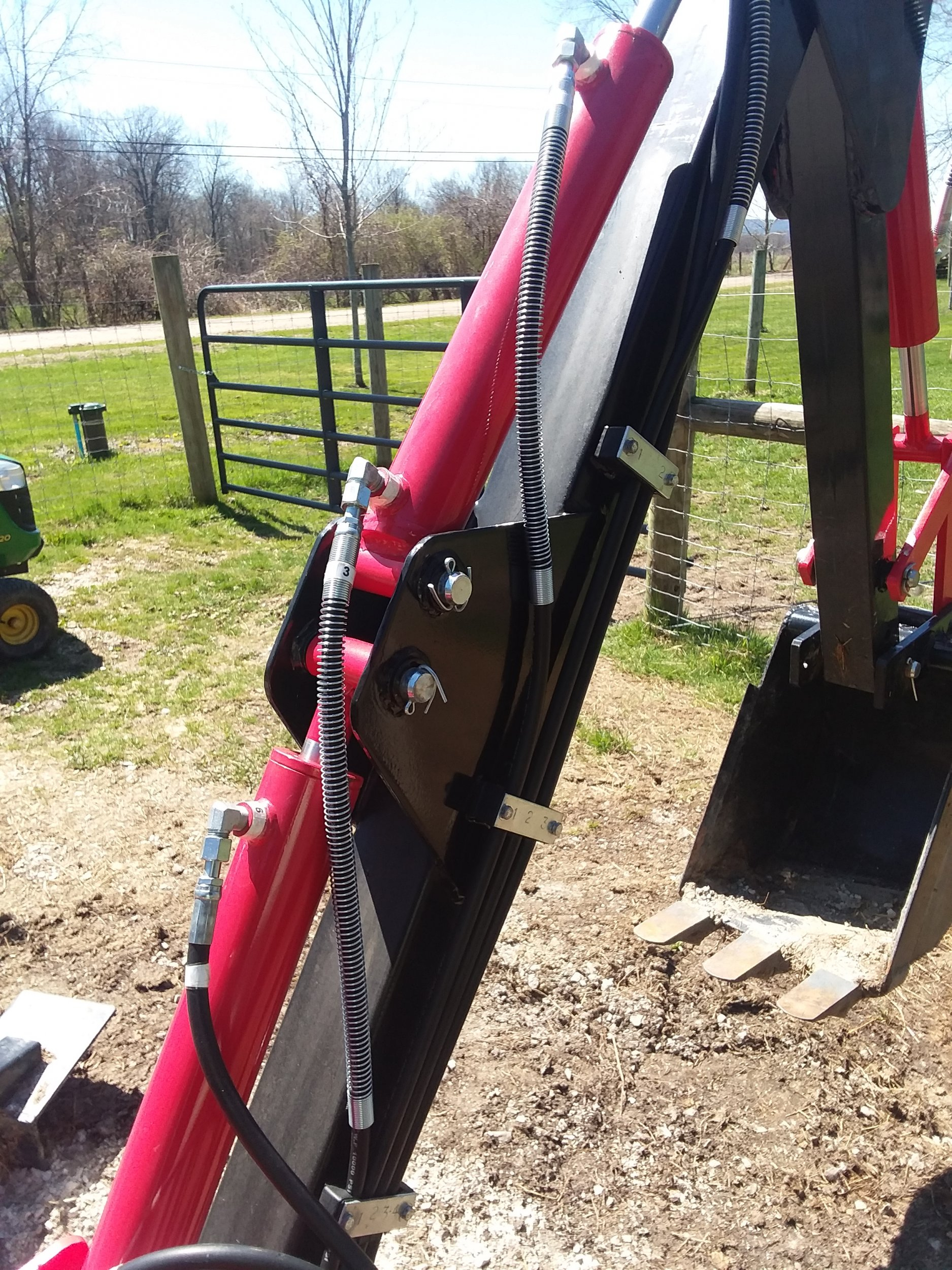

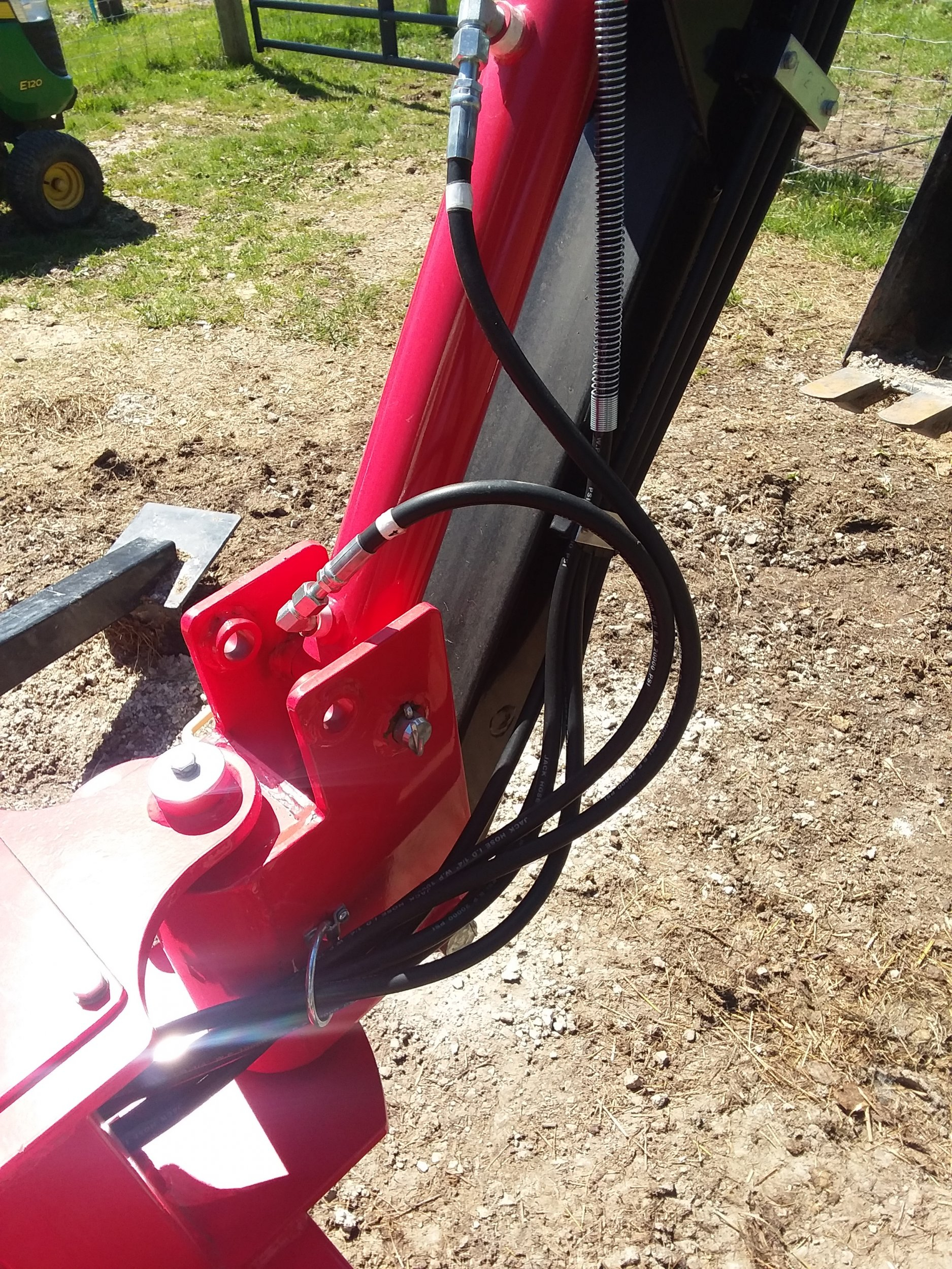

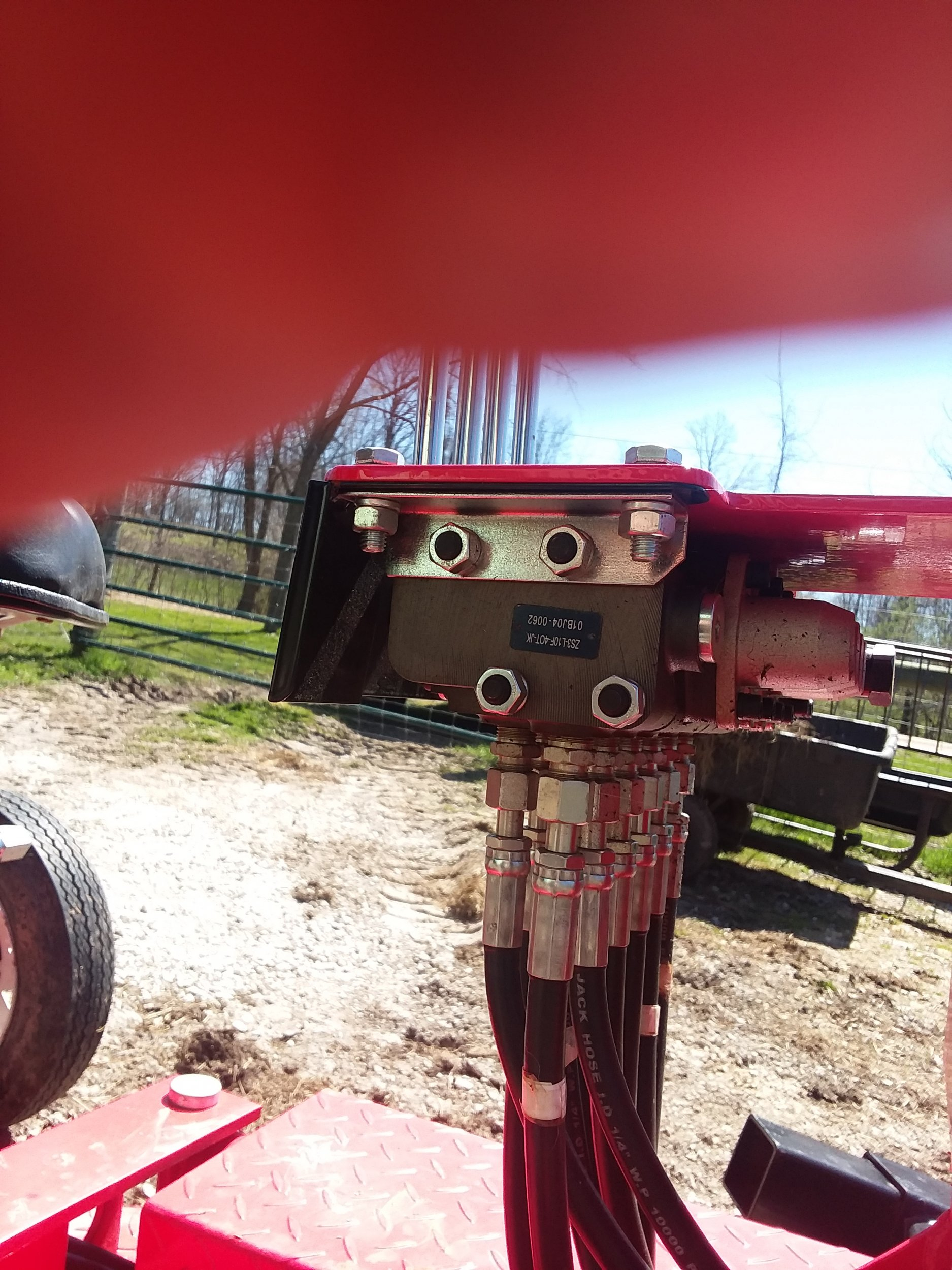

The boom does sink when the lever is operated. It just goes UP slowly. It's been hanging in mid air where I left it since yesterday and has not sunk. so, the hydraulic pressure is not escaping anywhere. Here's some pictures of the thing. I'm about convinced there's a blockage somewhere.

Never seen a shaft coupling like that. Looks like 1/2 of something. Does the suction line have wire reinforcing to prevent collapsing? Looks like plain old heater hose but may be something else. So the engine sounds the same now as it did before when it was working? Sounds the same when attempting to operate any function? As was mentioned, plumbing a pressure gauge between the pump and valve would be useful. Are you absolutely sure the pump is turning when you are putting a load on it? Coupling slipping? If you can't watch it, make a match mark on it and try it. Shut it down and se if the marks still align.

Is your middle picture the drive to the pump?
If so with the engine running at an idle is the shaft rotating and the coupling rotating and the rest of the shaft to the left.
Two ways to start, that unit doesn't hold much hydraulic fluid, disconnect the outline of the pump and direct it into a bucket
start the engine and see if you get good flow under some pressure, if no flow or minimum flow check the suction line for an inlet screen.
Also if you are getting flow with the engine just off of idle operating a valve to full should stall the engine if it's pumping correctly.
/ hydraulic operations suddenly gone. #14
The hydraulic pump coupling is exactly what I was asking about; it is a Lovejoy coupling and in my experience subject to failure. I would pull the pump and check the coupling before I did anything else.
I do not think any kind of blockage would cause this issue since it is not likely to happen after shutting down the machine. However, the sudden starting load on a coupler could be the cause of the failure.

I've used LoveJoys and others with the same design and it "kind of" looks like 1/2 of one. My bet is on the coupling too.
/ hydraulic operations suddenly gone. #17
I thought the same thing. I wonder if the shafts are held in the coupler by the set screws??
/ hydraulic operations suddenly gone. #18
It looks like two of the 3 pieces of that coupler are missing, unless I don't understand what I'm looking at. There's supposed to be a rubber shock absorber and another steel jaw that mates with the jaw in the picture. The question is where did those pieces go and how could this pump ever have produced pressure? The picture gets fuzzy to the left, maybe those pieces are out of view, or there's a way for the pieces to fall off the end of the shaft.
/ hydraulic operations suddenly gone. #19
I think it was installed using half of the coupler to connect the two shafts by either mating up the keyways (unlikely, but possible) or using the setscrews to tighten down on each shaft. This is usually impossible since the two shafts are almost always different diameters.
After mulling it over I'm not so sure it is the coupler since I do not see bits of metal in the pics, but it is so simple to check I'd start there. I would also put in the correct coupler with the rubber insert to absorb the start up load.

Stuck relief valve?
