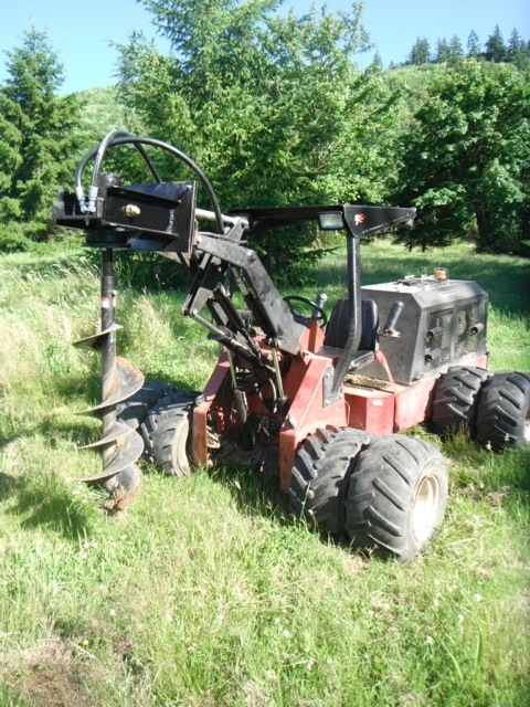

I built my own. Cost 1K all in. Used a wheel motor and hub, welded an adapter, bolted some bolts and it is the best darn tool for digging holes. This thing is a monster.
My tractor line is Hydraulic, there is a range of Hydraulic post hole diggers, from small ones for the machines with 4GPH to my size (18GPH).
Here is a picture of my results. Happy to help if you need more advice.
One other thing, I know very little about tractoring, and my first few post holes were not successful as they would fill back in. But then I learned something which was stop the drill when you get to what you want as a bottom, and lift it up (Auger not spinning) once it is out of the ground turn it on and fling the dirt off. Much cleaner holes.
As for bit size, I got a 12". A 14 would have been better in hindsight. I wish for a whole set of augers up to the 36" but I have a mortgage to pay. I think one 14" bit would be more than enough. Forget the 9"

RD - This was a DIRT SIMPLE Build. You could do this, trust me. Even if you can't weld you probably have a neighbor who can. I took my motor down to the machine shop, showed them my plan. The guy walked over, grabbed 4 feet of C Channel, made 3 cuts, Grabbed a torch and cut the hole for the motor, grabbed a drill and drilled out the 7 holes I needed and handed it all back to me.
If you are bucket attaching this, it is even easier.
I guess a 9" would be great for posts. i bought the 12 as it was a good all around. The more I think about it a 9 and a 14 or a 9 and a 16 would be ideal.
I have planted over 200 trees with the PHD. I can cram a 5 gallon into a 12" hole, but the wife wishes it were bigger (the auger) for root growth as we are in clay for the most part. The big potted trees (24" or larger pots) are planted with a back hoe. I can go on sever slopes with my backhoe so it works out well.
