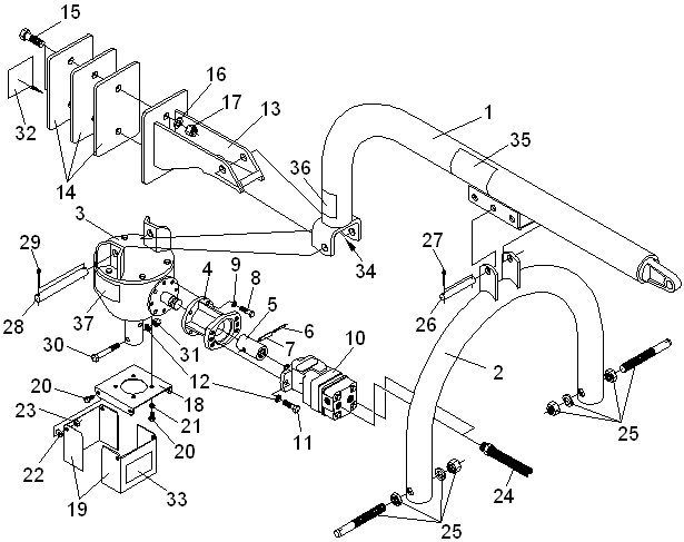

Guys looking for some input, I am looking to build a hydraulic post hole digger 3 point mounted to drill 4" holes. I am looking for a hydraulic motor that I can used to power it. I have a lot of clay soil so the motor will need to be reversible so if it hangs I can reverse it to back it out. I have a New Holland TC35a tractor that has a fronted loader that I want to take off and use the quick connects and the tractor hydraulics to power the post hole hydraulic motor on the back 3 point. I have been looking at the Surplus Center website but things get a little confusing to me when figuring RPM, Pressure, and GPM.
My tractor Hydraulic specs are as follows:
Type: open
Pressure: 2275 psi
Valve flow:9.8 gpm
I think I need a low RPM, high Torque motor correct? Like everyone else I am looking for low cost options.

"Valve flow" is not the number to use, pump flow through valve, at a desired engine rpm, is what we need.
The lower rpm (high motor displacement) the higher torque you will get...what is the desired output rpm on the motor....also, check efficiancy on gerotor motors, some are low efficient...
LSHT motor (Low Speed High Torque) is what you need

Suppose this is the closest we can get...
Sorry I am asking PIA q's, but there is a difference between pump flow capacity and desired max valve flow.....valve can let through higher flow, but at a high pressure drop (power loss)
This is a big industry problem that pump displacement and max/min rpm range is provided.It happens all the time on tractors...
If we assume 1800 rpm and a 1811 rpm (9.8gpm) and 2275 psi at PRV, that is about 13hp hydraulic power in put.
With inefficiency in pump, valve and motor, you will have about 8.5hp available on the motor shaft.....depends on the efficiency numbers and pressure loss input.
At 60 rpm as motor speed we will need a 27 cui/rev motor
and expected torque will be about 750 tf-lb
I hope someone can fill in if I stepped into any "traps"...:laughing:
This online Google spread sheet shows how i have been calculating....feel free to play with your own numbers in the spread sheet, The GREEN cells are for YOUR INPUT
Hoover the mouse cursor over cells to read my comments

This is the data from a Rhino auger. If this is about the normal rpm for augers, then find a hyd motor that will give you this rpm, with the hyd GPM, and pressure. Crunch the figures and see if the torque is enough to dig a hole.
POST HOLE DIGGER:
Auger RPM is 170.
Hitch Type - Category 1 & 2.
Gear Ratio - 3.18:1.

Tim any news on this project. I am comtemplating the same thing myself. I have had to use a pipe wrench to back a auger out of a hole one too many times. I was looking at these
Worksaver Hydraulic Post Hole Diggers
They look pretty simple to add a hydraulic motor
Looking for a low cost suggestion. My tractor is in the 9 to 11 GPM range
