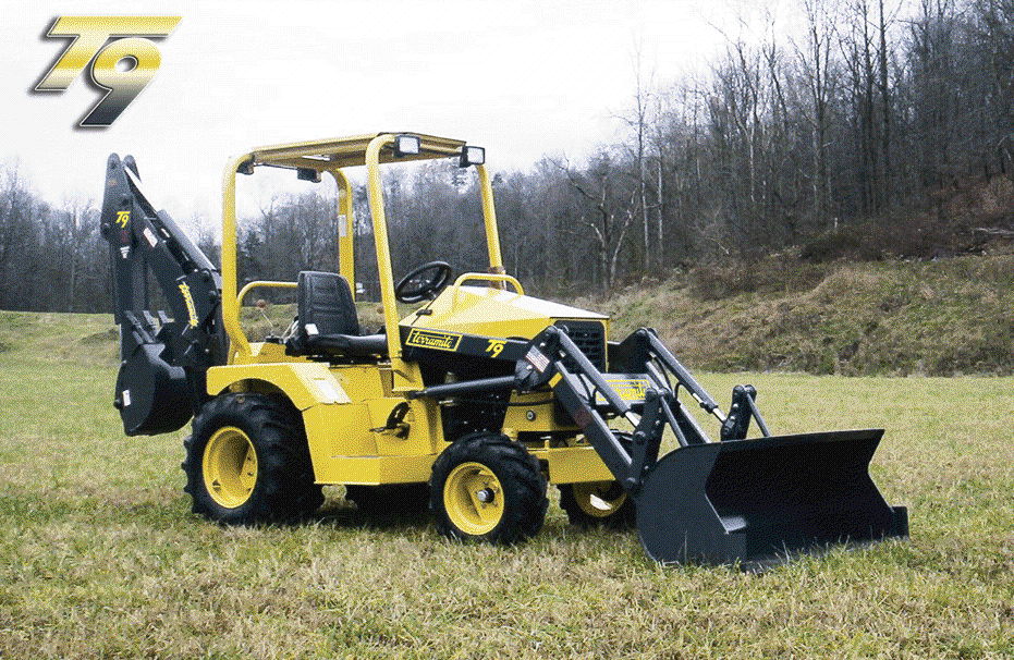

I love the idea of a compact TLB. I guess these woudl be the closest thing I've seen to one.
I think we even have a dealer not too far away for those terramites. I wonder what they cost. Maybe I better find out before I make the purchase.

Those Terramites are stout, but very slow. Lift around 2k lbs, but have a 1 speed HST & top out around 8mph tops. A friend just got an Allmand (no longer in production) but almost the same. More machine than our Kubota L3200s in some ways, but a fair bit slower & you can't remove the hoe to do tractor stuff. About twice the loader capacity to boot.
They were designed primarily for the rental market with a 20hp gas engine, although some have a small diesel in em.
A good little machine if you can deal with the slow travel speed & lack of PTO & 3pt. My friend has a L3200 & wanted a hoe & spare machine, so the lack of the 3pt wasn't a big deal. They are similar size & weight machines.

Those are pretty cool. And made in the USA. 10 GPM at 2,500 psi. Pricing is on the site as well.
http://terramite.com/
