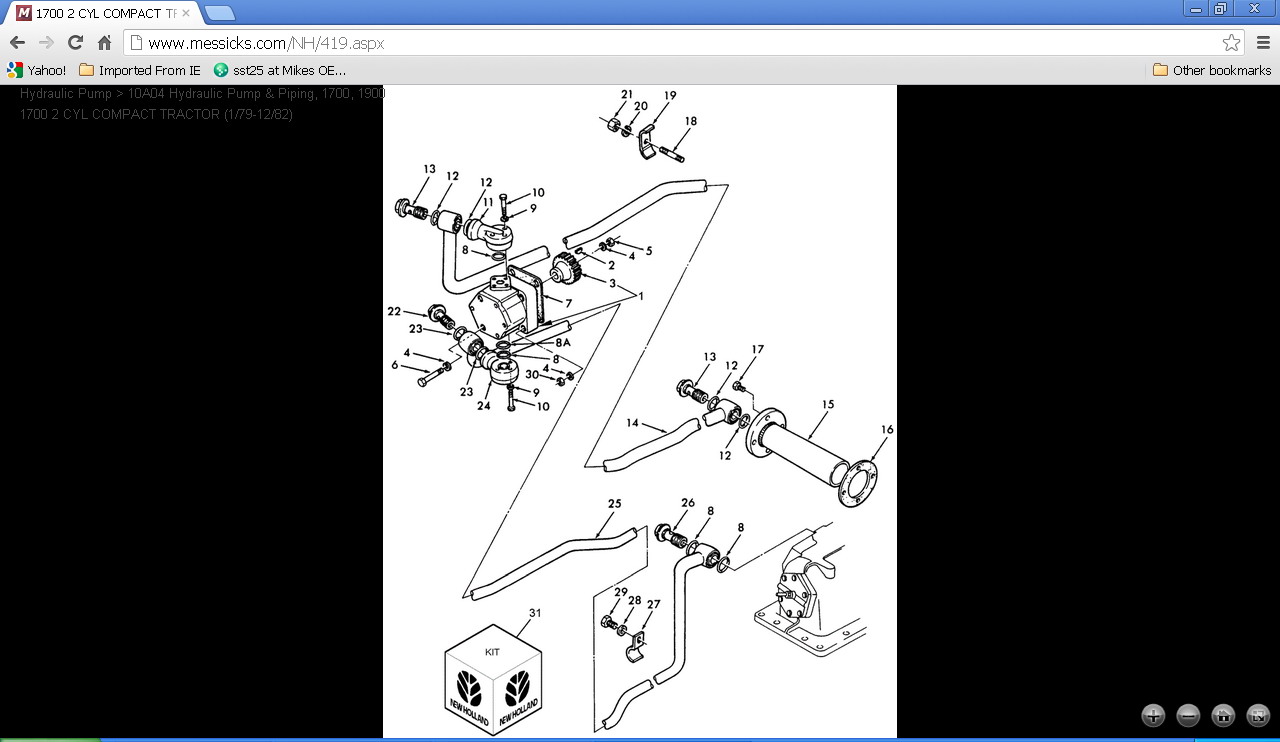

JINMAN, In your post you sent a pic of the relief valve on a F-1700, can you lead me to the hydraulic filter and suction screen on the 1700 ?
/ hydraulic power / loader #17
Mick, I think a 5" drop in an hour is VERY GOOD for a tractor as old as yours. 16" overnight is better than some almost new tractors. My 2000 model TC45D drops more than that. In operation, that kind of leak does nothing to take away from the loader's power or workability. Most loads are on the loader for no more than a minute. Even if you transport a distance and the loader sags a tiny bit, just a touch of the joystick controls puts it back to normal. There is no way I'd suggest you try to "fix" that kind of leak. If you have power or lift problems and don't have sufficient pressure, then look to something else as the problem. It's not that tiny leak.
Your tractor doesn't have a regular spin-on filter or cartridge type filter. All it has is a screen. Follow the big line off the top of the hydraulic pump. Where it goes into the transmission case on the right hand side, there is a round cover under a banjo connector. Take the banjo connector loose and remove the round cover. It is attached to the screen. Be sure and drain your hydraulic fluid before removing the banjo fitting or cover. After cleaning the screen, you can add your fluid back. Here's a diagram of the screen (item 15). The screen is on the suction side of the pump.
