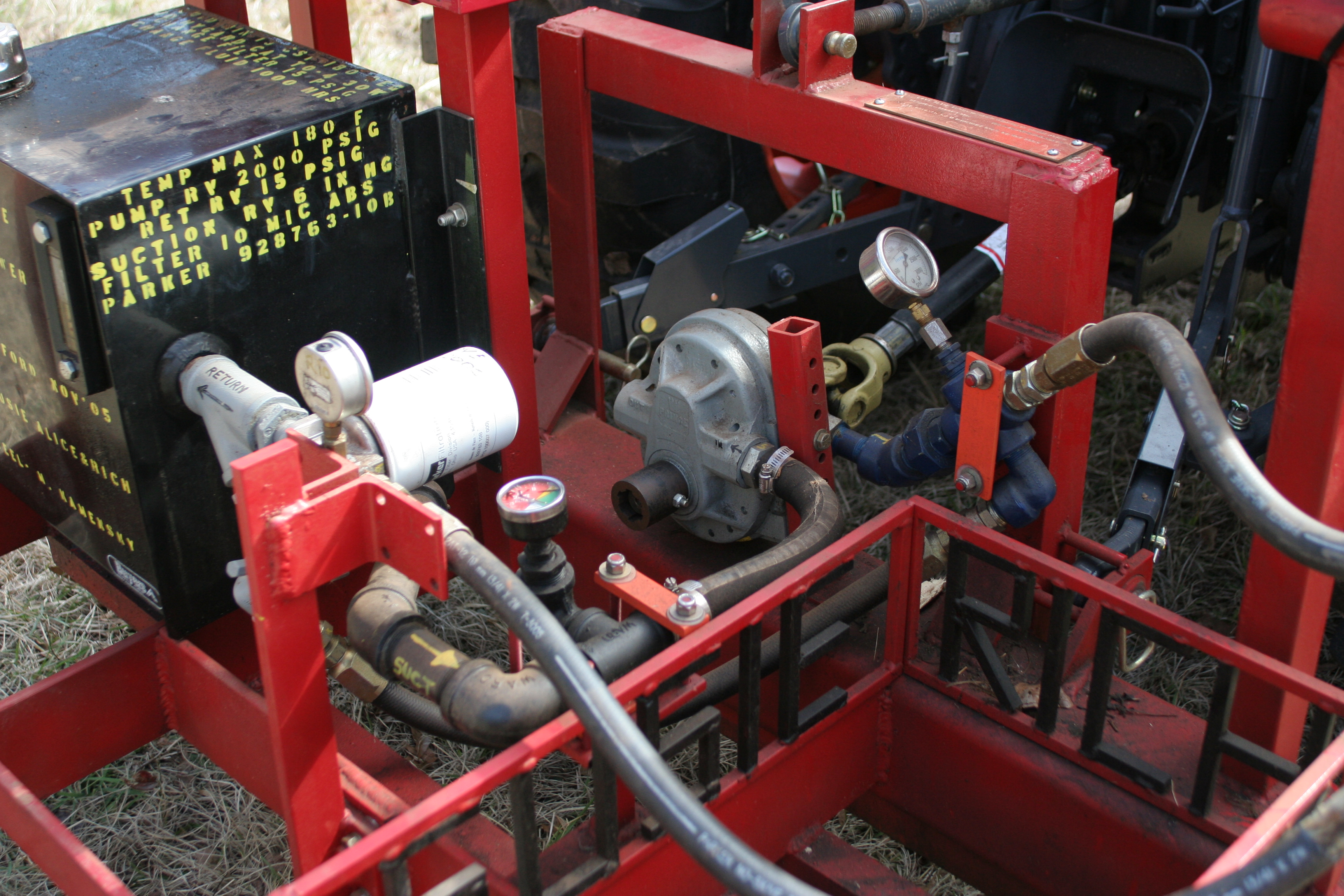

I am rusty with pictures and this homemade attachment has been extensively modified since I built it over 10 years ago, but it may give you some ideas.
It is a 48" Bush Hog Squealer on a Kubota Grand L4330. I don't know how your tractor compares, but a 60" mower would be heavier than I would like hanging way out in front like it does. The Prince 4.9 cu in/rev pump transmits about 11 gpm to the Charlynn 4.7 cu in/rev motor; the 4330 pto is about 39 hp so I am not getting nearly the full power to the mower (perhaps 14 hp at best); the motor and pump are smaller because I originally built it for a smaller tractor. It works well enough that I probably will not upgrade until something breaks since a new pump, motor, and larger lines and fittings would be about $2,000.

Oh, I see how you mounted the pump. It's a standard PTO pump, and you fixed it to the frame and used a piece of ag spline, held in place on the front by the shaft and detents. The shaft is long enough to go thru the pump and a female spline and bolt keeps the entire assembly in place.
Awesome idea.
