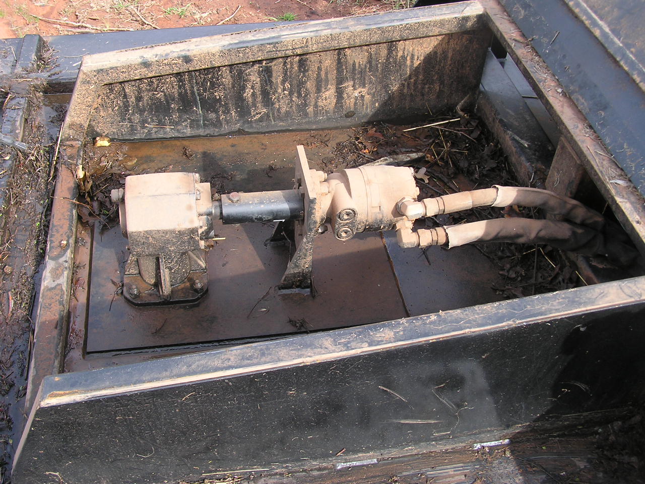

7.97 cu in CHAR-LYNN 104-1063 HYD MOTOR This is the same motor I used, except that it has a larger displacement to give roughly 540 rpm at your pump flow. It is probably overkill because it has a tapered roller bearing mounted shaft to tolerate a high side load and can work in most conditions without a separate case drain. The gear box shaft is 1 3/8" with a through hole and the motor is a 1 1/4" keyed shaft (surprise: the keyway on mine was 5/16, which is not the common 1/4 size, but is allowed by SAE). I coupled the motor to the gearbox with a chain coupling using a 1 1/4 inch bore on one sprocket and 1 3/8 bore on the other one. The 1 1/4 inch bore sprockets come only with a 1/4 inch keyway, so to match the sprocket to the motor shaft keyway I used a 1/4 key to fit the sprocket and then shimmed it with 1/16 shim stock to get a tight fit in the motor shaft keyway (It has been over 10 years with heavy use and has never given a problem.

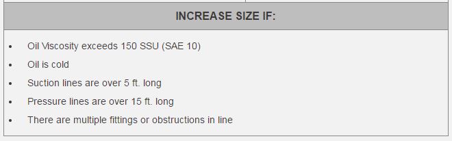

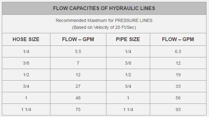

I think I figured out how I'm going to build this. I'm gonna use a Dynamic gear pump that will give me a little over 21 GPM with my HP rating. A 30 gallon tank with a 25-50 GPM cooler and 10 micron filter. All this will be on a cradle I can hook up to my 3 point. I will run hoses that can be attached to my 3rd function loader lines with quick connect when running the mower or a tree saw.
   / Hydraulic power pack build #16
Sounds good, but will your 3rd function loader lines pass 21 GPM?
And how will you handle the flow when you shut off the hydraulic motor and it becomes a pump due to the inertia of the spinning blades?
   / Hydraulic power pack build #17
How much pressure will that 21gpm pump put out? If it's the one you referenced earlier at 2,000psi, then you can expect the equivalent of 24.5hp in a perfect world with no friction loss in your lines.
In comparison to your 32 hp at the pto, you'll be losing a LOT of power. Not to mention it's going to be hydraulic hp vs mechanical hp and you will notice a huge difference.

I plan on a bypass like several others have put on their mowers that will let the fluid flow one way and the motor to slow down like normal. The lines will be 1/2" and should handle flow. Pressure will be set to 2500 and PTO output changed as of this morning to 6? HP due to upgrading machine to a 5570 Mahindra
