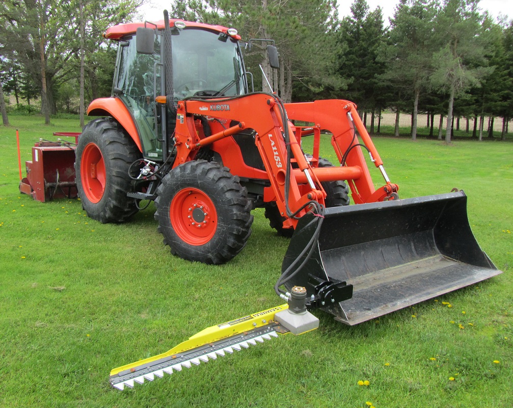

As of now I'm researching and considering a smaller hydraulic powered Sabre Samurai cutter, which in essence is a sickle bar mower designed to fit on a loader bucket on a smaller tractor. There's a good amount of info on them here but here is a link to their site for those unfamiliar.
SABRE SAMURAI CUTTER | Cutthat.com - Your Cutting Edge Technology Expert
Looks like it may solve a lot of the potential issues with some of the others mowers. It only needs 3 gpm to run properly to cut up to 1.5" material, which is about exactly as I'm looking for as it will primarily be used on grasses, weeds, and kudzu on steep slopes/roads in my mountain property/neighborhood. It may actually perform much better on kudzu as opposed to a rotary or flail mower where all the long vines wrap up on spindles and rotors very easily. The sickle bar setup will also alleviate a lot of the throw back and other safety concerns as well. I'm thinking that the low flow requirements would cancel out any overheating/taxing concerns of the hydraulics as well.
If I go this route I'd likely run it directly on the excavator bucket, only reversing the bucket on the excavator with the bucket facing out. Should give me good reach with the cutter and the entire unit only weighs 70lbs. So weight shouldn't be an issues as well. Probably ad a plate on the mounting bracket to allow to bolt the unit to bucket holes for the teeth as well.
Planning on touching base with them to run my scenario with them and get their take on it.

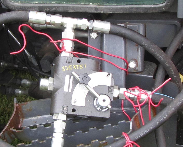

I have a Samurai Cutter which I use on my Kubota M7040.
I needed to add a pressure compensated flow control as the Kubota's GPM was too great.
You need to get the break-a-way mount or you will be frustrated by breaking bolts when you come up against something solid.
I use pieces of 1/4" plate where the Samurai mount attaches to the bucket to stiffen it up.
