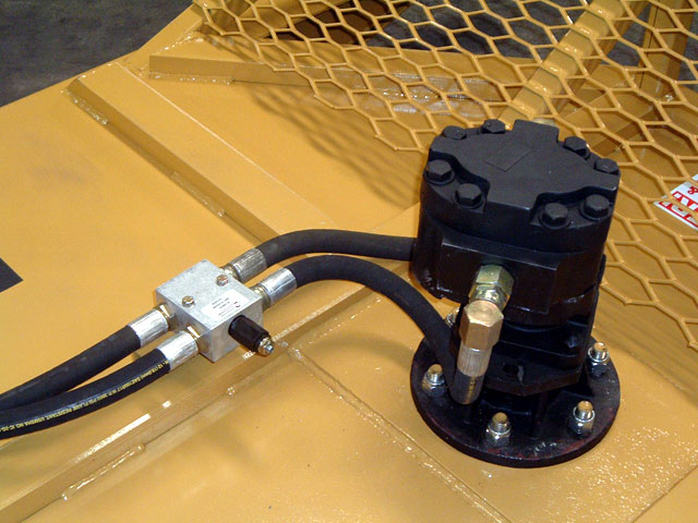

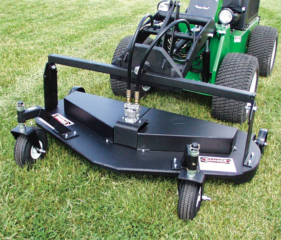

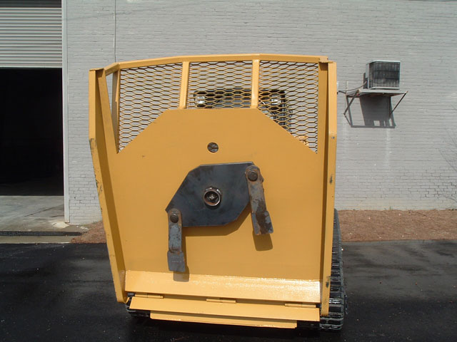

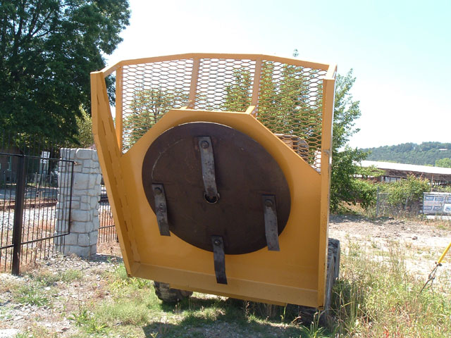

Yes, you can connect the hyd motor to the deck shaft by using a coupling, and there are different types of couplers for this. Love Joy is one type.
On a hyd driven three shaft finish deck, I think they drive the center shaft with couplers, and the outside shafts with v-belts. That is not to say that you can not have three hyd motor setup on a finish mower.
You ask about better. A belt system will take up a shock load better than direct shaft hook-up. Most hyd driven single decks are driven either directly, or through a gear box driven by a hyd motor.
I believe a single straight blade connected directly to a hyd motor is the worst setup.
Just some pictures of hyd mower decks.
