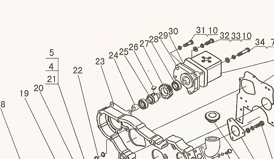

I disconnected the outlet side of the pump and started the motor and had no fluid out of the pump .

I pulled the pump off and checked the drive, it's definitely turning. With the engine off the drive gear will not turn so that rules it out. I think I may have a bad new pump.

How does the pump couple up to the drive gear?
/ Hydraulic problems #11
Like this.
/ Hydraulic problems #12
I would take pump back off and take a screwdriver and see if you can turn #25, if so all you need is #26. What does it say #24 is? Make sure the pump and drive are mating up. But kind of looks like to get a new key in the front cover has to come off.

I finally got time to work on the tractor. Does anyone have a diagram for the 284 that shows the pump drive assembly? I think my problem maybe a missing part.(the price you pay for free help)
