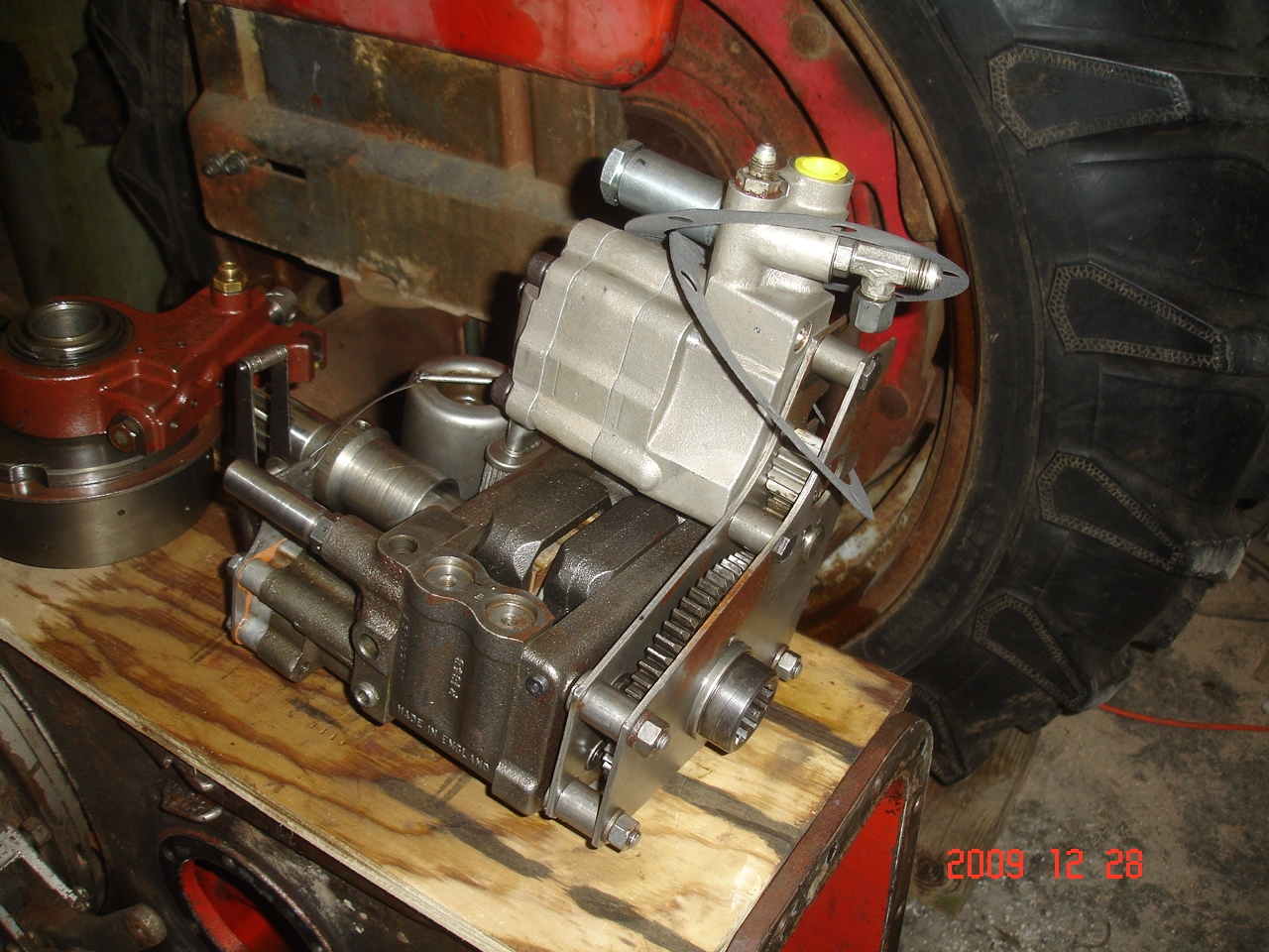

Depending on which pump they have it plumbed into, may explain why it is so slow. If off the main hyd. pump, which is for the 3 pt. lift, it may be slow, and in fact have a pulse feel to it, as it is a piston pump. You'd probably feel it more at an idle speed. Aftermarket rebuild kits can be found for around $235.00
Aftermarket Aux. hyd. pumps can be found for around $400.00. The Aux. pump provides pressure to shift the Multi-Power, and also pressure to engage the PTO, along with the remote(s).
Either way, the tractor needs to be split, to remove the pumps. They are located in the rear housing. Not a bad job, if you have the proper place, tools, and time to do it. Although, definitely have a good OEM shop manual, or reprint in hand, before starting. The I&T manuals leave a LOT out..!!
The pressure line that feeds the Multi-Power needs to be disconnected, before completely rolling the tractor apart, so as to perform the work... Lots easier to get apart, than getting it lined up, to put back together..., LOL... Maybe I just wasn't holding my mouth right.

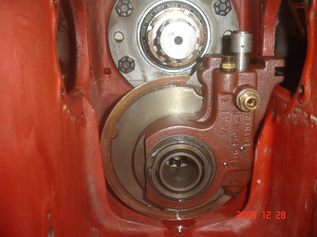

Here are a couple of pictures, of when I replaced the Aux. pump in mine. I also had the main pump rebuilt, while I had it apart. The guy where I got the parts used to be a MF dealer, but because they did not invest in a big new fancy facility, they pulled the dealership from them. None the less, he only charged me $25.00 to rebild the pump, since I got the parts from him.
The one picture is of the pumps stacked, as they are in the tractor. Main pump on bottom, Aux, on top.
The other picture, is looking at the IPTO clutch pack, which I had new disc's, and plates put in also, while apart...
