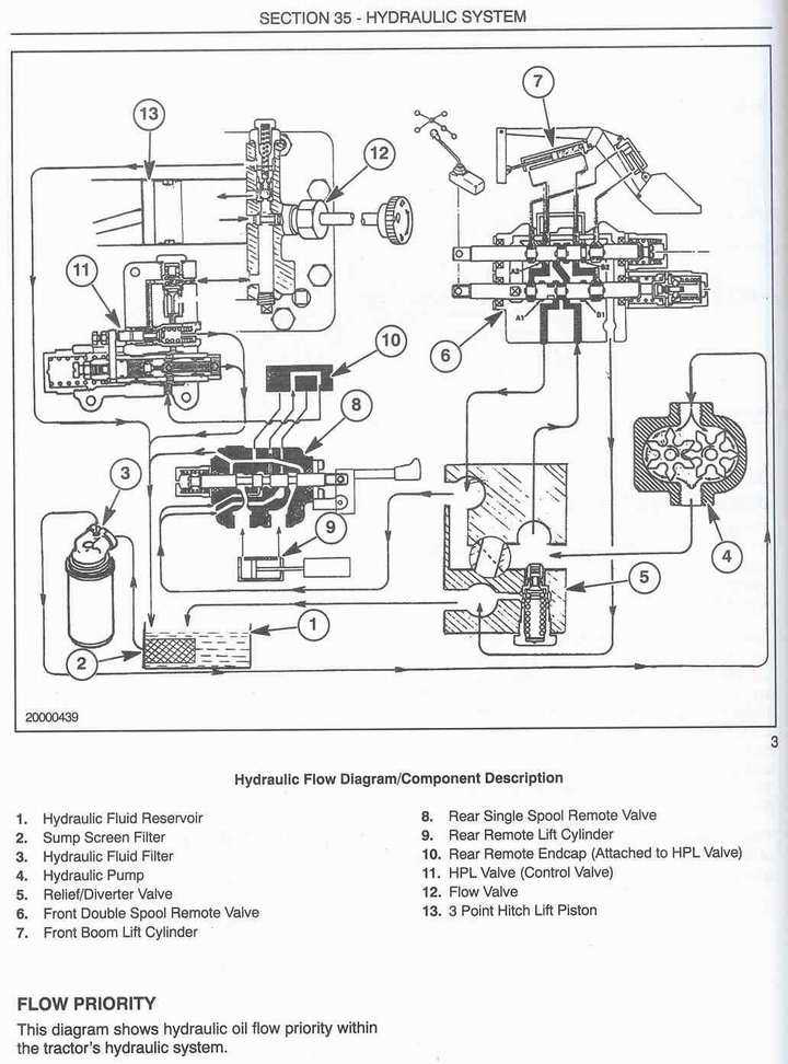

Well, I can assure you it is hydraulic fluid from the main pump. Not only is the oil not thinned at all, but it smells just like hydraulic fluid instead of engine oil. The dipstick for the hydraulic reservoir shows no fluid. It really only measures the last gallon of fluid in the reservoir. When you lose a gallon, there will be nothing on the stick.
Jbrink64, thanks for your concern and respoinse. I'm a bit fascinated and confused that you would say the gear pump shaft is only on the suction side of the pump. If you look at a cross-section of the gears in a gear pump, the bottom half is low pressure suction and the top half is high pressure outlet flow. Neither is isolated from the shaft seal. The gear pump works because more fluid is forced around the outsides of the gear than can flow back (leak) to the low pressure side from the high pressure side. Below is a flow diagram of my hydraulic system showing the pump and fluid flowing top to bottom through the pump. Also here is a link to a website discussing gear pump operation. I don't see anything that would isolate the high pressure fluid or low pressure suction from being felt by the shaft and seal. The pump is a bit of a "magic box," but gear pumps have been pumping fluids for longer than I've been around, so they must work.:thumbsup:
BTW: The reason I said, "My turn to cry," in my title is that at least three other TBNers have reported the same problem with the same symptoms during the last year to year and a half. In each case, new pump seals solved the problem. One member had to have his pump rebuilt twice when the dealer failed to replace all the seals the first time around. Once all the seals were replaced with new ones, his pump worked normally.
The fact that so many of these pumps fail this way is exactly why I caution people against shimming their relief valves for additional pressure. My pressure is exactly 2500 psi. If my pump fails with that pressure, shimming to 2700 psi is really playing Russian Roulette.:rolleyes:
