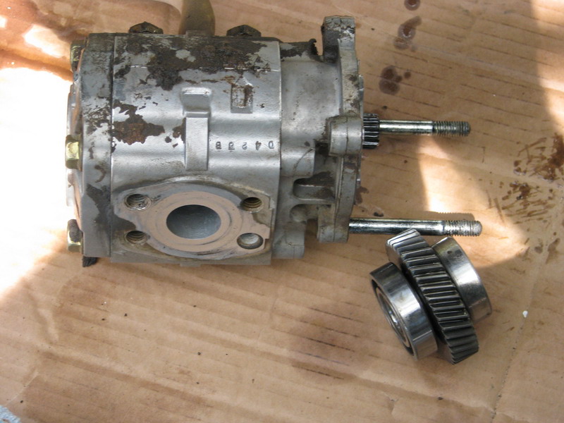

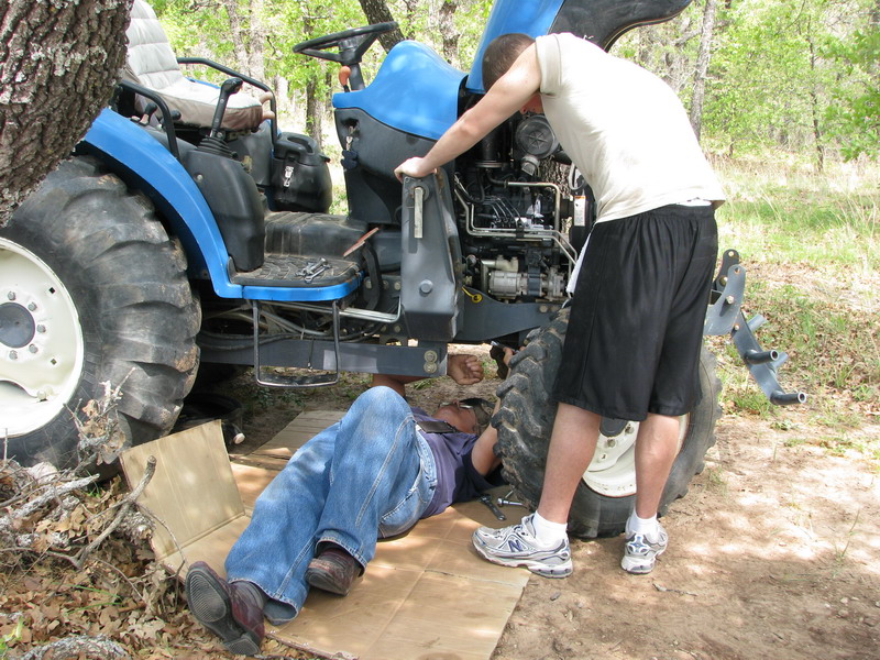

I took my hydraulic pump to my dealer this morning for a new seal kit. I removed the hydraulic pump this weekend with the help of my grandson. He was a terrific help just handing me tools and even wrenching a few bolts. The pictures attached are a photo series of the process.
Picture #1 is me under the tractor loosening the connection on the suction line so it can be rotated off the pump to allow the pump to move to the rear once it is unbolted.
Pic. #2 shows the pump with the suction side before removal and pic. #3 shows the suction pipe unbolted and rotated away from the pump.

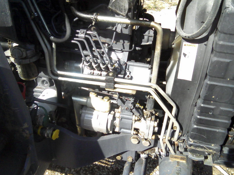

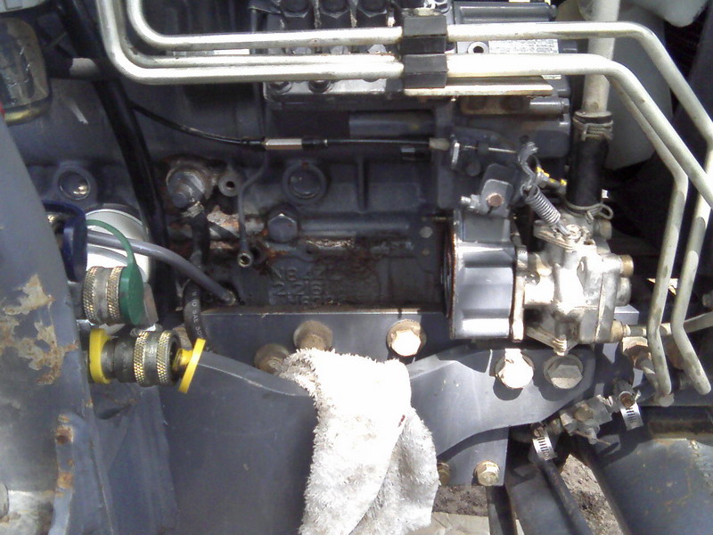

Pic. #4 shows the pump completely removed. It turns out that I could not find my univeral joint adapter for my rachet and could not get to one of the 17 mm bolts holding the high pressure line attached. I had to remove the line from the diverter block and take it off with the pump because I could only get 2 of 4 bolts out of the pump. I also had to remove a bolt in the banjo fitting shown in picture #4 because the pump would not come out without hitting the bolt. The tubing and banjo bolt is in the camshaft oil drain line returning to the engine oil pan.

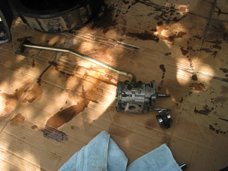

Pic. #5 shows the pump removed with the drive gear attached and both bearings. Pic. #6 shows the bearings and drive gear removed from the pump.
Pic. #7 shows the whole pump and pressure tube still attached.

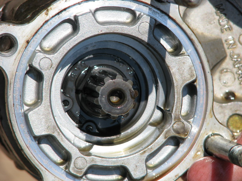

Pic. #8 shows the drive shaft into the pump and the external seal. You can see a piece of the seal all blown out at the 10 o'clock position. This seal blowing is a result of the inner seal blowing. Both seals must be replaced for a successful repair.
