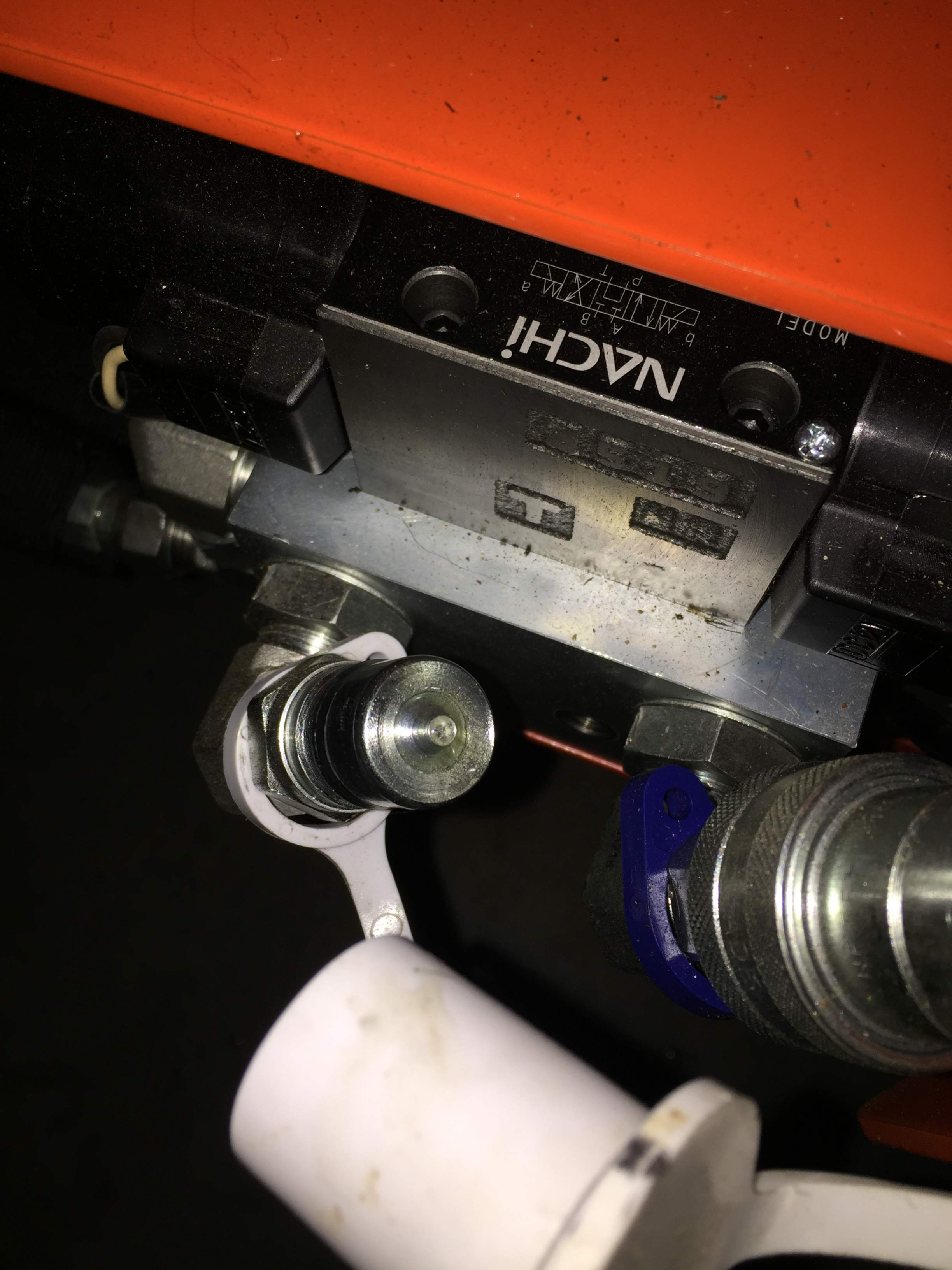

On the teflon tape, I hear you. I think they put that crap all around the new 3rd function valve. I guess that's what you get when you spend $950?
At the 3rd valve, the two QA couplers on the lines are female. On the valve block are two male fittings. I take it these are closed when disconnected otherwise 3000PSI of fluid would be spewing everywhere? They're identical to the 4 fittings for the loader bucket up down/curl hydraulics. The one time I used my tractor without the loader, I just capped these with rubber boots with no issues. They are tucked away so no worries.
Here's a picture of one of the QA male fittings on the valve.
It looks like ISO_7241 series B
ISO 7241-B Quick Disconnect Nipple
Even with rubber boots on the ends when I don't have the implement on the loader, I would think these are more easily damaged than female?
Either way, I need to be a little careful not to damage these. Maybe add a female adapter that is hard capped on the other end. Seems to me that would be more rugged and less prone to abuse

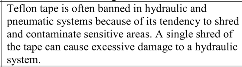

Npt requires sealant.
I understand that, but why use it then if its unsuitable?
Jic and o-ring fittings do not.
Nor does BSP, metric, ORFS or any other type I have encountered. I would consider it a requirement for high-pressure connections not to rely on sealant...

I am not saying not to use sealant. Sealant IS required for NPT. Just not the tape kind. Patricals/shreds of tape that find its way into a hydraulic system will mess up valves. Liquids and pastes won't.

1. NPT CAN be used for hydraulics
2. NPT requires sealant.
3. There are 3 common types. Liquid (like loctite 545), Paste (like the white PTFE paste), and Teflon tape.
4. Dont use tape on hydraulics cause shards of it can mess up valves.
