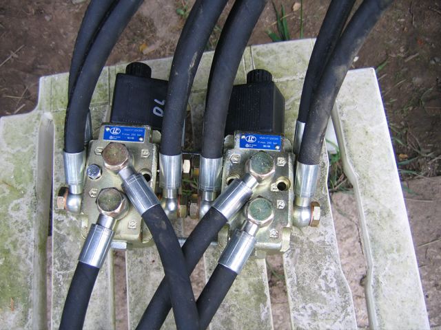

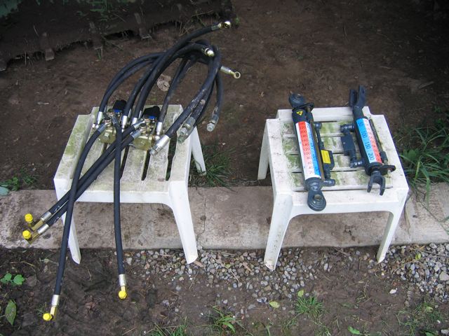

Can you explain this valve and how it may be used? Never saw one like this before. He has a JD2210 and I'm not sure how the IE system works with the JD, wonder if this valve could be adapted to my NH?
I see the four hoses for the cylinders, but what are all of the other ones?
I'd really like to buy his set up but I'm not sure about this valve...

There should be 7 connections on the valve for 7 hoses in total. 4 for the work ports, 1 for the inlet, 1 for the power beyond outlet and 1 for the return to tank outlet. The picture is not al that clear so I can't actually see what is what.
If it is configured as I just said then it will work.

Try this pic. I see at least 10-12 lines off this thing. It is electrically controlled somehow?
