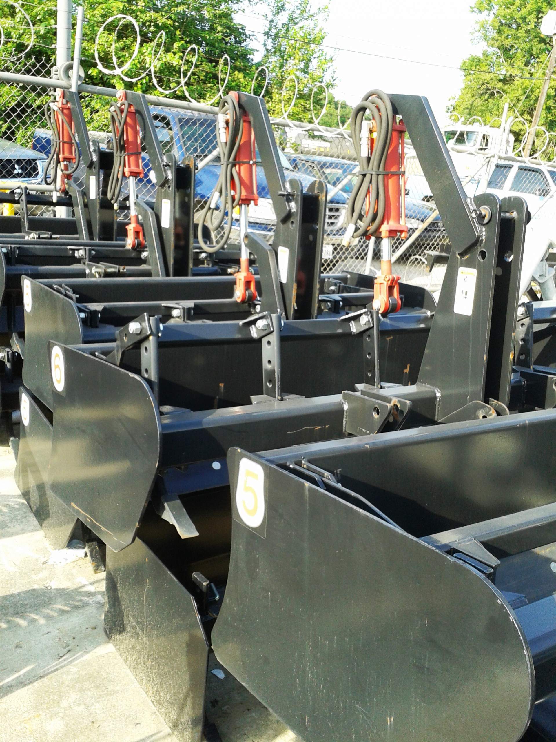

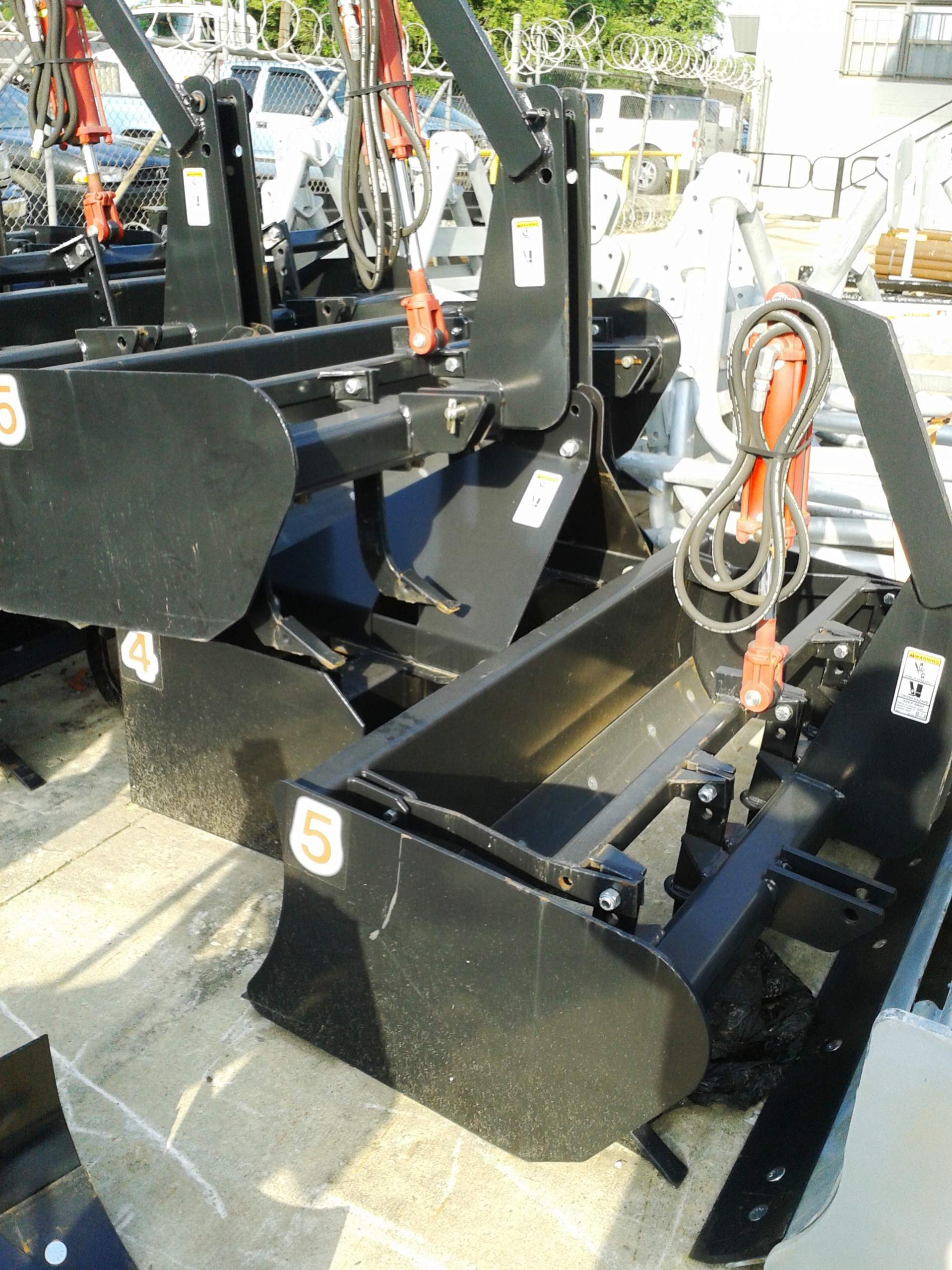

Travis, I thought you and Ted may be interested in this variant design by Modern Ag Products. Instead of rotating the scarifiers, Modern pulls them straight up. The scarifiers are pulled straight up. In the following two photos you can see how each scarifier is held in a captured slot.
BTW, don't make your scarifiers too strong as you want them to break before bending or breaking anything else in order to be a sacrificial part in order to save the box scraper frame as well as the three point on the tractor itself.

One thing I don't like about that design is that when the rippers are down, the hydraulic cylinder is extended. That means the forces that the ground is placing on the rippers (constantly trying to push them up) is being exerted on the fully extended cylinder.

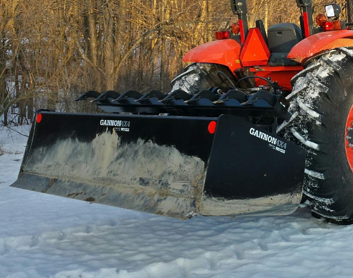

The Gannon/Woods design, on the other hand, has the cylinder fully closed when the rippers are down. I don't have any data (or even the technical knowledge) to prove it, but the Gannon/Woods design just seems to be less stressful on the hydraulic cylinder than the Modern Ag design.

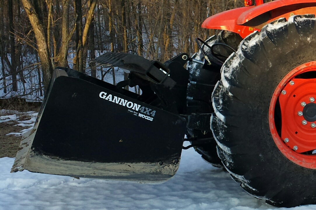

Gannon also utilizes a 4 bar linkage to its advantage once its down and locked in place its not going anywhere and puts very little load into the cylinder.
Although looking at how this design operates there should not be substantial vertical load going onto the cylinder if anything i would suspect the cylinder would be in tension under when the scarfiers are down as the they are angled to pull into the dirt rather than push up and float.
I wonder with this design when your not using them they are they prone to clogging or getting in the way? On my gannon they are completely out if the way when retracted. This is a question as ive never used this style?

I'm not sure about that long piece of flat strap holding the end of the cylinder. Seems like there would be a better and more secure way of mounting the cylinder. I'm sure it works just fine but it could be improved upon IMO.

There is a reason that the Gannon's have not really changed for decades and are used on about every commercial machine that makes use of a box blade. There are some copycats, but at the end of the day, Gannon is still the unit to have.

I'm told that Ted likes the FFC design, but I've never seen an FFC industrial box scrapper with hydraulic scarifiers. To my eye, the Gannon design is the best as it leaves the box wide open. EA extended the box fore and aft length on their newest design to help keep from clogging.
