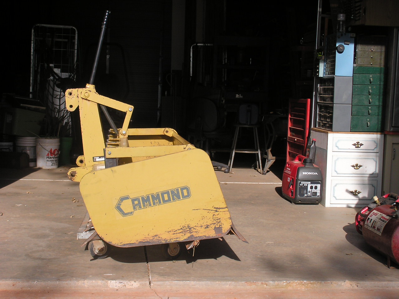

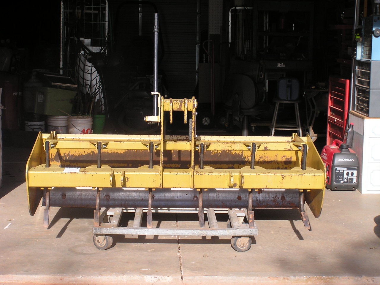

Just to clarify my previous post, when the rippers were rotated up, they were still below the top of the box. So when filled, the wet clay would pack around and over the rippers. When you lifted the BB all of the clay would stay in the BB. Even what was under the rippers!
This is a better design, for the rotating style, the rippers come up higher, out of the box.
I appreciate everyones input.
I don't know which style is strongest, but I like the vertical design on my Cammond. :thumbsup:

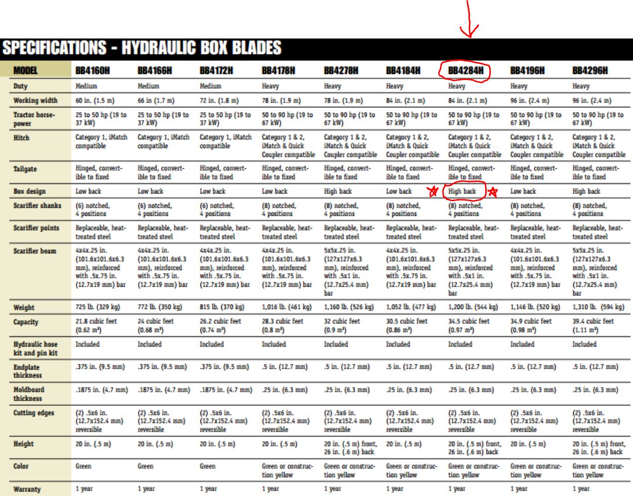

I must not be using the tractorbynet App right. I thought I uploaded a photo properly, but I guess not. Anyway, here are two photos of that Frontier BB4284H.
Questions:
1) Does anybody know if this is the high profile or low profile version of Gannon's blade?
2) does anybody know if this is a 2x4 or 4x4 version of Gannon's blade?
3) Any pushback against using this blade with a SpeeCo Cat 2 quick hitch on my 60hp Kioti which is balasted to about 7800 pounds with the loader attached and is 78" wide at the rear wheels?

Answers:
1) It is a High Back.
2) I don't know what 2x4 or 4x4 means.
3) Read the specs and decide if it will hold up OK.
http://www.deere.com/en_US/docs/non_current/tldsfe37514_41_42series_bb_lit.pdf
Frontier Implements: Frontier Implements | John Deere US

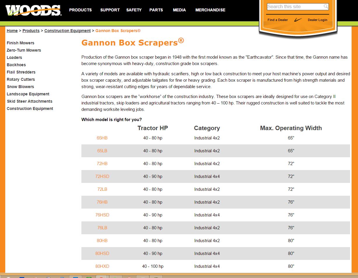

Does anybody know if a standard SpeeCo Cat 2 (which one must shim out Cat2 to Cat3 spacers on the bottom) the same as John Deere's iMatch or Quick coupler?
My Quick Hitch: SpeeCo Category 2 Tractor Quick Hitch (Type: Standard) at Blain's Farm & Fleet
It looks like Gannon did make a HD4284HB blade. Big Iron
Looks like it was marketed as a 4x2 version.
And it appears to have a different tailgate than the Frontier blade.
And it looks like the Cat 1 and Cat 2 mounts are different too.
